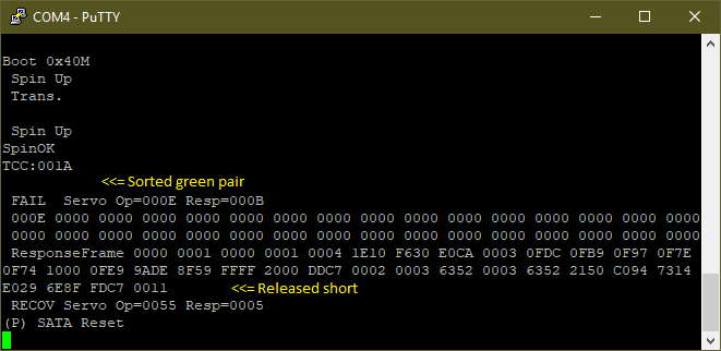

Sorry, I should have mentioned that I blocked off the head connector.
Here is a boot up with the heads being reachable to the control board.
Boot 0x40M
Spin Up
Trans.
Spin Up
SpinOK
TCC:0014
(P) SATA Reset
File comment: SATA Reset

I should also mention that the drive will not respond to CTRL+Z or any other keyboard commands when it reaches this point.

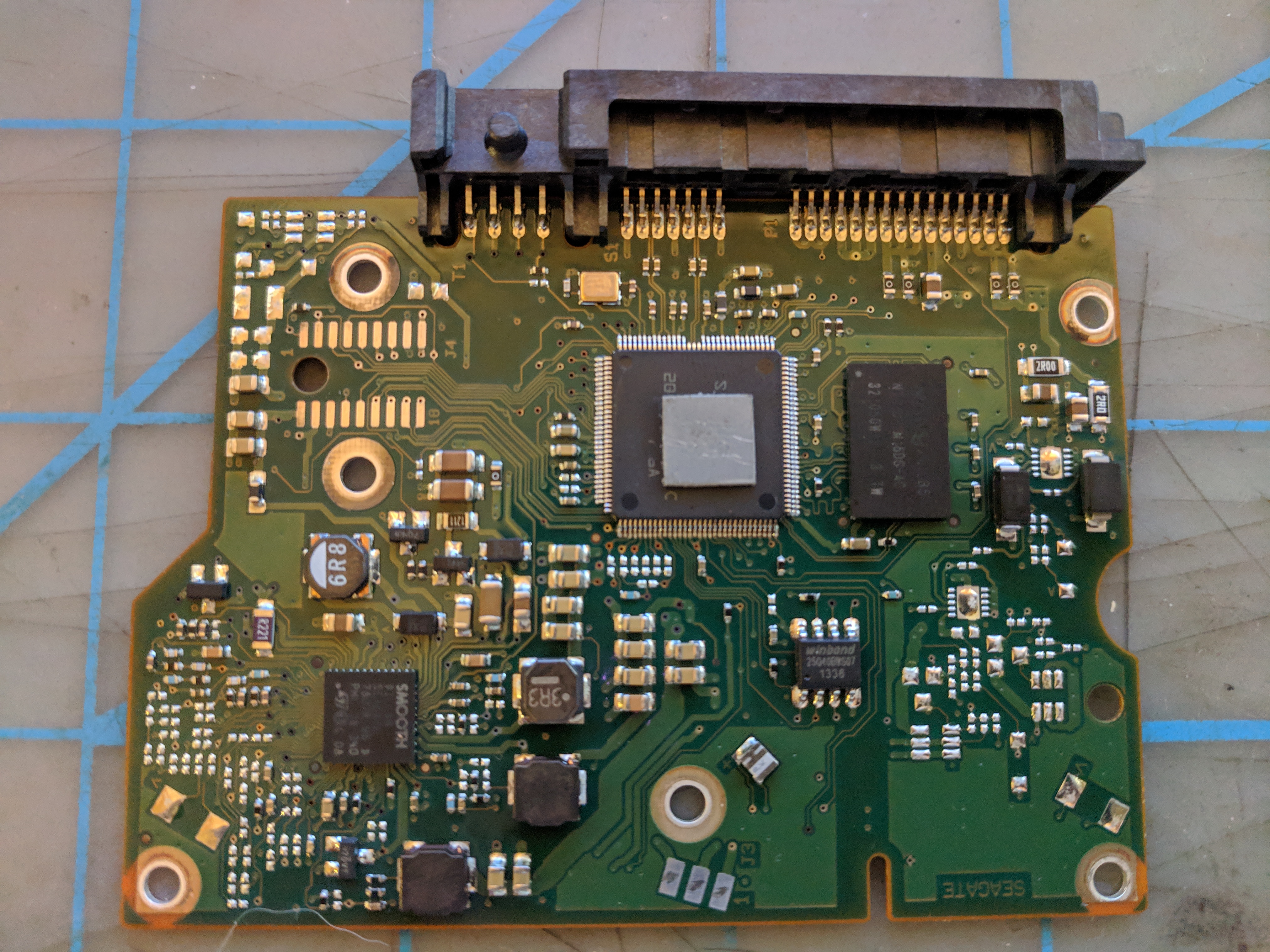

Short the read channel right before the "(P) SATA Reset" message comes on the terminal window. Take a picture of the PCB board (head/preamplifter contact pins and processor should be clearly visible) and upload it here so we can tell you which pins have to be shorted.

Do I need to short these pins with the heads or main motor disconnected?
My customer has already written off the data that was not recovered from this drive. I am more or less taking this on out of curiosity so I can learn more.
Here is the component side of the control board.

You should fully understand exactly WHAT you do. Think thrice before taking any action.
You need to short those pins with the heads and motor connected. The read channel pins circled with either a red circle, or green one. Just don't ask us which ones, google "Differential Pairs".

Shorting the red pair produced no change.
Shorting the green pair produced the following.
File comment: Green pair
The heads were making a horrible noise until I removed the short, which produced the second to last line, which was then immediately followed by the last line.
How long should I hold the short?
What should occur if I have done this correctly?

You never mentioned what firmware version you are messing with. That means you are still far away from understanding the basic principles. For example, ER-drives are firmware locked so it's not possible to work on such drives unless you have something like PC3K.
Read the HDD Oracle forum http://www.hddoracle.com
Keep in mind, the read chanel needs to be short with something really SHORT (tweezers etc are not an option).
In my own experience it depends on different factors and is all about timing and practice. There is no simple step-by-step guide or set of best practices that will lead you to "guaranteed" success.
