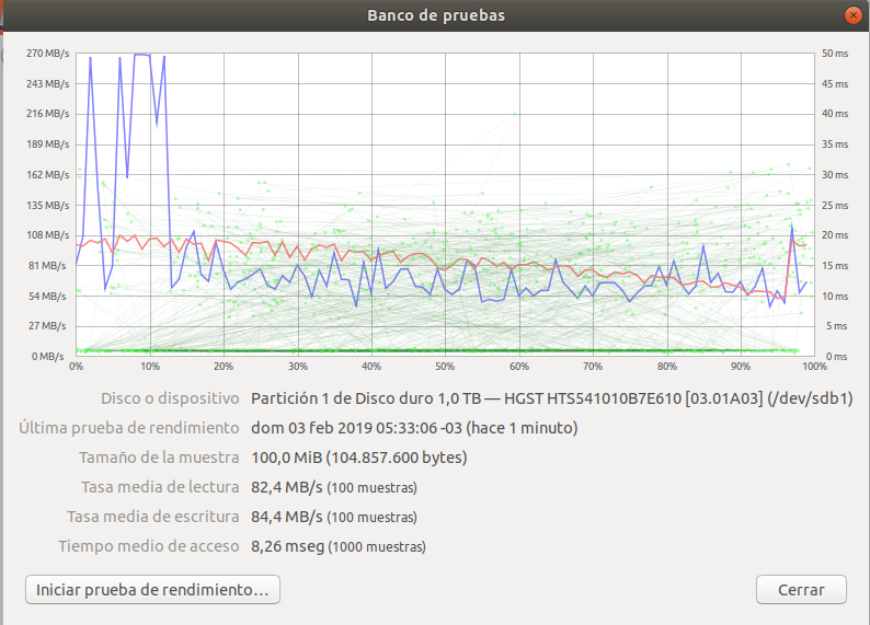

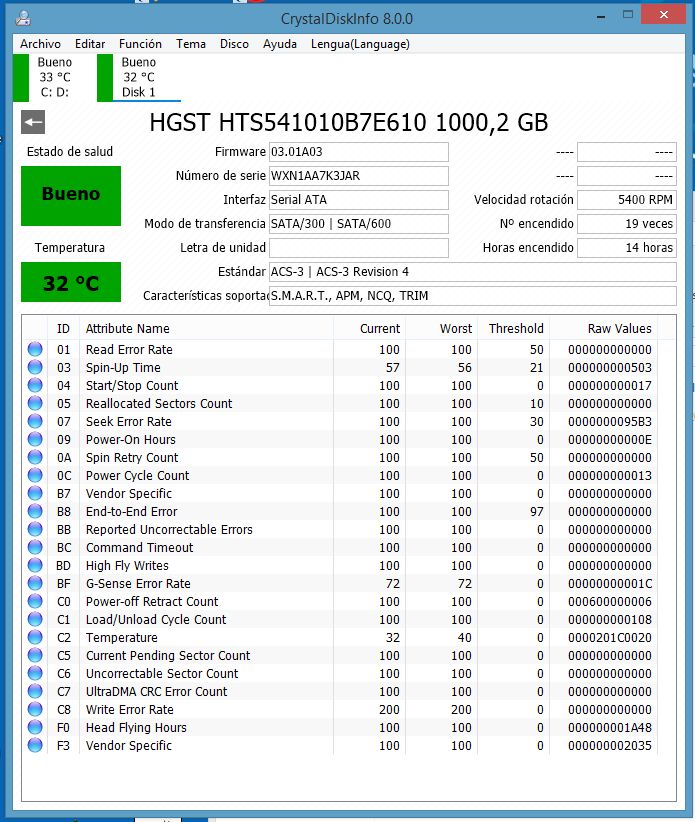

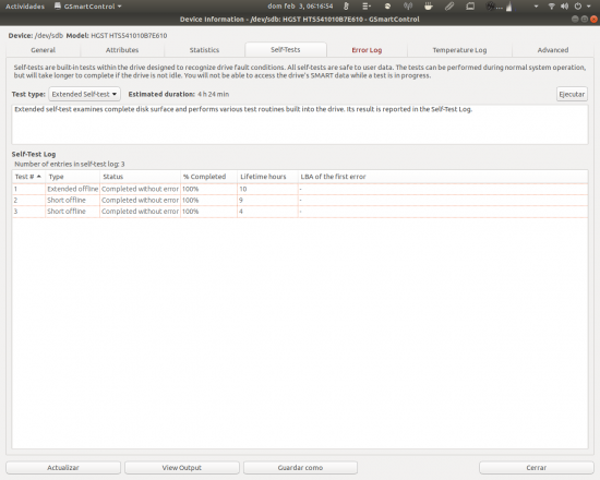

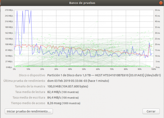

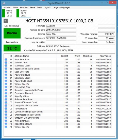

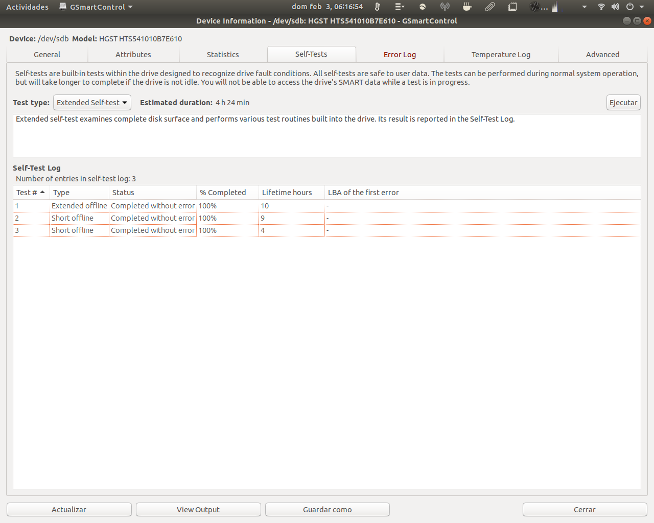

Hi. I'm new in this forum. I want to ask you about a disk that I have purchased. The disk was taken from a new notebook to which an SSD was placed.
It is a guy who is dedicated to selling notebooks, which changes the disk that comes by default by an SSD disk at the request of customers.
The disk is a 1[TB] HGST Z5K1 (HTS541010B7E610). Attached below the gSmartControl LOG that I did as soon as I received it:

I have also made performance measurements with the Ubuntu Disks tool (Some screeshots are in Spanish, sorry :)),
It also passes correctly to SMART tests.

On the other hand, the RAW value of the variable Seek_Error_Rate, which changes all the time when operations are performed on the disk. The value changes increasing until it reaches a value between 65000 and 66000 (I assume that it must be 65535, for a 16 bit register), after which it restarts to zero and starts growing again. I attached a video conformed with screenshots of the moment it is restarted. The mentioned thing is observed while updating the SMART values ​​in gSmartControl (I was making copies of files on the disk at the same time). Screenshots were taken approximately every two seconds. Can you assume that the RAW value is actually an error counter? Since the normalized values ​​have not changed after copying approximately 500GB of junk files to disk.

When there is no operation on the disk the value of Seek_Error_Rate increases very slowly (this was what worried me originally). As mentioned before, when performing operations on the disk, the value is triggered and begins to rise rapidly until reaching the mentioned threshold in which it is restarted, but the normalized value has not changed after 500 Gb of file copy.
I use Ubuntu 18.04 as my main system, but I have a partition with Windows 10, on which I have run CrystalDiskInfo.This is a capture of the SMART data represented on a hexadecimal basis.
I still have seven days to return the disk without costs, and I try to determine if the disk has problems. Is it possible that this behavior is normal?
Thank you very much for your answers.

ISTM that your drive is a rebadged WD model. I haven't noticed that WD's new Seek Error Rate attributes have changed in the way that you have discovered, but you seem to have interpreted them correctly. FWIW, Seagate's drives count up to 250 million seeks before rolling over. ISTM that there is nothing to be concerned about.
