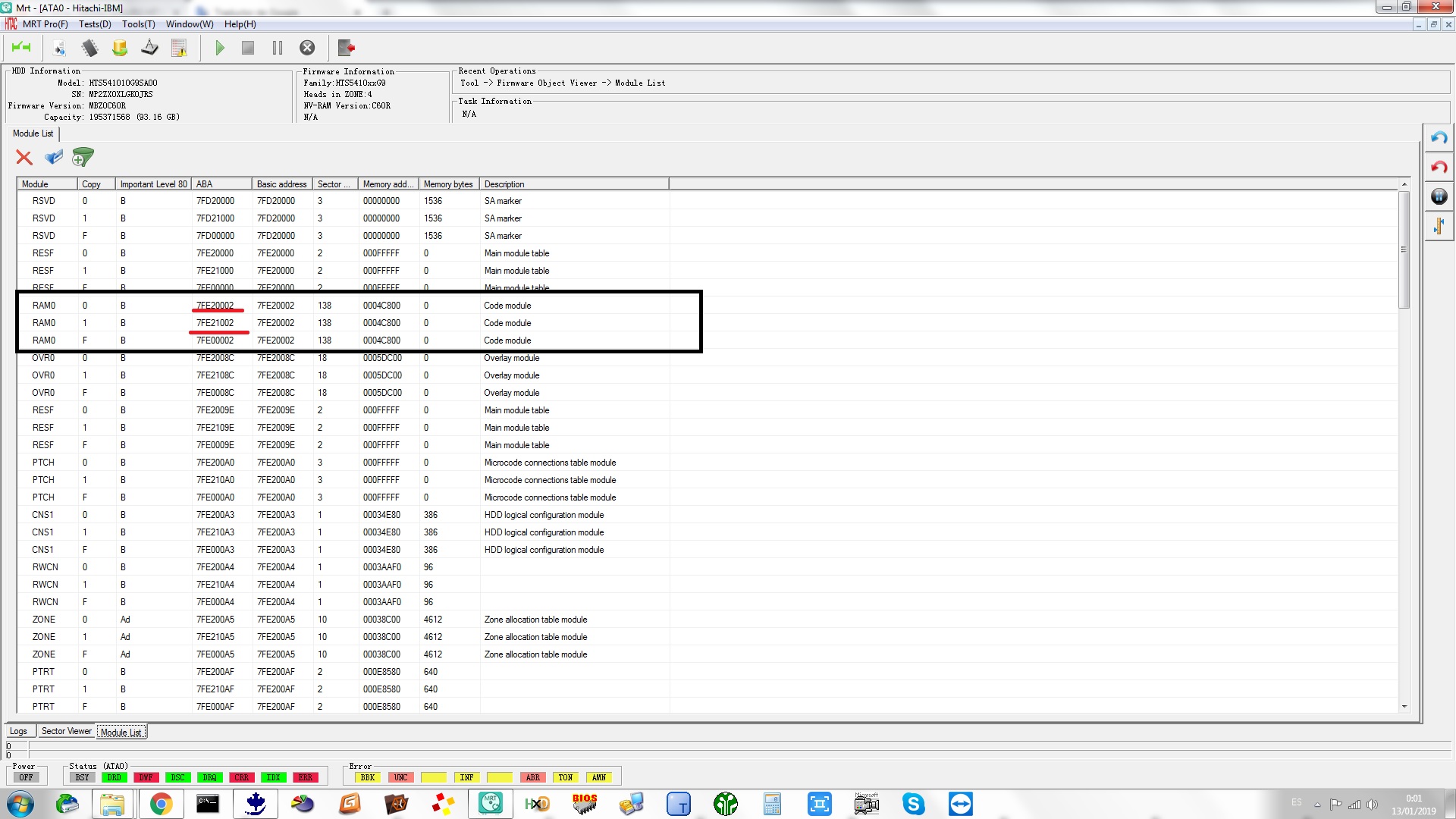

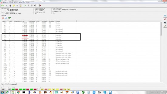

Right now I'm going to try another hitachi HDD "HTS541010G9SA00". If I modify the OVR0 of copy 1 the HDD continues to work, but if I modify only the copy 0 is when I have the problem, I will leave the copy 1 intact as well changing the head map I have some possibility.
I'm going to start with other important modules, but I'm not going to touch the microcode ones.
Before doing anything I made a copya of the modules in RAM and then I started the HDD in SAFE MODE mode, I loaded the LDR and then I loaded all the modules in RAM, but it gave me error in many modules and does not identify the HDD
 Post subject: Re: SAFE MODE HITACHI???
PostPosted: January 12th, 2019, 19:13
Posts: 474
Location: spain
I get to boot the HDD with copy 1 if the copy 0 is defective. It's the only thing I get with MRTLAB at the moment.
I can not fix the HDD at the moment but I can access the data.
I have added to the SA address a 0x1000 offset and it looks like it uses the ABA address to read the modules and it seems like a patch works.
For today I abandon, tomorrow I will see the results and continue with the MRTLAB.
Greetings.

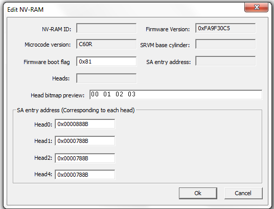

How to proceed to recover the firmware of the SA in HITACHI-IBM with the MRTLAB:
1. The PCB is isolated.
2. The SA entries in the NVRAM are changed, so that it does not read copies 0 and 1 assuming the worst case that the 2 are broken. The SA entry can be decremented by 1.
3. The HDD is placed with the PCB connected to the HDA.
4. We enter SAFE MODE (it seems to me that it is not necessary).
5. Load the LDR so that the MRTLAB knows where to write the modules.
6. The correct modules are recorded.
The HDD does not find copies 0 and 1 load the copy F, and with it the code needed to write the modules. It's the conclusion I've reached but I'm not sure.
I think there must be some bridge configuration in PCB or modification in NVRAM, so that the HDD does not read copies 0 and 1 and directly read the copy F, I would be the correct way to enter safe mode to repair the firmware.
I tried the "boot flag" of the NVRAM, but it did not work for me.

I pass the modified NVRAM.
NVRAM.rar [411 Bytes]
Downloaded 424 times
