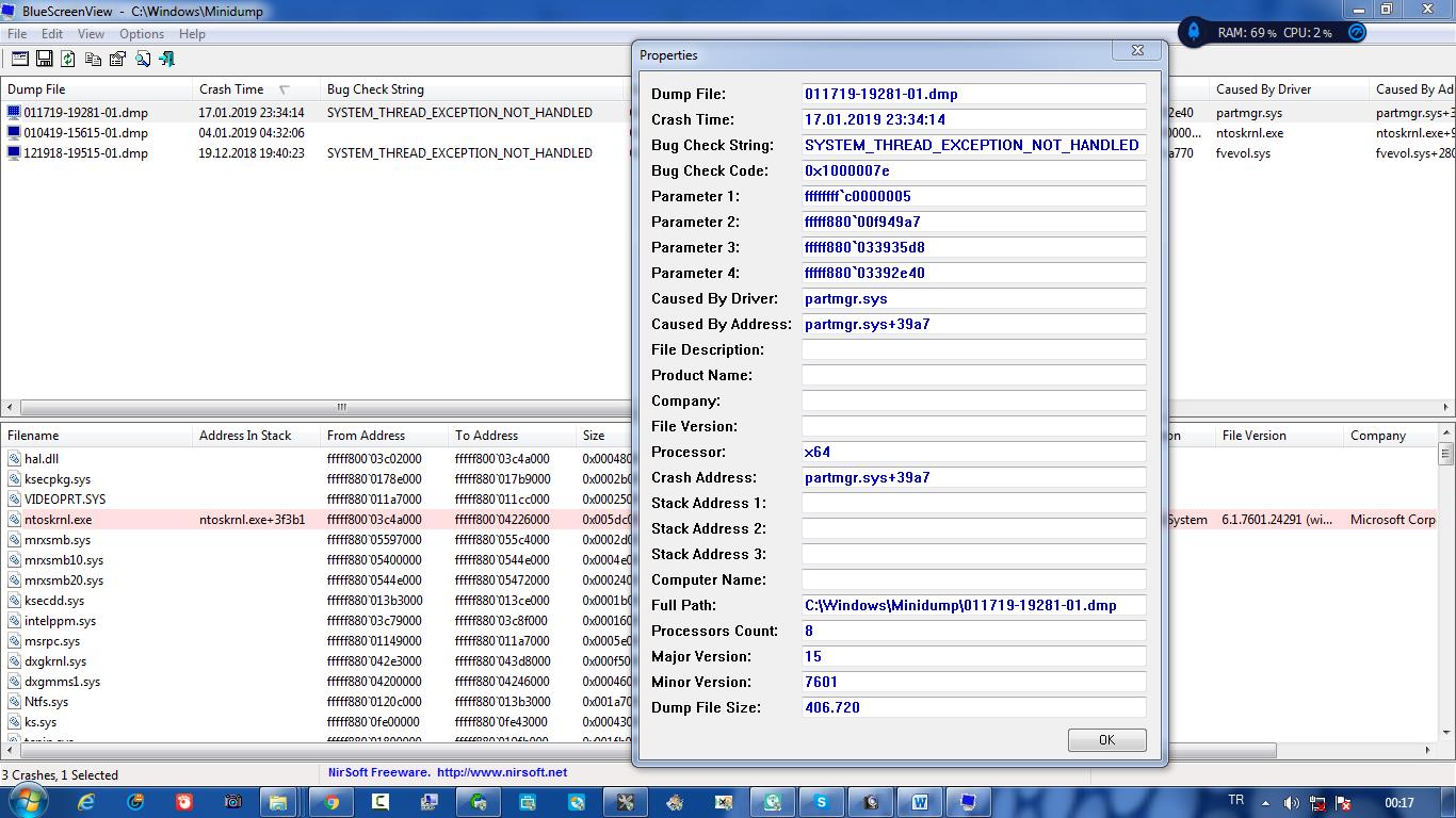

I had 2 HDD
1st HDD gave blue screen in windows when trying to do something with it . don't remember. . I cloned that hdd to good one . I don't remember which way. I guess cloned over MRT. After then connected cloned good disk to computer over windows . Again blue screen. Guessed some logical problem. It was just a try for that kind of case. And deleted that good hdd . Works normal.
2nd HDD same. Blue screen in windows. Also I connected over MRT. And blue screen with MRT.
Never connected this hdd again. It's waiting.
Any suggestion for 2 case?

Try to use MRT DE to mount the file system and copy the files you need ? Does it hang and cause blue screen as well ?
Maybe 1st hdd . But second one had blue screen when power on in MRT.
And now I had 3th same case. 1 TB WD10EZEX.
Again blue screen in windows. This 3 hdd for testing for donor . All not a real recovery case.
BUT
MRT was extracting data from a real recovery job. . . :oops: :oops: :oops: interrupted my real recovery ..... (
Anyway. I lost only 30 mins. Not important.

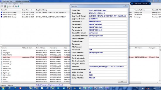

Here is last blue screen records.

Tested WD10EZEX 1 TB
MRT working normal in WD section. I saw modules.
Tested logic scan 10 second. started full green .
After than I tried mount disk readonly.
Blue screen again.
I have recorded it by phone. But video not good. I will record again
So it's look like file system corruption. Still strange situation. I ll post blue screen log file. Maybe someone can tell something about that.
