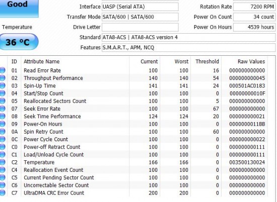

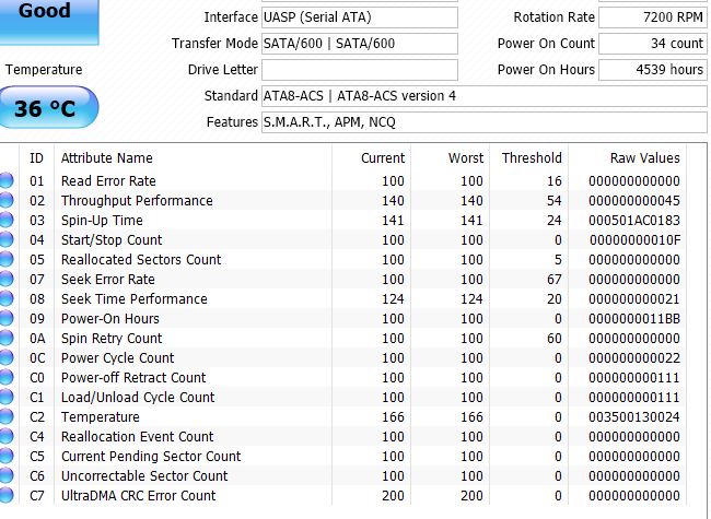

Can you show us a SMART report with CrystalDiskInfo?

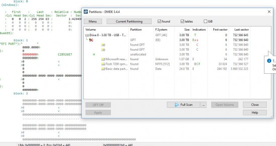

Can you show us the partitions window in DMDE?

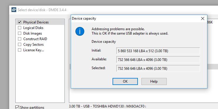

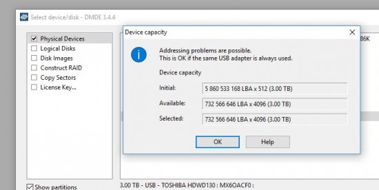

So was this running as JBOD, or did you make the disks into a RAID? From the product details, it looks like it should have been showing each disk separately to the computer. If it was JBOD with no RAID, and you can access the data on 3 of the disks but not the 4th, then that disk could be failing (see @fzabkar's post, the part about showing SMART info).
It is also possible that the partition data on that disk somehow got corrupted when the failure happened (see @fzabkar's post, the part about showing partition info).
About the only other possibility is the enclosure was using that disk as having a 4096 byte sector size, but was using the other disks with a 512 byte sector size. It would seem odd that it would only do that with the one drive and not the others, but it is a possibility to look for. Again, see @fzabkar's post, the part about showing partition info with DMDE for this possibility.

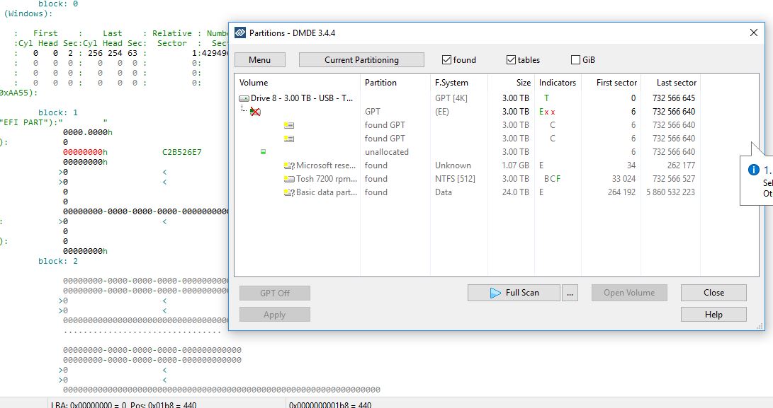

SMART report (looks good) and the DMDE drive info. Let me know if these DMDE windows were the ones that you were looking for.

It was working fine at the 3tb capacity until the night it failed. In theory it supported up to 3tb capacities, 12tb total array size.
DMDE is astonishingly better than the other tools as far as information provided. I'm able to view the entire directory structure within the volume, including all the files. So it seems that one option is just to recover all the files to another drive, reformat this one, and copy back over. Looking through the DMDE manual I can tell the little red x's means something damaged in the GPT, but having trouble understanding exactly what is damaged. Since the x's aren't uniquely formatted, I assume this is one of those if you had any idea what you're doing you'd know that the order they are in tell you what they are. What steps could be taken to potentially fix it, if that's a reasonably safe option vs copying and recopying?

Alright, all data copied with DMDE. Any suggestions on the best way to approach repairing the partition?
