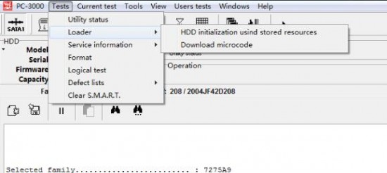

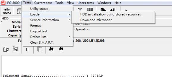

Joined: December 1st, 2018, 0:18
Posts: 15
Location: Japan
drHDD wrote:
drHDD wrote:
I don't see why you have difficulties here. PC3k can do loaders. Just ask somebody to create loader from drive with same firmware like your drive has. Upload loader to drive and write original modules back.
Ups, I forgot - pc3k most likely encrypt their loaders. They usually do it for that kind of stuff.
Would you please point out for me where is button I can do LOADER by using PC3000?
