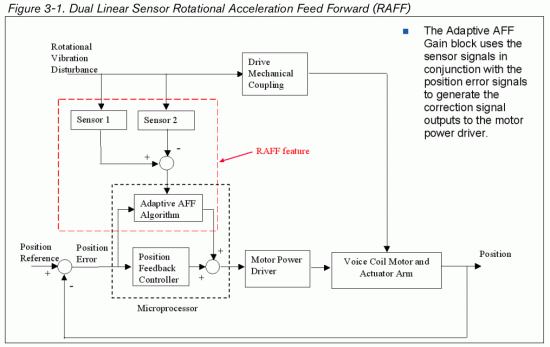

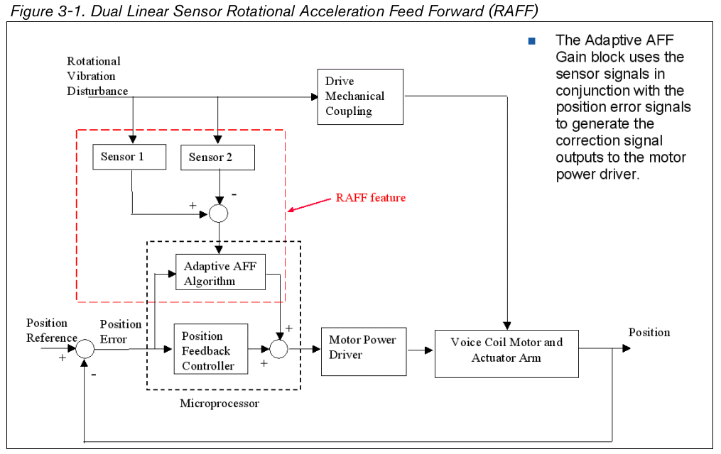

Eccentricity in hard drives is more commonly referred to as "repeatable runout" (RRO). This can be due to tolerances in the track writing process. When the head tries to follow a track that is off-centre, the head wobbles.
"Non-repeatable runout" (NRRO) is the type of wobble induced by vibration in the server chassis, or an impact, or maybe even a worn bearing.
The following document describes how WD's enterprise drives handle rotational vibration:
Rotational Vibration Cancellation Technology in WD Enterprise Hard Drives:
http://www.wdc.com/wdproducts/library/other/2579-001079.pdf
Unfortunately the diagram in that document does not correctly illustrate RAFF.
Here is what it should look like:
