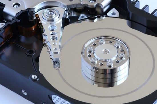

Usually the general consensus is that recovering information from a hard drive with head crash is very difficult, even many say it is almost impossible.
Examples:
https://vitaldata.ca/blog/unrecoverable.html
https://www.reddit.com/r/techsupportgor ... t/ck306ny/
I know that when a head crash happens small particles are scattered all over the plate, so that if we tried to read it we would crash again and generate new head crash.
But ... Could not we clean the platters of all the particles that could be and then read from the outer point of the platters to the point of the head crash?
At least, the files up to that point, could be recovered, right?. and the same with any type of damage such as a hole with a drill.
Maybe the firmware of some hard drives does not allow this "selective reading" action?
