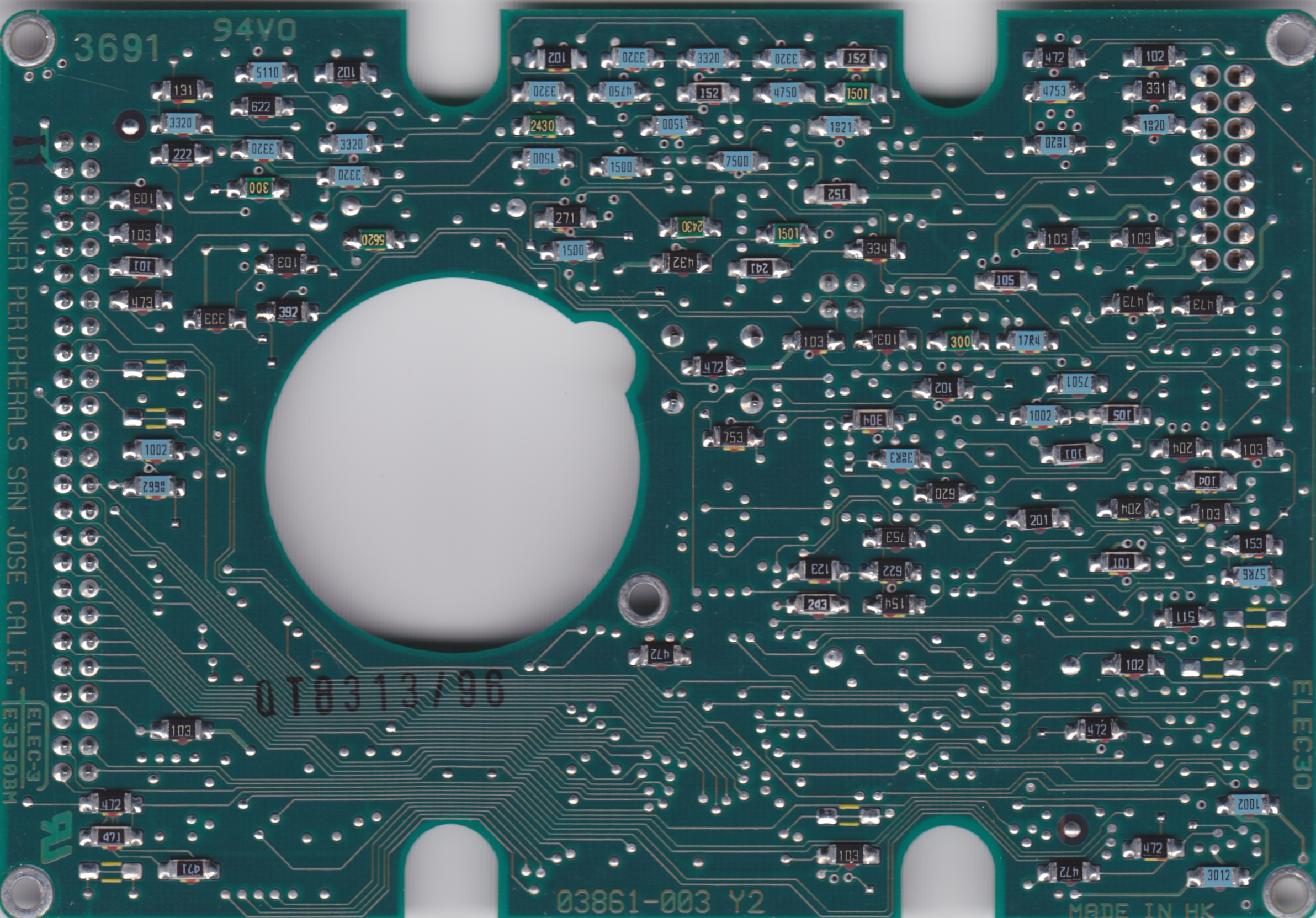

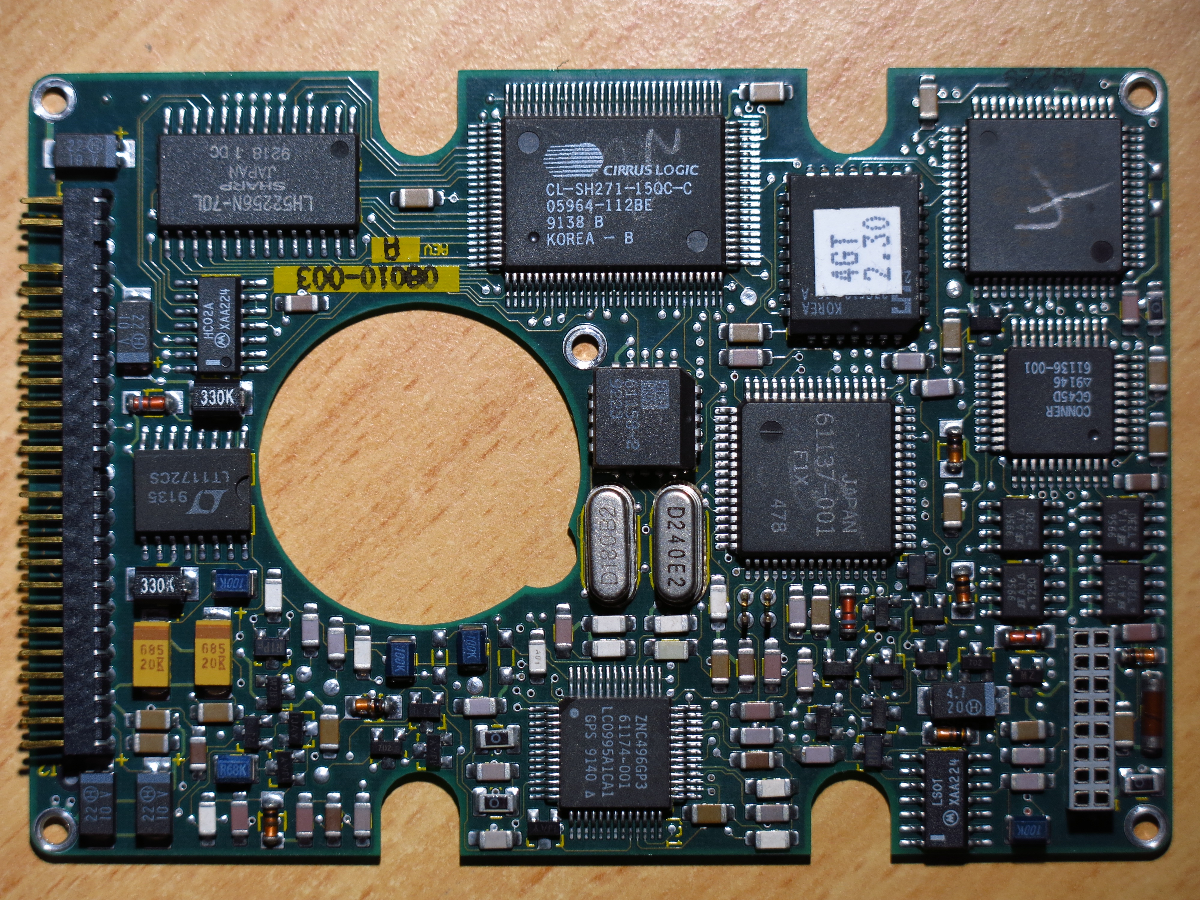

@fzabkar,
Here are some images of the CP-2088 PCB.
The back side came out pretty well in the flat-bed scanner.
The front side was completely out of focus, except the very tips of the pins which were perfect :-)
So I took a photo of that side.
