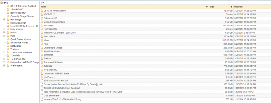

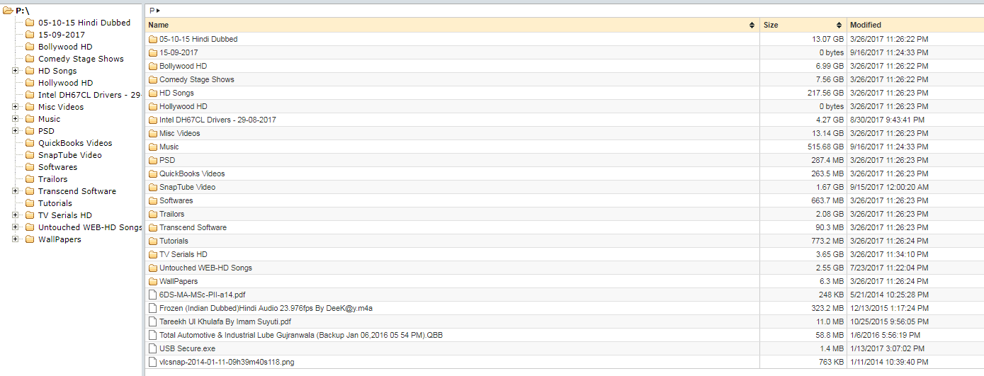

I had that drive folder snap back in 2017

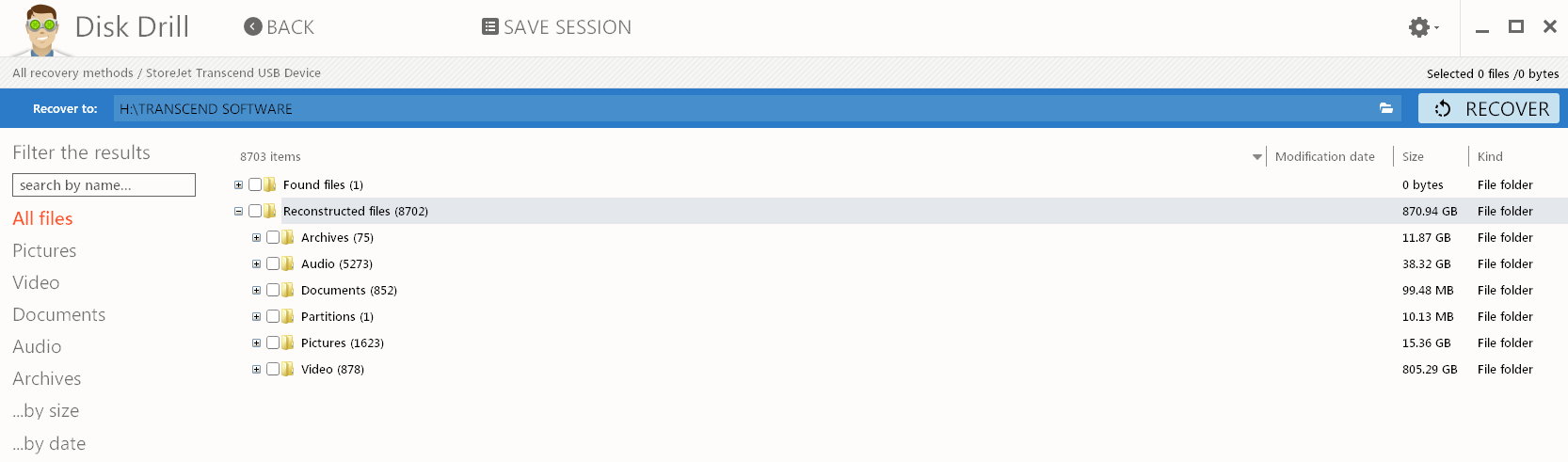

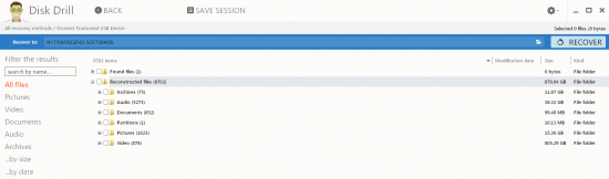

please see some results from DISK DRILL after Re-Scan.

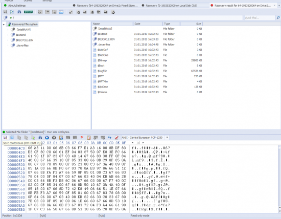

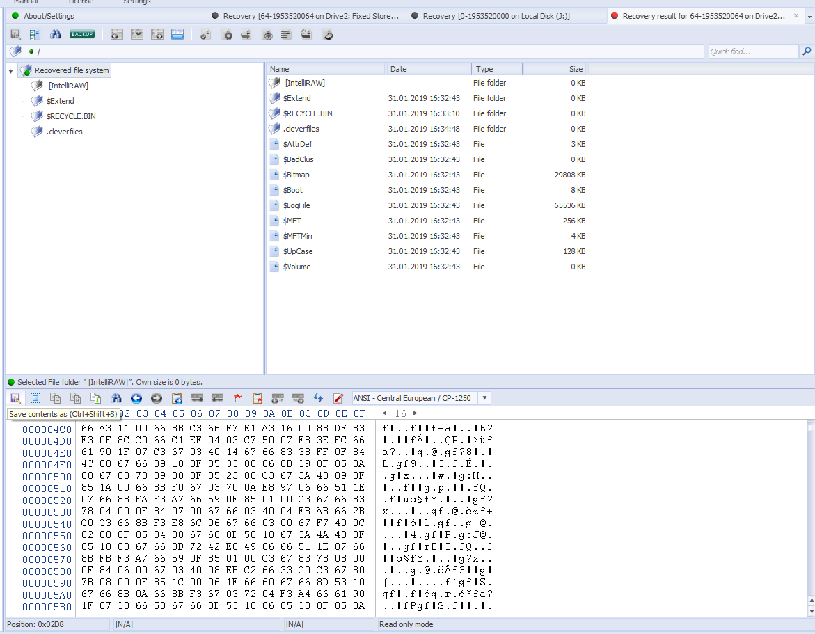

Here is the Scan Results with UFS Explorer

according to your post you used low level format. it means partiel hex codes totally wiped. normally main data structures stored in 0-5GB. normally you have run 3_4 min low level format, it means all DIR structures have permanently wiped out.(it depend your time and speed). maybe few stuctures can be there. some few structures canbe hold in defferant places on you drive. so don't keep hopes nomore about DIR. now you can recover RAW recover. means you can get files without original names like Recoverd video file 01, 02.
1st you have to run full scan and check how much original DIR you have. after that you should run FILE TYPES recover.

Thanks to all above for your precious comments.
I was able to get back almost 55% of my data with R-Studio (in RAW Folders).
the rest was found but in corrupt format.

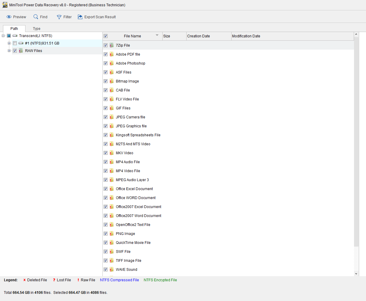

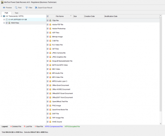

Dananjaya,
Here u can see Scan Results of POWER DATA RECOVERY.
Its almost same as previous two (R-Studio & Disk Drill).
Some large media files are corrupt at some points (those recovered files also stopped at same time frame)
Overall experience was great.it was easy to use , interface too simple & preview feature also good.

hi.
long files not working properly means, somerimes long files store in part by part in defferant palaces on the platter.
eg- we get 2tb file. assume 1st 300 mb store at LBA 500000. 2nd 300 maybe LBA 3600000. other parts would be LBA 8900000.
so this all info hold in DIR structures.if DIR sttuctures missing no one knows where is the other parts of files. RAW recovery system , search the file header and get data as a one position.
so don't try to repair it. it is only a waste.
