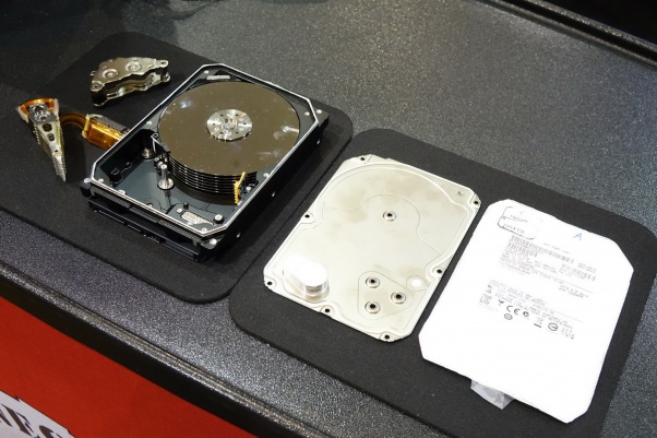

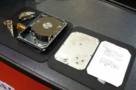

I did open helium drives with just good knife. There is normal cap with screws under aluminum foil, so it is hard to brake platters.

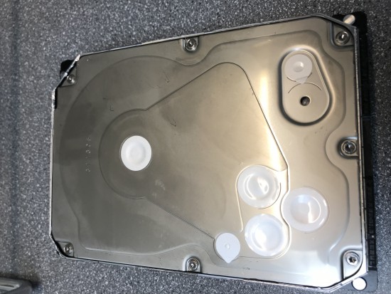

The ones we opened was all of them was with cap and screws under aluminum foil.

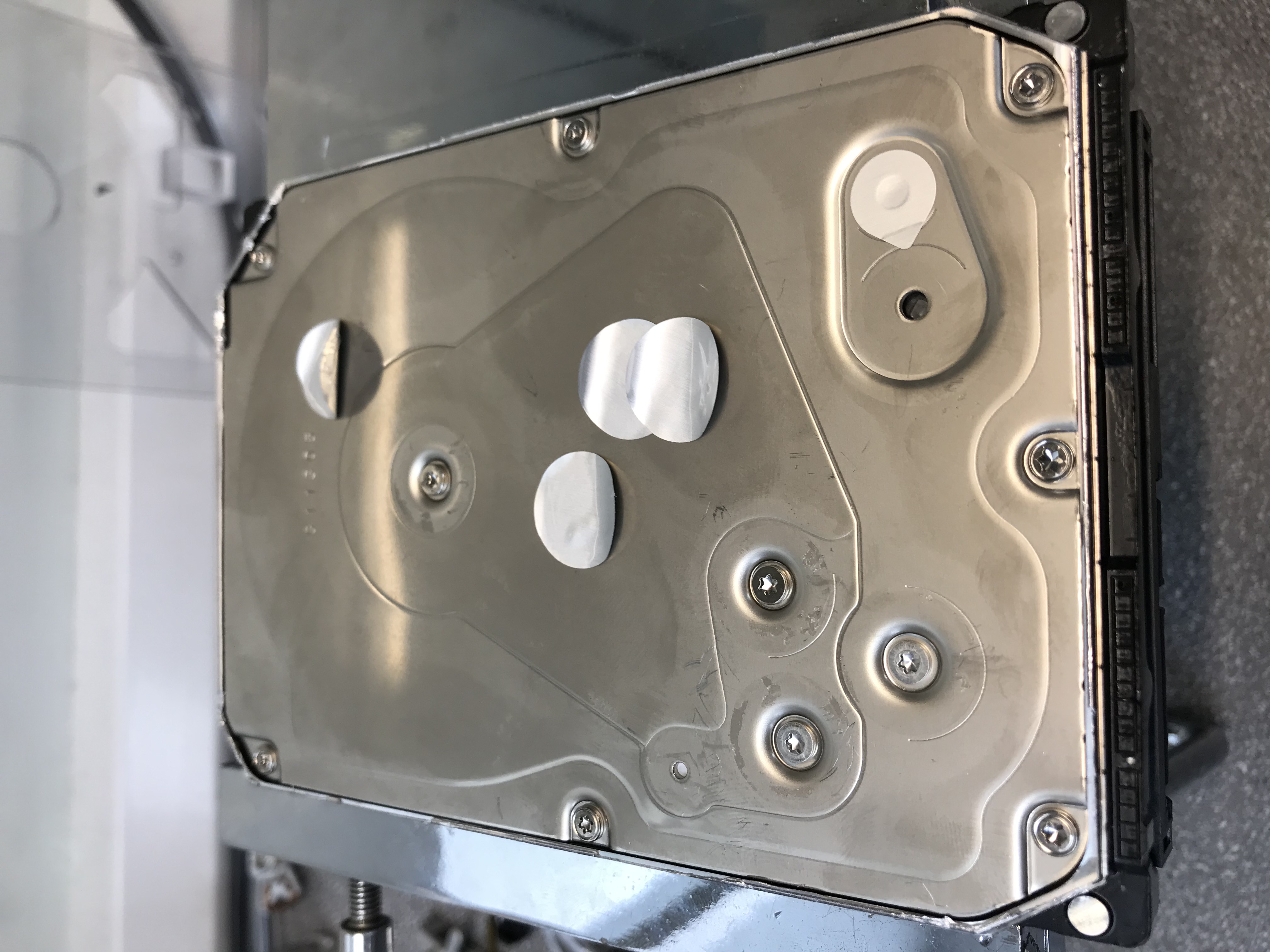

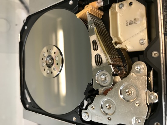

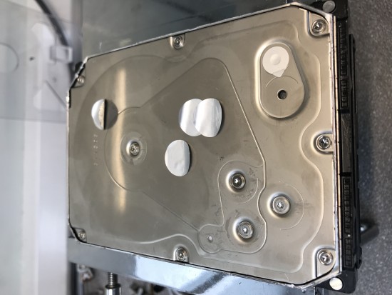

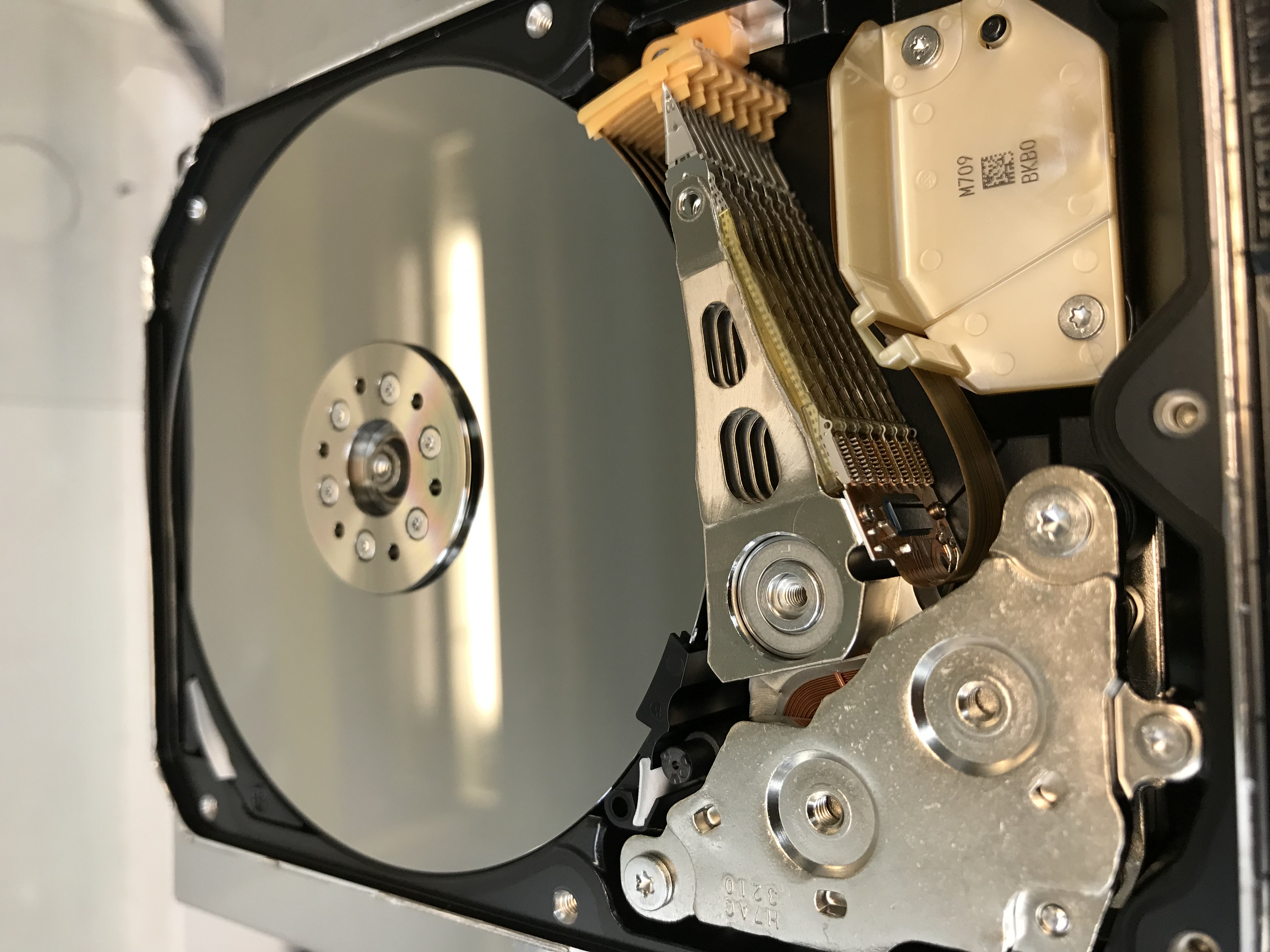

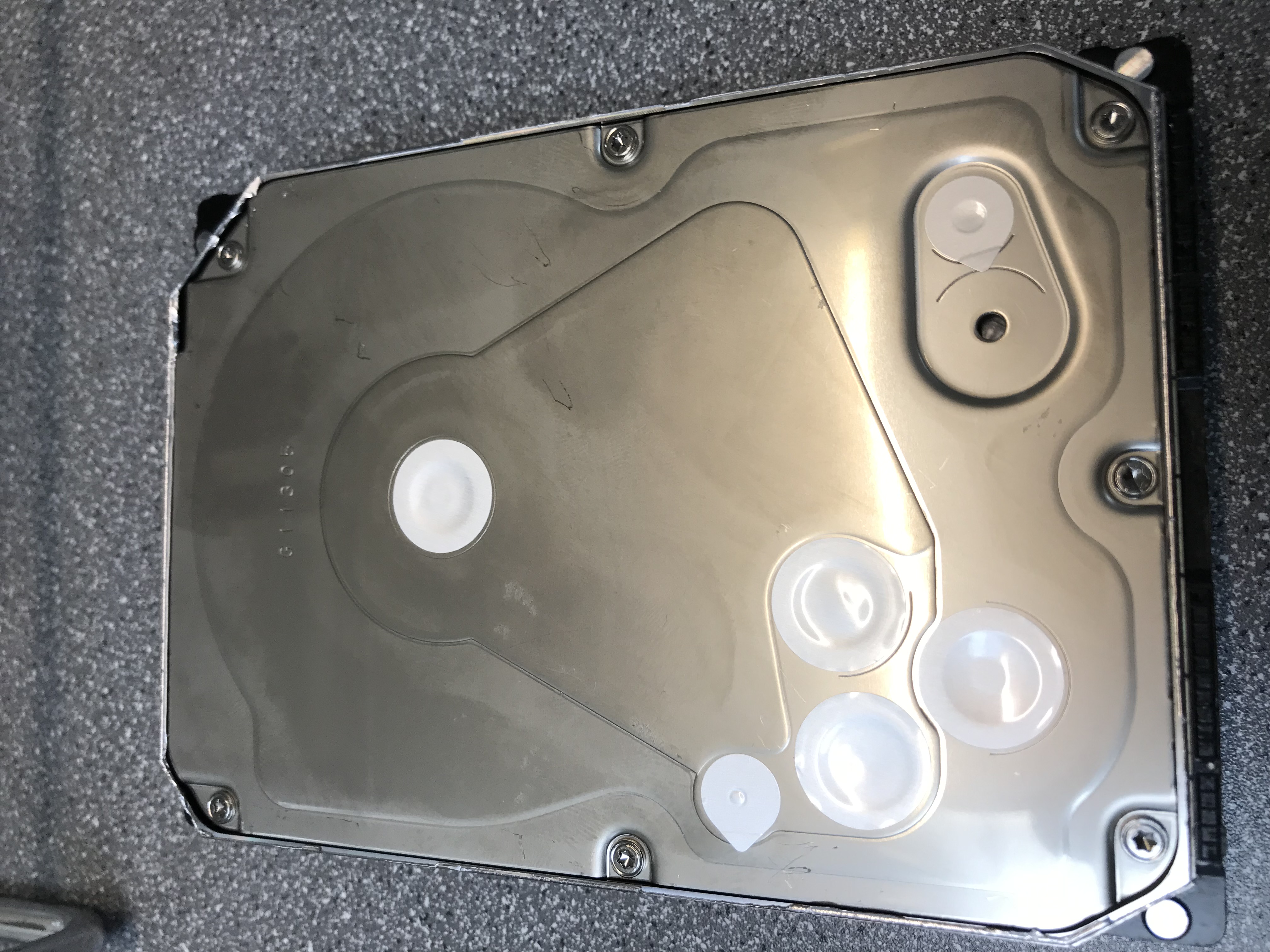

It seems you guys were correct.....
There are screws but under a VERY thick "foil" that looks liked it's welded to the edge of the drive. This "foil" was a pig to remove as it was about the same thickness as the Aluminium on a Coke can!
 Post subject: Re: Helium filled HDD: how hard are they to extract data fro
PostPosted: February 18th, 2019, 13:27
Damn,
14 Heads :mrgreen:
