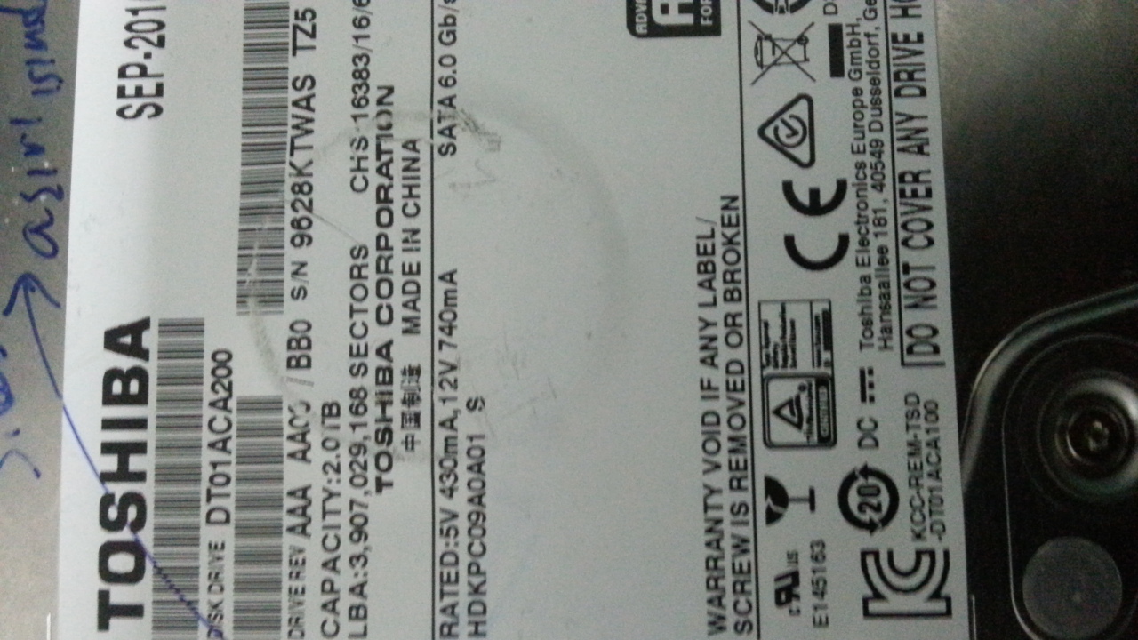

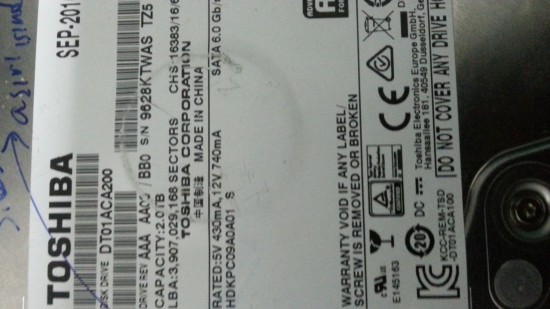

The customer has found an invoice with the model: toshiba dt01aca200 With this data would be enough?. We only have this information
Of course all this assuming that the ROM is alive. We just wanted to know if it's worth all the work.

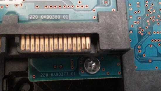

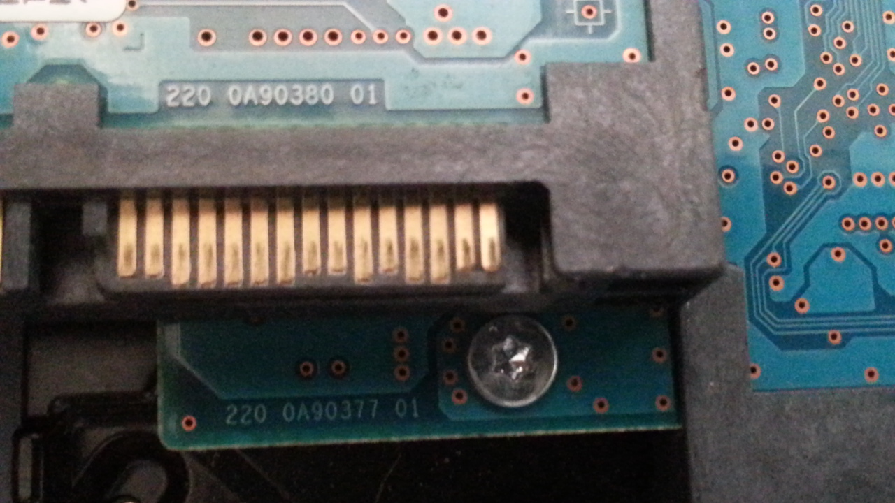

Hitachi !! probably 2 tb 3.5"
PCB 220 0A90380 01 (377 01 compatible , according to my last discover ,)

Although it's a Hitachi look-a-like, it's still a Toshiba.
The millionaire's question is, if the ROM is alive, is it worth the job ( swap platters is a lot of job ), not knowing for sure if it will work? What are the chances that this model works? We do not know whether to continue or not ... tomorrow we will check the ROM

Are you saying that this model does not use native Hitachi firmware architecture? :?
Would the OP mind uploading the ROM?
Here is a Hitachi model (HDS723030BLE640) with the same PCB:
https://www.hdd-parts.com/17110819.html

According to my notes model DT01ACA200 is just another 7210DLE6 ARM Hitachi drive. So I'm not sure what you're talking about here.

Yes, it's an HGST drive rebranded as Toshiba.
