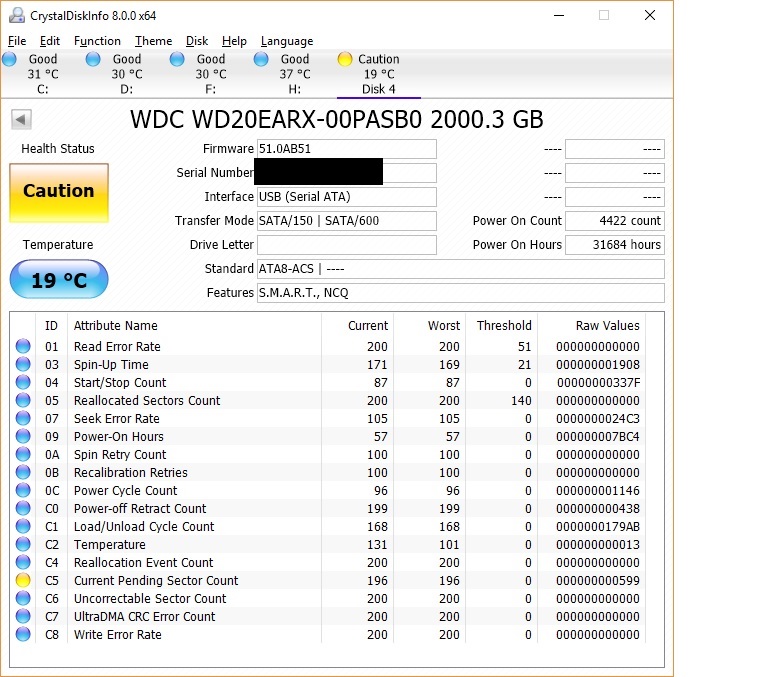

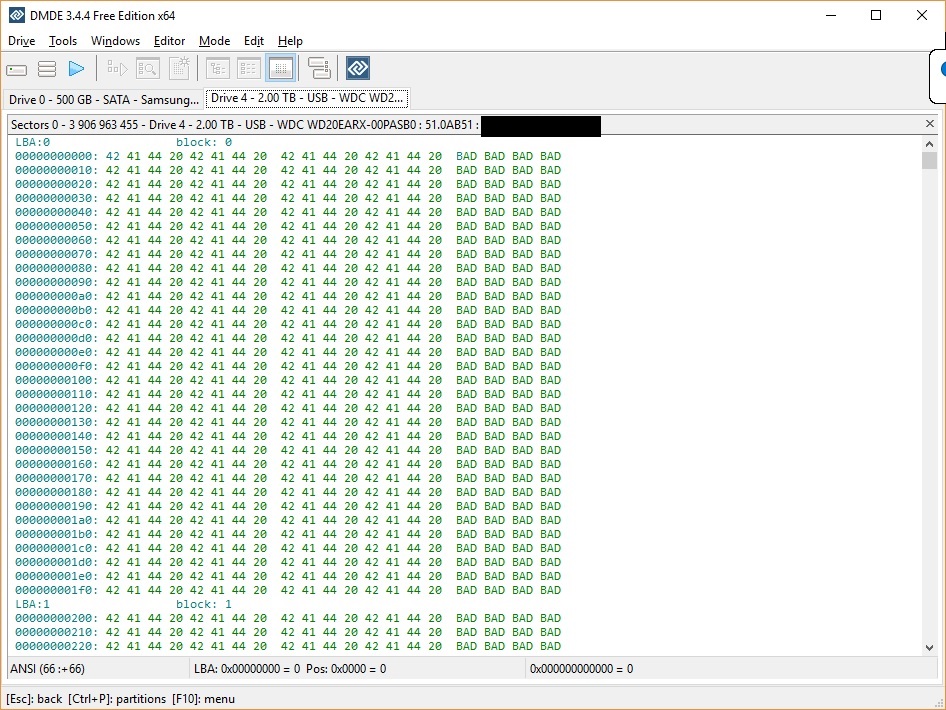

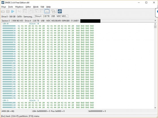

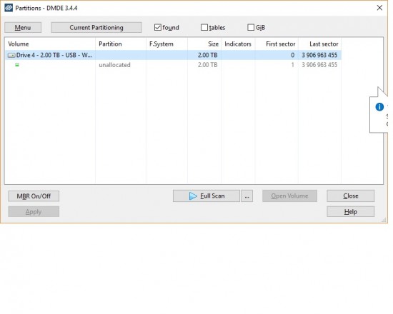

Hi all,

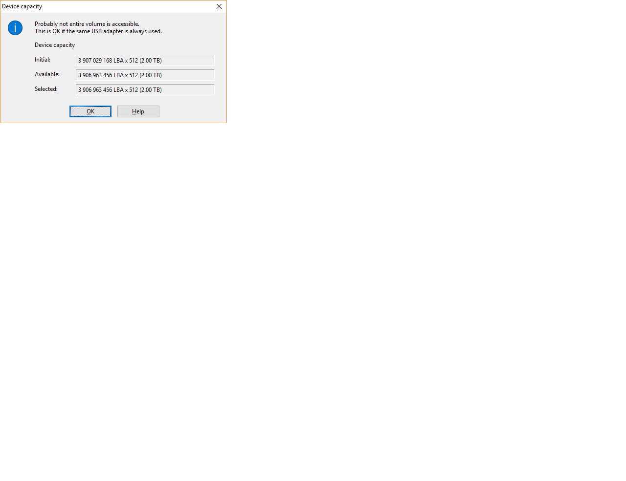

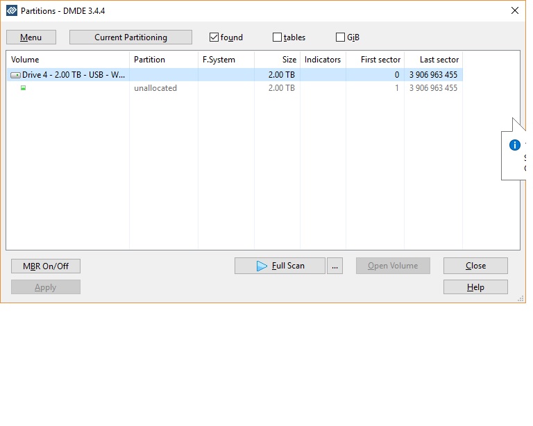

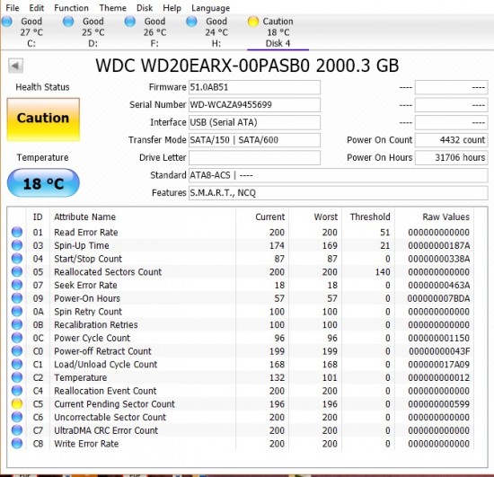

My external usb3 drive has died. Luckily I don't have anything important on it but after reading on data recovery I am now hooked on the topic and want this to be my first try at it. The drive is recognized in windows but no drive letter is assigned anymore. Disk Management says is requires initialization, which I did attempt and it failed. I have run it through crystaldiskinfo and dmde and the results are below. dmde gave an I/O error. I also got an I/O error before when I ran it through Data LifeGuard Diagnostics. Also I took some audio of the sound the drive is making and uploaded it as a zip file here since the forum doesn't allow MP3's. It spins up and after a few seconds starts doing a sound and it never stops and doesn't spin down.
Also I took the USB board off and then the PCB Board off. I noticed that the head contacts looked dark so I cleaned them with an eraser. It didn't change anything though.
Any help and guidance will be greatly appreciated. I'm excited and ready to learn!

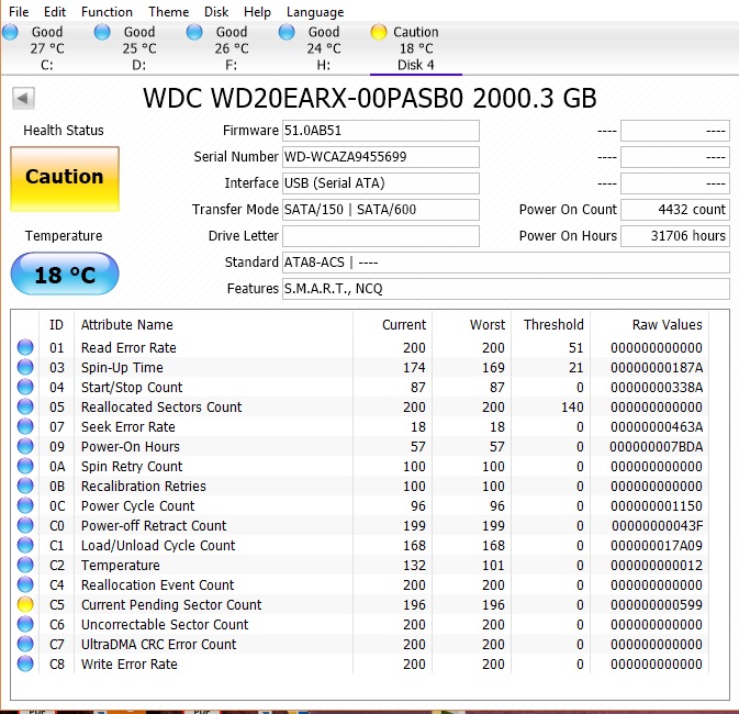

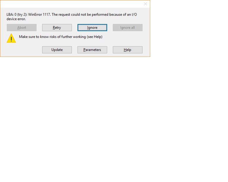

I was able to connect the bad drive on another PC I had running windows 7 x32. In Victoria 4.68b, the drive was recognized and SMART tested GOOD, much like CrystalDiskInfo, but when I ran a Test on the first 100,000 LBA's and it first gave an "recalibration..... Error" and then it went through the LBA's and they all gave "Error:ABRT". Does this mean the heads are completely dead? Should I open it to take a look? I will let it run though more LBA's but it's not looking good. :shock: :shock: :shock:
Any advice is truly appreciated. I can't find much on google for these errors. People state either FW problems or password, but the security states its "Frozen!".

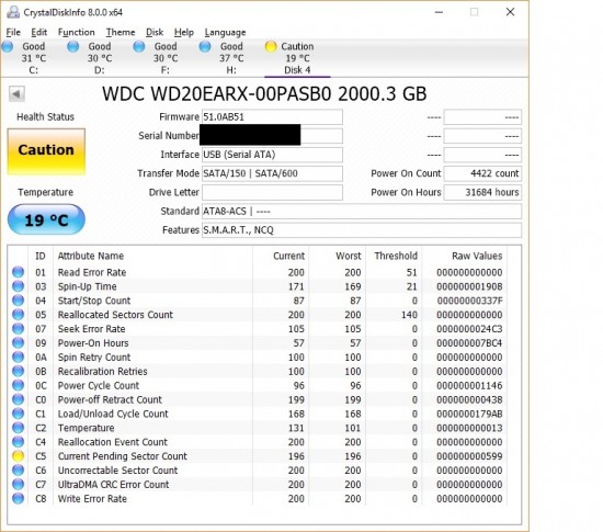

Spildit,
Attached you will see the CrystalDiscInfo after the mod. Any suggestions if this will be a problem for cloning or if I can test the drive prior to cloning somehow? Should I do an LBA read test with Victoria like before? Maybe on the 1st, last and middle 1%.
The data is not important to me...I'm here trying to learn with a drive and data that I don't care about.
Spildit
I reread the mod02 and mod32 and did a hex compare against the patched versions and they were identical. Did another SMART info and indeed there are still pending reallocations. So the modules are slow issue fixed but as you state the drive seems to be looking somewhere else for the re-lo list. I also tried to read a few LBAs and got the same errors as before. I understand that I have made it to the end of the available free solutions. What are my options to continue learning and diagnosing but while not having to spend a lot of money. Im really enjoying this and would really like to solve it.
Are you sure the drive is not security locked? That would cause the LBA aborts that you report from Victoria. Maybe the drive is locked by the USB bridge. Try putting it back in the USB enclosure and seeing if it can read. Read aborts are usually caused by two things, either the drive is security locked, or the translator has issues. The other possibility is that it was trying to read and failing, then the drive locked up due to a fatal device error, and all reads (and likely commands) would fail after that. Try to clone with HDDSuperClone for a minute and see what happens. Try both connected direct as SATA and also in the USB enclosure. If you don’t have a destination drive yet, use NULL (no destination) as the destination. You only need to run it for a minute to get an idea of what is going on. I can help diagnose from the HDDSuperClone log and output messages.
