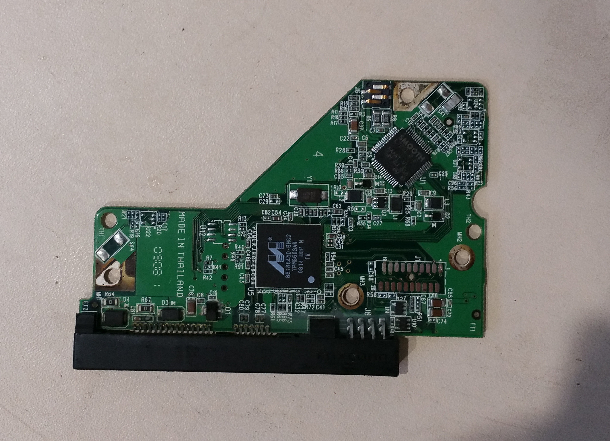

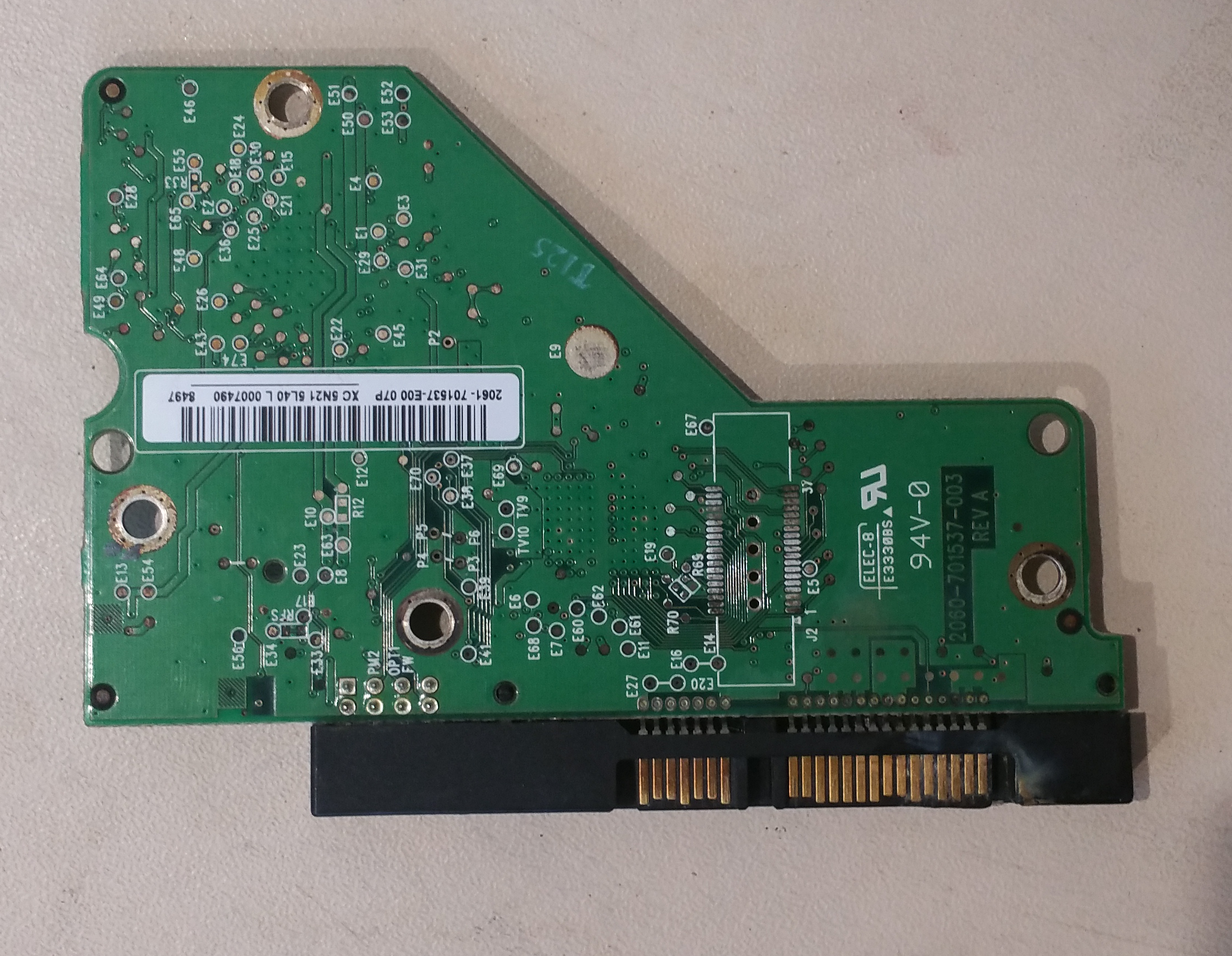

I used to backup on this hdd long time ago : external storage but I don't remember the psu power. Anyway, I came back home and it was burnt, did not work at all. I extracted the hdd and forgot it. Found it this week and spend some time reading and testing.
I may have done some mistakes, you tell me.
The hdd model is WD6400AAKS and the PCB 2060-701537-003 Rev A.
I plugged it and powered : Gnome-disks recognized it as a 1T0 hdd but testdisk did not ; the hdd would turn for few seconds then stopped.
I read this article : http://www.hddoracle.com/viewtopic.php? ... bc4df1057f
I clean the contacts. Now it turns smoothly : but no programm recognize it at all.
Here come some pics.
File comment: contact cleaned
File comment: It is not really burnt.
I don't know what to do anymore. I think I can't switch the pcb on this model. Could someone give me some clue about what to do? Something DIY?

Check diods first. I think D3 D4

OP said "Now it turns smoothly " so if the drive is spinning up it's not a diode problem. That would short out and turn off the power supply.
@lesyl, you are correct about that PCB not being one you can easily replace. It's missing the U12 ROM chip meaning the ROM code is embedded in the main IC chip. A very closely matched donor PCB may have a close enough code to still work, but it'd need to be VERY closely matched (like manufactured the same week) and require a bit of luck.
Someone with proper tools like PC-3000 can rebuild the code and set up a new PCB fairly easily though.
However, you should know that if the drive is spinning up your issue is unlikely to be related to the PCB anyway. It's more likely that the preamp or heads were damaged. Maybe some damage to the firmware code, bad sectors, etc. causing it to go unresponsive.
I really think you should seek out professional recovery if you value the data.
