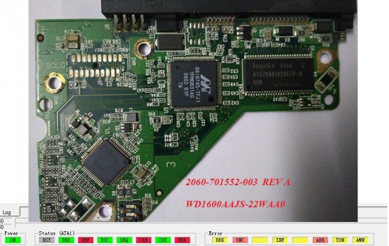

when connecting this pcb with hdd or PCB only in MRT
I m getting like this, What will be the Problem
PCB: 2060-701552-003 Rev. A

i have no donor PCB.
how to trouble shoot this pcb.
 Post subject: Re: WD PCB 2060-701552-003 REV. A -- Need Help
PostPosted: December 23rd, 2019, 18:41
Posts: 331
Hi!
Maybe the controller, or one of zero ohm resistor is dead. Try "smart hot swap" method!
PostPosted: December 23rd, 2019, 18:46
Posts: 17262
The MCU on this PCB is affected by "head mimic" faults.
If you wish to check the supply voltages, then measure Q1 (+3.3V), L1 (+1.2V) and the anode of D2 (-5V).
Note that the -5V rail may be switched on briefly and then switched off.
You might try installing the PM2 (PUIS) jumper. If the ROM supports this jumper, then the drive may come ready without trying to spin the motor.

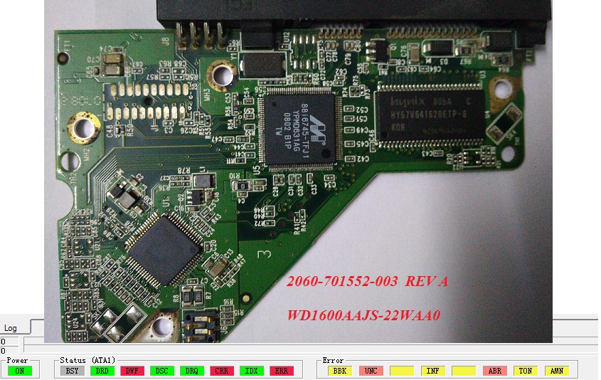

C18 Burned
PostPosted: December 24th, 2019, 14:38
Posts: 17262
So is the 1.2V Vcore supply missing?
PostPosted: December 24th, 2019, 23:45
Posts: 347
Location: india
yes
PostPosted: December 25th, 2019, 0:31
Posts: 17262
I'm assuming the capacitor is shorted, in which case you should try replacing it. I would choose a 10uF, 6V MLCC. You should be able to find a suitable replacement on a spare PCB.

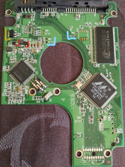

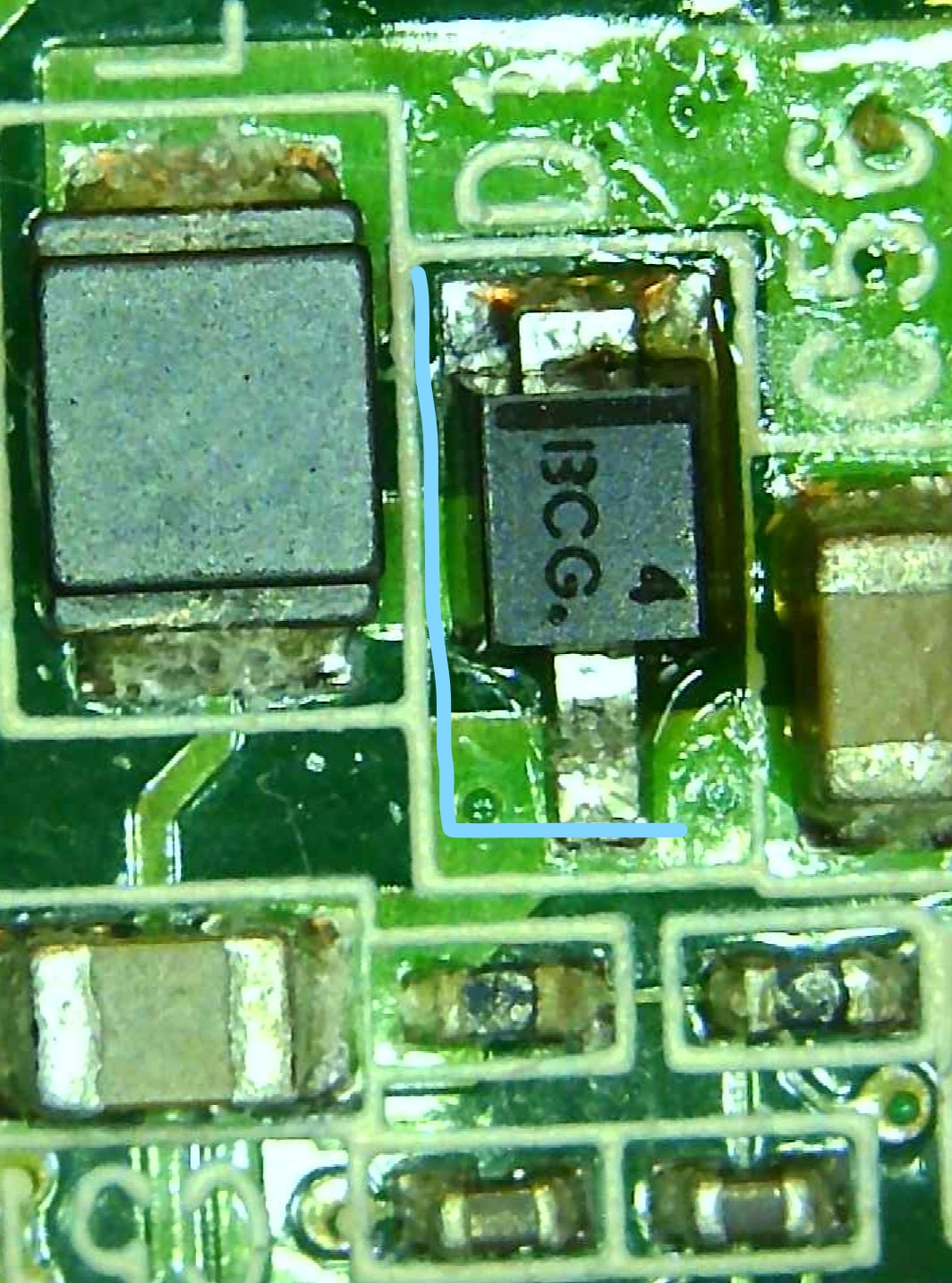

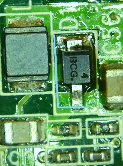

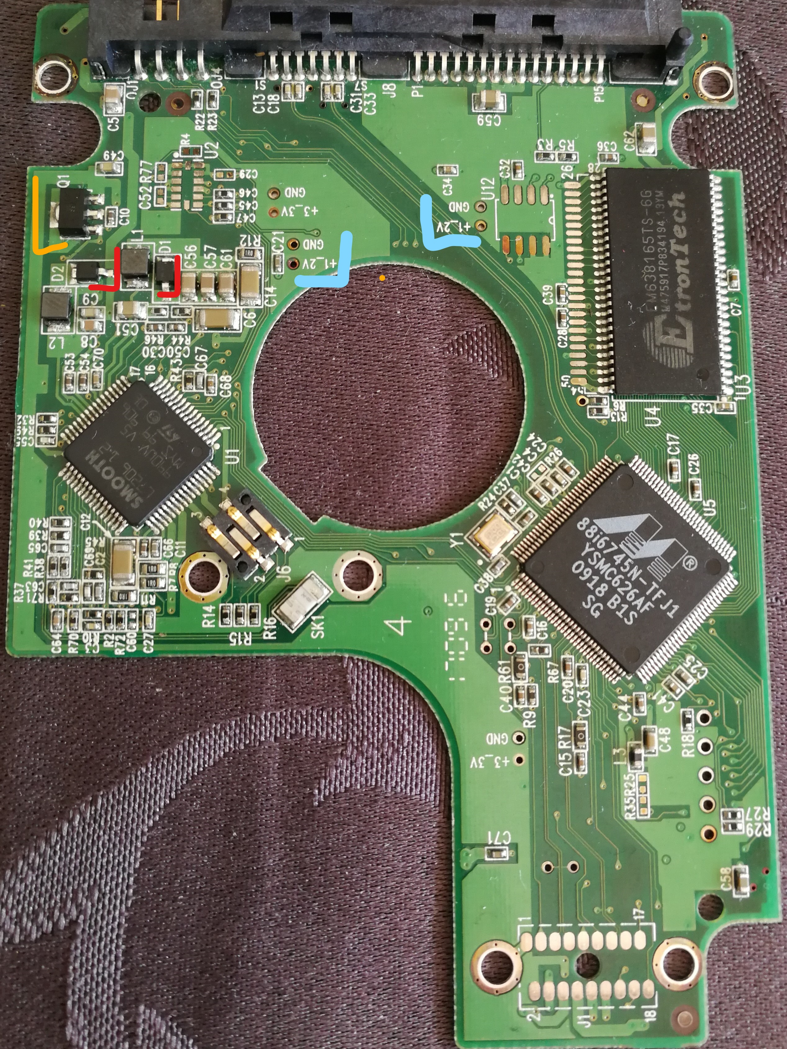

i need help do identify this part:
i3cg.
I don´t find any part in i-Net.
My measurement says 30pF?
It this part only an capacitator?
D1 and D2
At the measurment point i dont get 1,2V! I check only 15mV
File comment: D1?
File comment: PCB

most probably a schottky diode (a designator of Dxx rarely if ever means a cap), something like 30V/1A should be ok there i think. But i am wondering if there are other problems on the board too. What values do you measure on those diodes in diode checking mode? (both directions)

i solder the item out ant take a multimeter and my fine MTester 2.07
I check both direction with the same result --> 35pF

we don't want to measure capacitance, test it as a diode, pls.

I have check the parts as diode.
0,155v in one direction
and no result in the another direction. So the power can only go ine one direction ;)
The HDD dont Spin on, makes no sound. Not detectable..

Find a compatible PCB ( 2061-701499 ) replace and generate ROM from SA.
PostPosted: March 29th, 2020, 11:28
Well,
Someone has flashed the wrong rom and the pcb is now in a dead state ,It can be revived with a proper rom flash using com port interface " assuming its not bad electrically bad "

What did it mean --> SA?
i have ordered a compatible PCB in China and waiting for the item.
Than i must solder out an in the Chip 88i6745N
That is the difficult part :shock:
it is possible to read the chip an erase and program the other chip?
I have only tools to program SPI chips (like MX25V8006E)
best regards
System area.
You will NOT need to solder out, but you will need a proper tools to generate ROM from system area as this PCB doesn't have an external U12.
