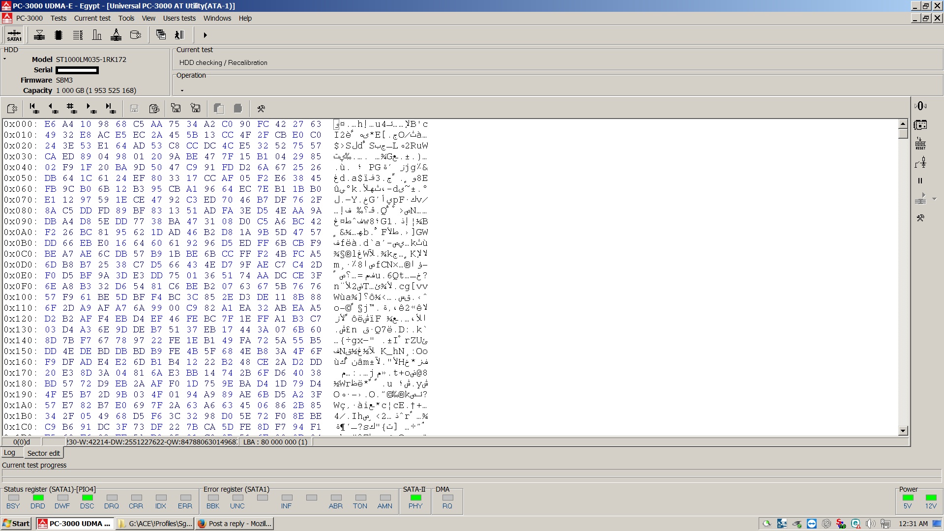

Hello
ST1000LM035
SBM3
1 TB
The drive in topic shows correct ID, capacity and FW then stuck in busy and no user area access.
Terminal output:
Boot 0x80M
QB
Rst 0x80MSrv DETCR init 0x0000
(P) SATA Reset
RAW OFF
PASS
(DOS Table) Worst Count: 000015F4 At SU: 00004888 NT: 0000000A OT: 0000000E
(POR) Recover Secondary MCMT Opened Recovered
(MC POR Duration): 0000000146
Send Status: COMRESET seen
CSpd= 6Gbps
Update Mask - 0000000006196520 - 00000008 - 00
Update Mask - 0000000006196528 - 00000008 - 00
Update Mask - 0000000006196530 - 00000008 - 00
Update Mask - 0000000006196538 - 00000008 - 00
Update Mask - 0000000006196540 - 00000008 - 00
Update Mask - 0000000006196548 - 00000008 - 00
Update Mask - 0000000006196550 - 00000008 - 00
Update Mask - 0000000006196558 - 00000008 - 00
Update Mask - 0000000006196560 - 00000008 - 00
Update Mask - 0000000006196568 - 00000008 - 00
Update Mask - 0000000006196570 - 00000008 - 00
Update Mask - 0000000006196670 - 00000008 - 00
Update Mask - 0000000006196678 - 00000008 - 00
Update Mask - 0000000006196680 - 00000008 - 00
Update Mask - 0000000006196688 - 00000008 - 00
Update Mask - 0000000006196690 - 00000008 - 00
Update Mask - 0000000006196698 - 00000008 - 00
Update Mask - 00000000061966A0 - 00000008 - 00
Update Mask - 00000000061966A8 - 00000008 - 00
Update Mask - 00000000061966B0 - 00000008 - 00
Update Mask - 00000000061966B8 - 00000008 - 00
Update Mask - 00000000061966C0 - 00000008 - 00
Update Mask - 00000000061966C8 - 00000008 - 00
Update Mask - 00000000061966D0 - 00000008 - 00
Update Mask - 00000000061966D8 - 00000008 - 00
Update Mask - 00000000061966E0 - 00000008 - 00
Update Mask - 00000000061966E8 - 00000008 - 00
Update Mask - 00000000061966F0 - 00000008 - 00
Update Mask - 00000000061966F8 - 00000008 - 00
Update Mask - 0000000006196700 - 00000008 - 00
Update Mask - 0000000006196708 - 00000008 - 00
Update Mask - 0000000006196710 - 00000008 - 00
Update Mask - 0000000006196718 - 00000008 - 00
Update Mask - 0000000006196720 - 00000008 - 00
Update Mask - 0000000006196728 - 00000008 - 00
Update Mask - 0000000006196730 - 00000008 - 00
Update Mask - 0000000006196738 - 00000008 - 00
Update Mask - 0000000006196740 - 00000008 - 00
Update Mask - 0000000006196748 - 00000008 - 00
Update Mask - 0000000006196750 - 00000008 - 00
Update Mask - 0000000006196758 - 00000008 - 00
Update Mask - 0000000006196760 - 00000008 - 00
Update Mask - 0000000006196768 - 00000008 - 00
Update Mask - 0000000006196770 - 00000008 - 00
Update Mask - 0000000006196778 - 00000008 - 00
Update Mask - 0000000006196780 - 00000008 - 00
Update Mask - 0000000006196788 - 00000008 - 00
Update Mask - 0000000006196790 - 00000008 - 00
Update Mask - 0000000006196798 - 00000008 - 00
Update Mask - 00000000061967A0 - 00000008 - 00
Update Mask - 00000000061967A8 - 00000008 - 00
Update Mask - 00000000061967B0 - 00000008 - 00
Update Mask - 00000000061967B8 - 00000008 - 00
Update Mask - 00000000061967C0 - 00000008 - 00
Update Mask - 00000000061967C8 - 00000008 - 00
Update Mask - 00000000061967D0 - 00000008 - 00
Update Mask - 00000000061967D8 - 00000008 - 00
Update Mask - 00000000061967E0 - 00000008 - 00
Update Mask - 00000000061967E8 - 00000008 - 00
Update Mask - 00000000061967F0 - 00000008 - 00
Update Mask - 00000000061967F8 - 00000008 - 00
Update Mask - 0000000006196800 - 00000008 - 00
Update Mask - 0000000006196808 - 00000008 - 00
Update Mask - 0000000006196810 - 00000008 - 00
Update Mask - 0000000006196818 - 00000008 - 00
Update Mask - 0000000006196820 - 00000008 - 00
Update Mask - 0000000006196828 - 00000008 - 00
Update Mask - 0000000006196830 - 00000008 - 00
Update Mask - 0000000006196838 - 00000008 - 00
Update Mask - 0000000006196840 - 00000008 - 00
Update Mask - 0000000006196848 - 00000008 - 00
Update Mask - 0000000006196850 - 00000008 - 00
Update Mask - 0000000006196858 - 00000008 - 00
Update Mask - 0000000006196860 - 00000008 - 00
Update Mask - 0000000006196868 - 00000008 - 00
Update Mask - 0000000006196870 - 00000008 - 00
Update Mask - 0000000006196878 - 00000008 - 00
Update Mask - 0000000006196880 - 00000008 - 00
Update Mask - 0000000006196888 - 00000008 - 00
Update Mask - 0000000006196890 - 00000008 - 00
Update Mask - 0000000006196898 - 00000008 - 00
Update Mask - 00000000061968A0 - 00000008 - 00
Update Mask - 00000000061968A8 - 00000008 - 00
Update Mask - 00000000061968B0 - 00000008 - 00
Update Mask - 00000000061968B8 - 00000008 - 00
Update Mask - 00000000061968C0 - 00000008 - 00
Update Mask - 0000000006196BE8 - 00000008 - 00ProcessRC: 00000000,00000000ReadContinuous: 00C32D7E,00000258TotalEntries:0000 XfrLen:0258UnrecovSectorCount:0000,0000NumUDEs: 00000000,00000000Failed: 40000087Out:
SP Regen FAIL
SPRegen [0000|43110081] @LBA=0x00C32D7EOut:
SP Regen FAIL
Any suggestions?

can you access terminal Level T> ?

unknown wrote:
ST1000LM035
Terminal output: ...
Classic - MC has failed. Could be due to defects or drive's inability to write.
Another possible option is reading issues.
Unless there were improper recovery attempts, which made the situation worse (not uncommon with the cases like this), chances are high that the data is recoverable.
Yes.

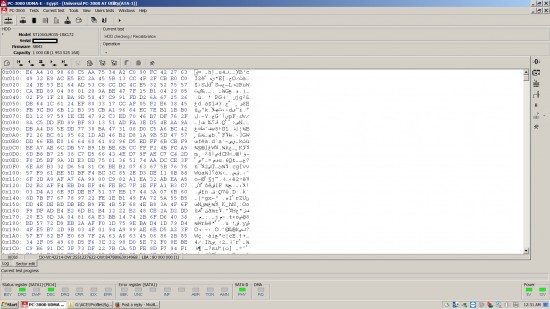

PostPosted: February 27th, 2018, 7:54
Posts: 1748
I have backed up sys files and regen trans. The drive is stable now but with user area limit access to LBA 67000000.
tried to write back original translator but MRT doesn't support sys file/mods writing. :D
Any suggestions?
Thanks in advance

If you have backups, not all is lost.
Maybe we need to add to the usual instructions to backup modules first, the important part that is to know if one´s firmware tool can *write* those modules back.
Do you have another fw tool to try writing the modules back ?
Is it possible to write it back through terminal, even if it is to mean a lot of manual work ?

A friend of mine has PC3K UDMA. We will try to write original resources back.

(Patch ROM
Send handshake to access SA
Access SA and read backup of file 3_028_0
Next, run translator regeneration
Repower HDD and send handshake again
now try sector edit - if first and last LBA can be read, then you can recover now.
If last LBA cannot read, then write original 3_028_0 to module 2B in modules table)
This advice has given to me from a reputable member of this forum (all old members knows him perfectly )
So, I didn't recklessly regenerate translator before I took the advice to.

PostPosted: March 1st, 2018, 6:39
Posts: 1748
@ Doomer
Unfortunately, I will continue doing data recovery. :mrgreen:
Case solved
Special thanks to my friend Tawfeek_Mokhtar. :good:
