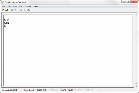

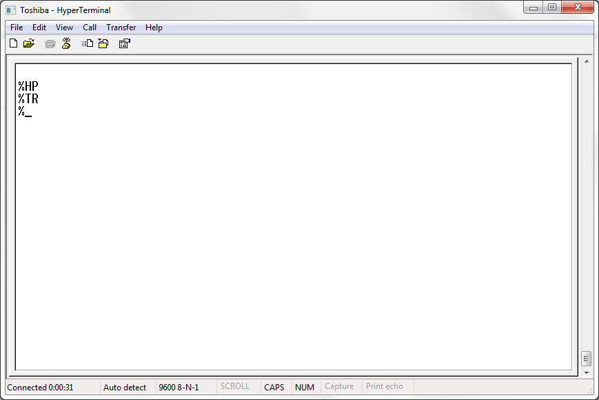

 Post subject: Re: TOSHIBA MK7575GSX - ROM Problem
PostPosted: March 5th, 2019, 13:41
Posts: 474
Location: spain
This is what I get per terminal.
It does the same as if I remove the ROM.
I think the MC is working with the BOOTLOADER.
PostPosted: March 5th, 2019, 15:12
Posts: 849
OK. The ROM is already dead.
The next time you'll kow what to do first.
