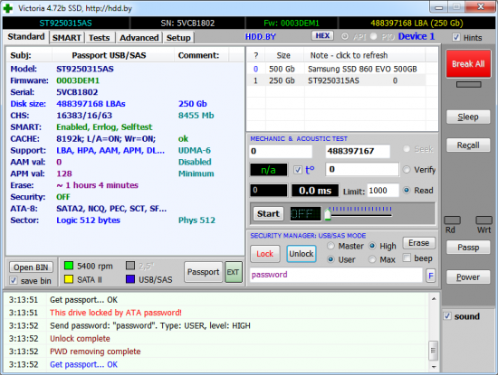

A couple of things you can try.......
I would use Victoria for Windows.
1. Just type the word password in the box.
2. Input the hex value for the word password: 70617373776f7264
With method 2 you might need to use a 32 byte password so it would need to be padded out with zeros? This would probably be the method to use with Mhdd.

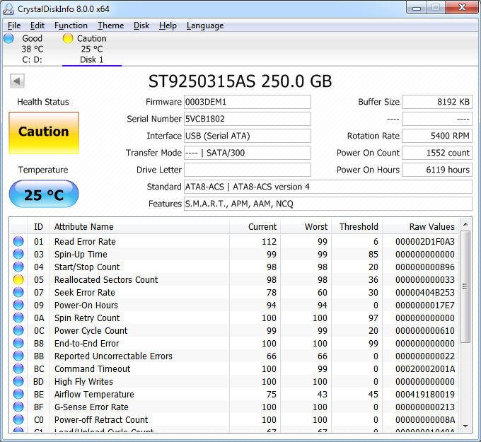

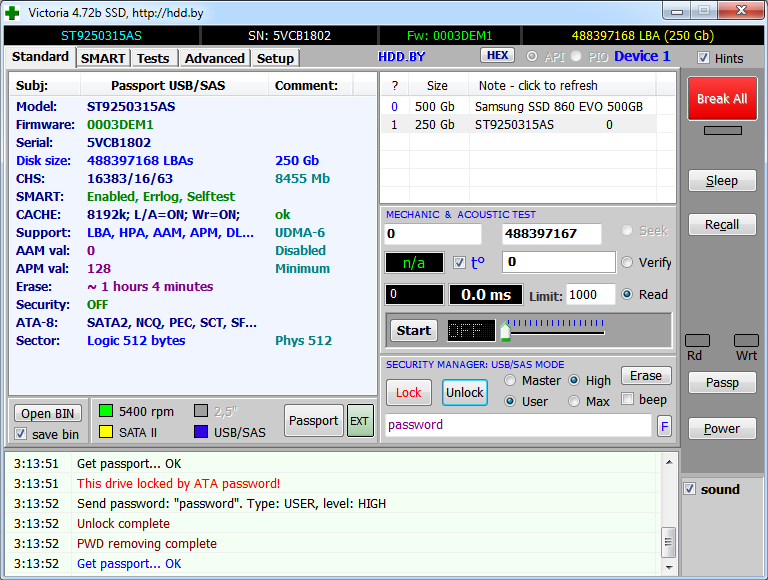

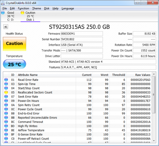

Victoria for Windows worked, using it with a USB 3.0 to SATA adapter, go figure. The drive is showing some bad sectors now that weren't there before even considering the age of the drive but, that's impressive that it worked as well as it did so thank you very much for that method, dick. :)
Not that it matters but here's what I saw with Victoria and then CrystalDiskInfo.
Thanks again for the assistance, folks, it's greatly appreciated. ;)
