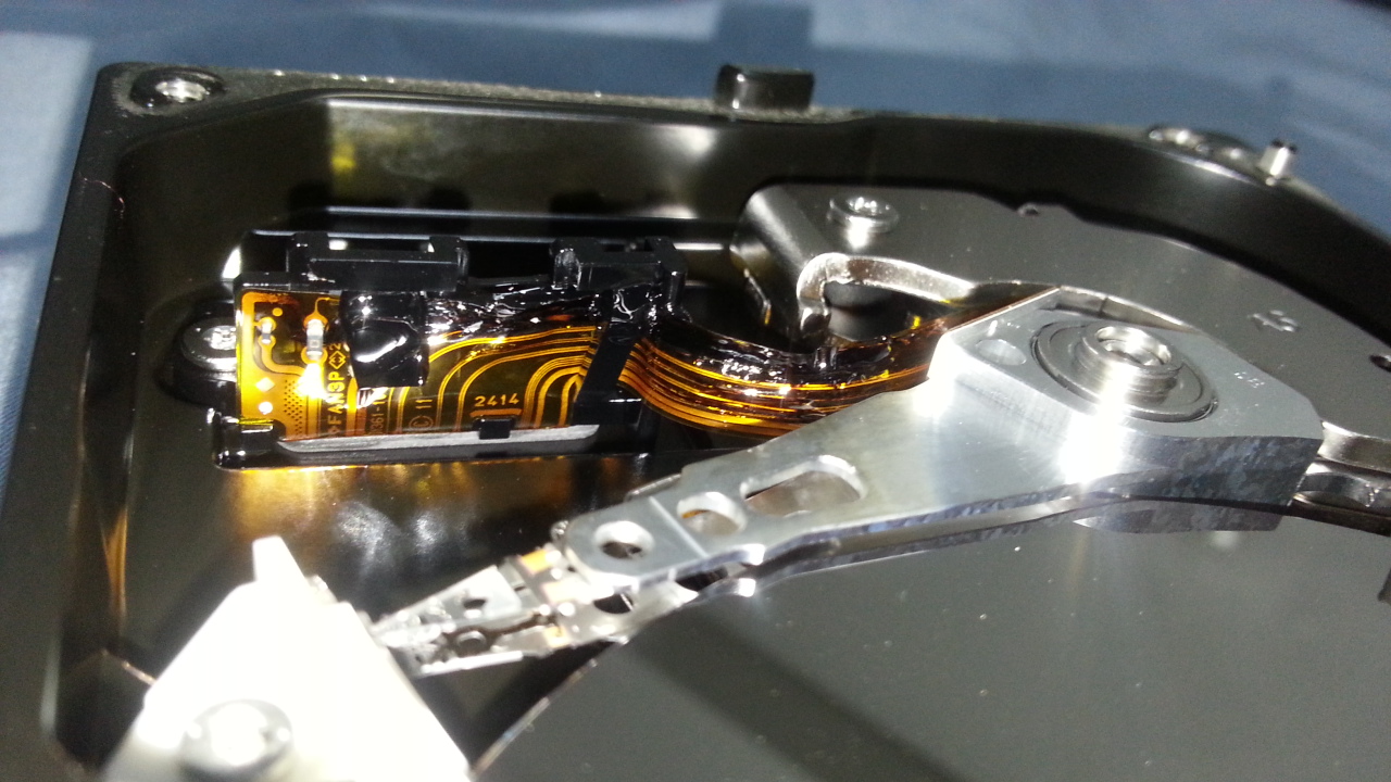

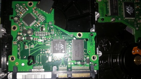

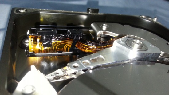

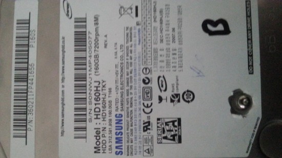

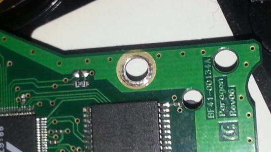

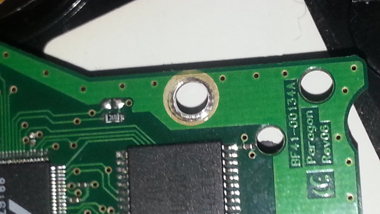

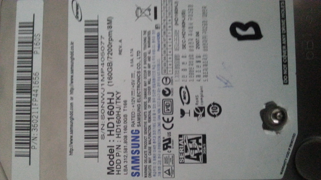

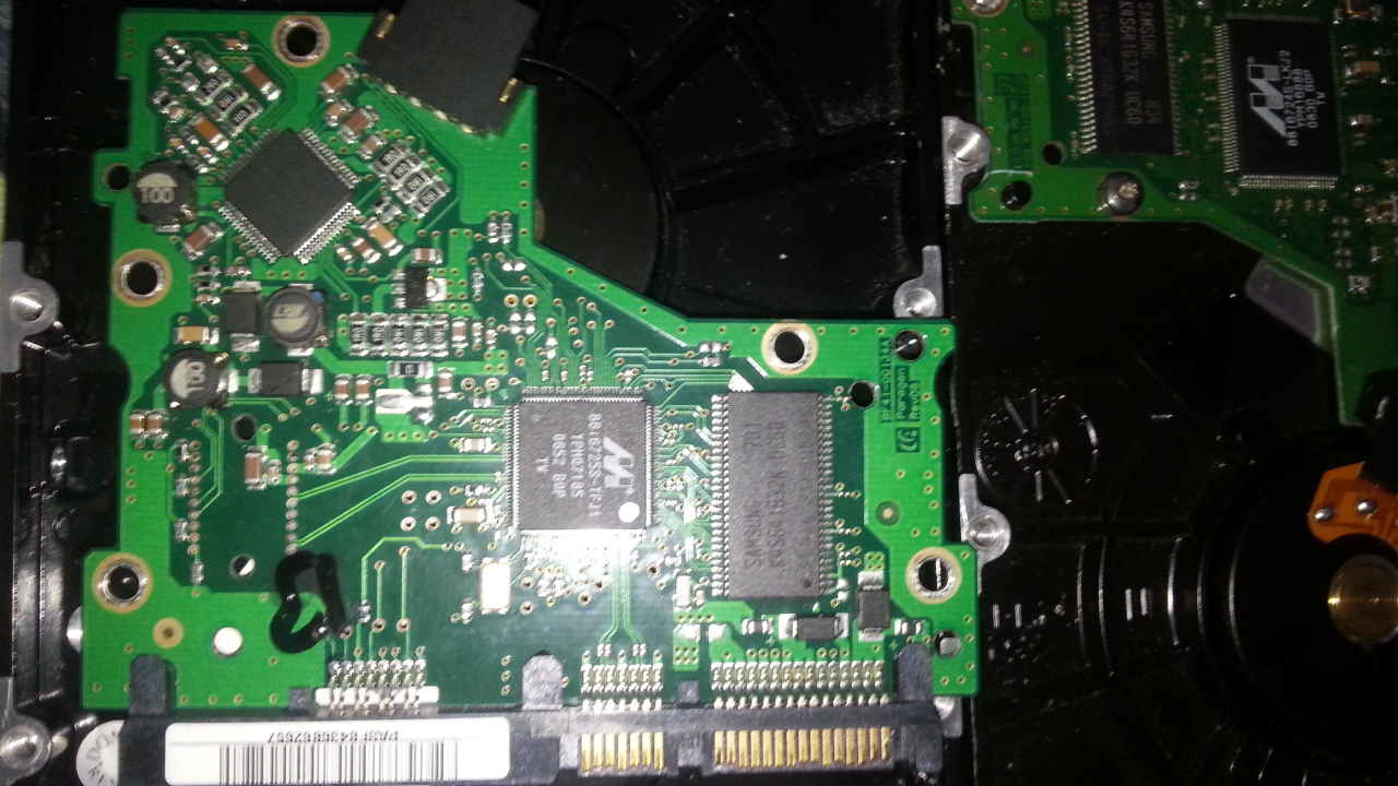

Hi.
I have a bad case.
HD160HJ PCB not working Plus Head damage.
Drive history.
Customer pluged in high voltage . After then he swapped platter to another HD160HjI drive. But Different PCB number , different manufactured country, seems different family.
There is 2 problem.
1st
I have checked patient pcb diods normal. In MRT only busy light on. Cannot read Rom. Also no external Rom chip. It's embedded. Cannot read Rom . I don't know still alive ROM data . I think it's family T166
2nd.
Platter looks dirty. Need clean. And head looks died.
Firstly how can I get ROM data ?. I searched . Thanks Spildit shared a way. hot swap method with compatible donor .
I need advice

I mean you shared ROM recover when platter and heads original and working . I read this.

 Post subject: Re: HD160HJ PCB not working Plus Head damage
PostPosted: March 10th, 2019, 8:25
Joined: February 2nd, 2019, 1:21
Posts: 192
Location: Sri Lanka
hi HddDonor
i think you can use same pcb without rom. even 1tb like 103.. no need rom firmware transfer to donor pcb.
however can you upload the plater pictures.
PostPosted: March 10th, 2019, 9:04
Dananjaya wrote:
hi HddDonor
PostPosted: March 10th, 2019, 10:55
Posts: 489
Location: Usa
Thanks for detailed information.
Customer approved all kind risks.
I will try to clean platters. I did it before another model some fingerprint parts cleaned. And get partial data. But this platters look very bad. We will see what will happen

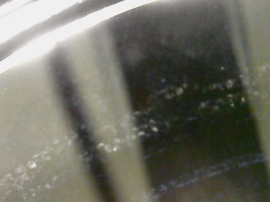

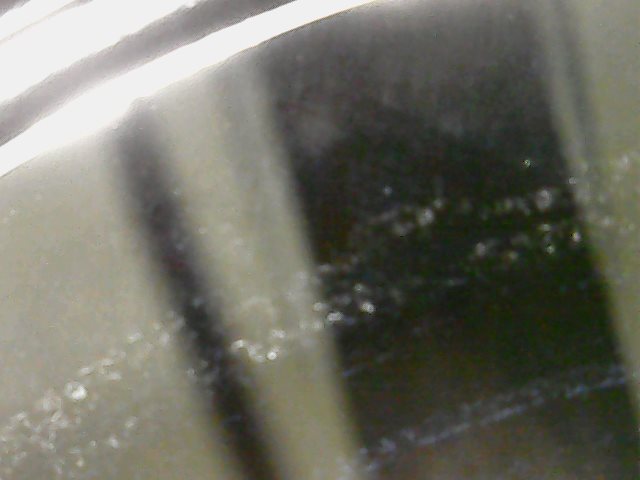

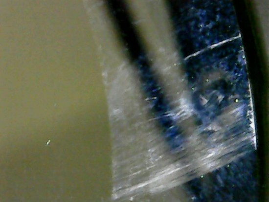

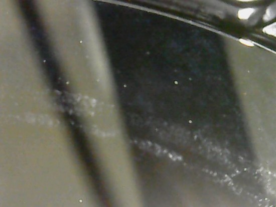

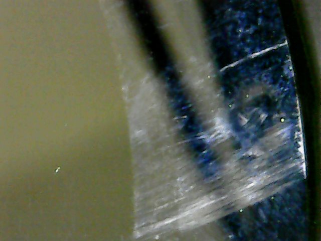

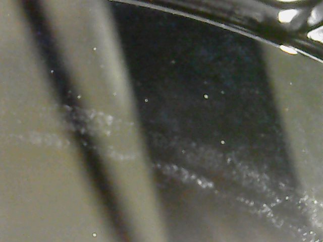

PostPosted: March 11th, 2019, 11:10
Posts: 489
Location: Usa
Spildit wrote:
Just for us to have some weekend fun .... can you upload a photo of the platters ?
Sexy Womans from your town

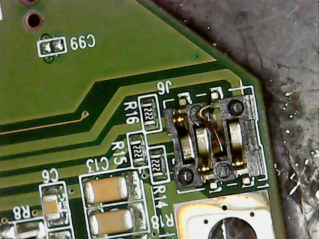

PostPosted: March 11th, 2019, 11:16
Posts: 489
Location: Usa

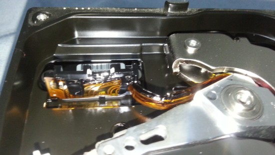

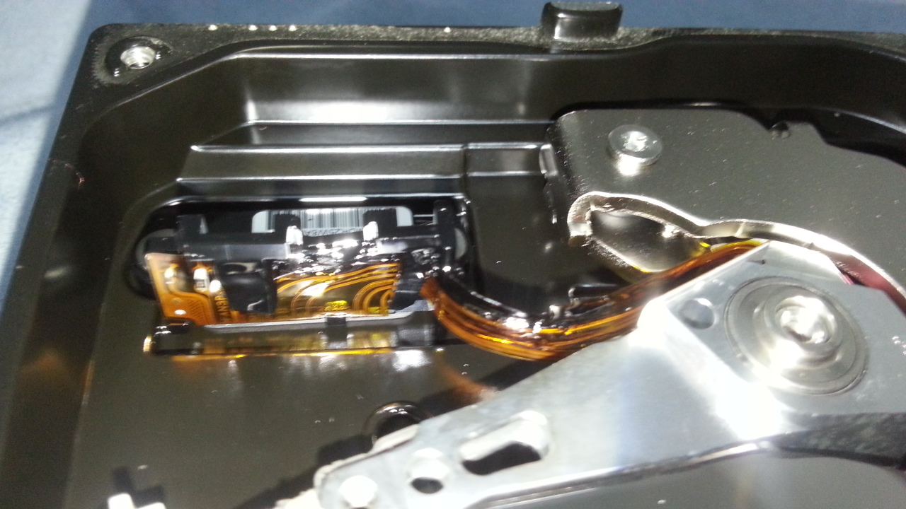

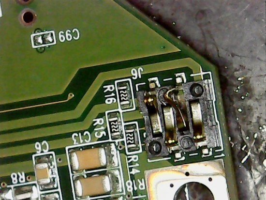

This is real fun.
When my trying to learn something. I have isolated PCB. Then final in pictures.
Hdd not work after isolated. I guessed head problem. I felt bad smell. Lol. Opened hdd.
PostPosted: March 12th, 2019, 3:50
Wow, this is a “DIY disaster “ turned up to 11 !!!!
PostPosted: March 12th, 2019, 5:48
Posts: 489
Location: Usa
Spildit wrote:
Those platters are un-recoverable.
If you do need to recover data from those you will need a time machine.
I think same after when I look again the platter for taking photo. 1st was short look.
