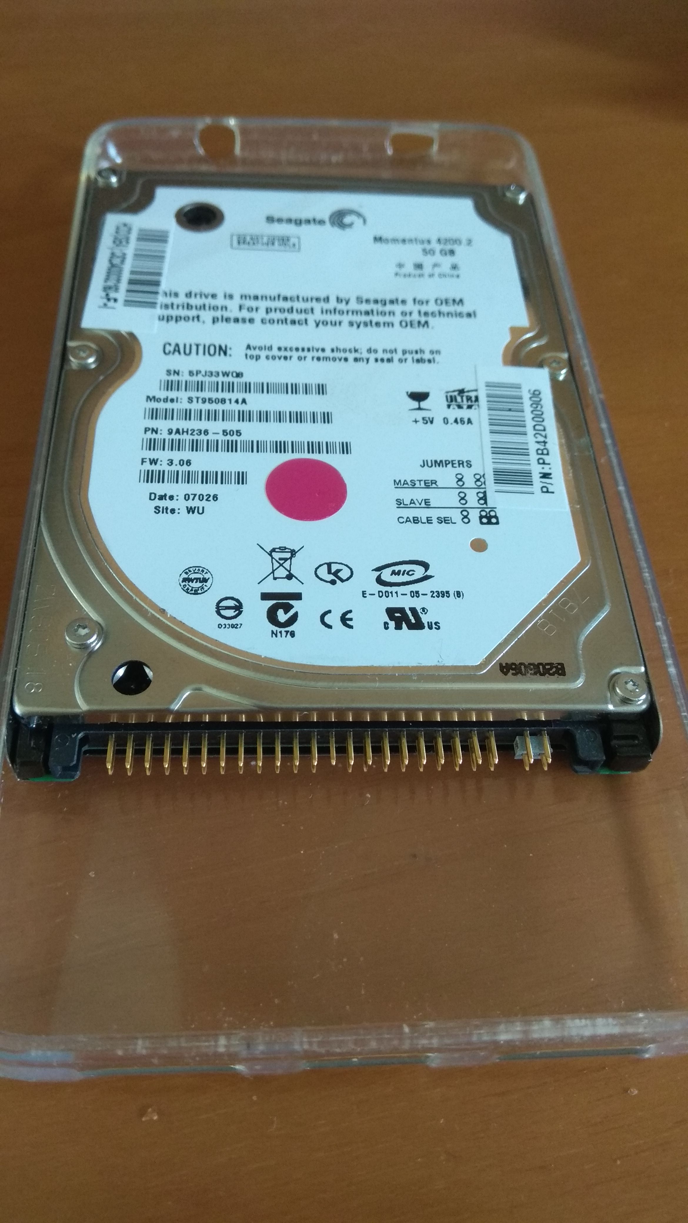

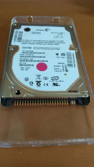

Hi guys. My laptop has this hdd:
---2.5" mechanical IDE
---Seagate Momentus 4200.2
---model st950814a
Recently I changed the Hdd password from BIOS but I can't remember it. I followed some guides found on internet so I tryed to unlock the hdd using 2 softwares from hiren boot cd. The procedure asked me the Hdd master password, I typed "Seagate"+ 25 spaces but it results as a wrong password.
What can I do to unlock the disk? (firmware update, hdparm, other programs ecc...)
I could use FF repair station software but in my case I need an Ide to Sata adapter to connect this hdd to my desktop PC. Will the software work correctly?
Thanks in advance, Michele

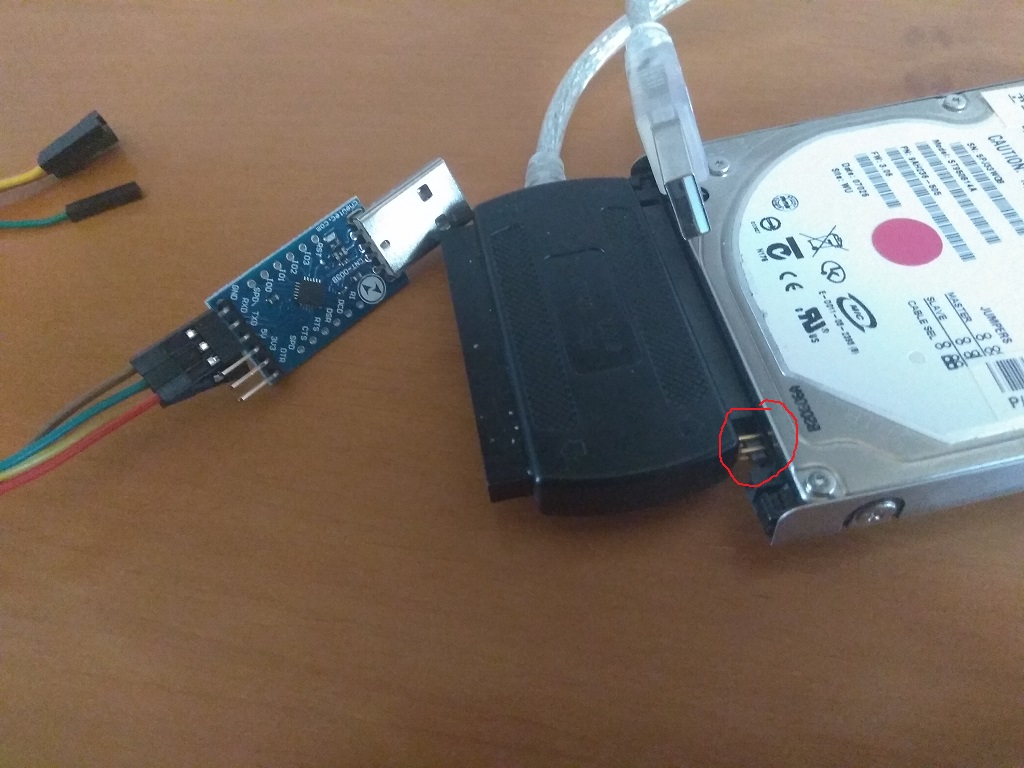

1) Connection
I'll post here an image to show you if I connected the HDD the right way (it's very simple but it's better to be 100% sure)
2) Read
I just have to read the vendor track to get the password, I don't want to write anything to HDD for now.
The method described in this post ( http://www.hddoracle.com/viewtopic.php?f=83&t=25#p3574 ) is very simple, if I understood right it just requires the "STCom" software and I'll get a dump of the vendor track
The problem is that I googled for this STCom tools, but I didn't find any download link :cry:
http://www.instagram.com/_mik_el

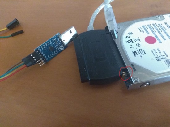

Forgive my ignorance but I didn't expect this...
How can I connect the ttl connectors to my hdd if the power adaptor is physically in the way?
Moreover reading this connection guide (http://www.hddoracle.com/viewtopic.php?f=6&t=193) I don't understand why I have to connect the TX RX and GND cable to the ttl adaptor but I have to connect just TX and RX to the hdd.

Solder the wires to the pins instead.

Spildit wrote:
Just send me the drive in for unlocking ... Should be faster ...
This thread is already one year old ...
Actually I play with this Hdd in my spare time and I do this also to learn something new. We could fix this hdd even the next year, it's not a problem :lol: This hdd could store important data such as old photos of my family how in the same way it could store just some old videogame... actually I don' remember. Moreover queuing up at the post office, sending it and receiving it is not so fast
Spildit wrote:
You can use some other type of "power" like a PC-3000 2.5 IDE adaptor if you don't want to play with HDD pins ...
The connection problem could be instantly solved using a cable like this (https://it.aliexpress.com/item/40-Pin-3 ... 3c001EW6UK)
Spildit, could you just guide me trough skype, discord or something like that? Now that I correctly attached the hdd it should be a matter of 10 minutes, really. If you want I could make a simbolic donation for having helped me
