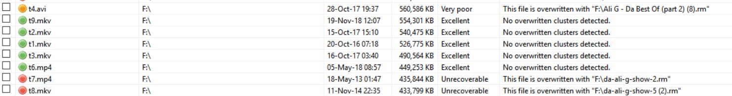

Ok, so I did a similar test again, I copied some random files onto a 2TB hard disk which had around 4GB of free space till there was a few MB remaining. then I deleted those random files. After that I again filled up the free space with some new files till there were a few MB remaining.
however, note that after that in recuva, I can recover a 47mb file! the file works fine.
File comment: 47Mb file recoverable with only 4Mb of free space on the drive?
where is the extra space coming from? Is it reserved by windows, or does it have something to do with reserved sectors?

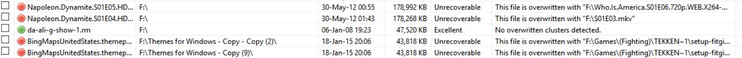

This is even stranger. I have 17Mb free, yet I can recover over 2Gb of data!

 Post subject: Re: Does a hdd store more data than what is reported as free
PostPosted: April 5th, 2019, 17:53
Posts: 17323
Each file is associated with metadata which define the file's properties, eg its name, size, location, creation date. I haven't studied NTFS in depth, but I suspect that these metadata may not be completely deleted when the associated file is deleted. At least this is the case with FAT file systems. If so, then the data recovery software may be overestimating the total recovered capacity by including these defunct metadata in its calculations. This means that any overwritten area could be included two or more times. Of course, any recovered file which incorporates overwritten areas will be corrupt.
PostPosted: April 13th, 2019, 2:20
Posts: 309
Location: France
However this case is most likely caused by excessive optimism of Recuva.
Actually Recuva has the very rare feature of assessing the state of each file detected during the filesystem analysis, and displaying messages like “no overwritten clusters detected” (in this case the file is generally 100% valid – although this assessment is not 100% reliable) or “this file is overwritten with XXXX.XXX" (in this case the file is most likely corrupted – but can still be readable if at least the begining is valid). Those messages are visible on the “Clipboard02.jpg” screenshot above (by the way PNG should be preferred for that kind of screenshot, better quality and sometimes smaller size).
I saw 50 60 Tb or more for 1 tb drives.
Recovery Softwares calculating file size properties from file list tables that found when searching I guess. Not meaning that files not damaged. If you try to recover all that huge amount files, you would see mostly damaged files except Healy files.
This is especially true when enabling “raw file carving” with all possible file types checked (see what I just wrote in that other thread). Indeed, most of those files will be garbage – and some of them can be insanely HUGE. (Don't know what you mean by "healy files" though.)
