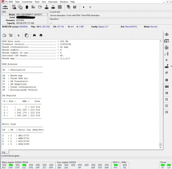

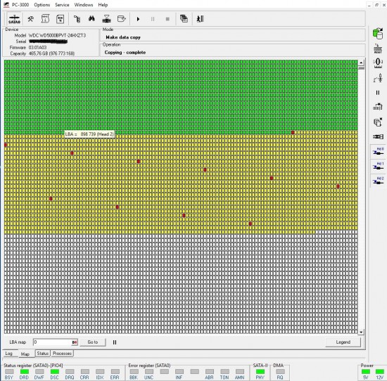

Thank you DDRecovery for replay.

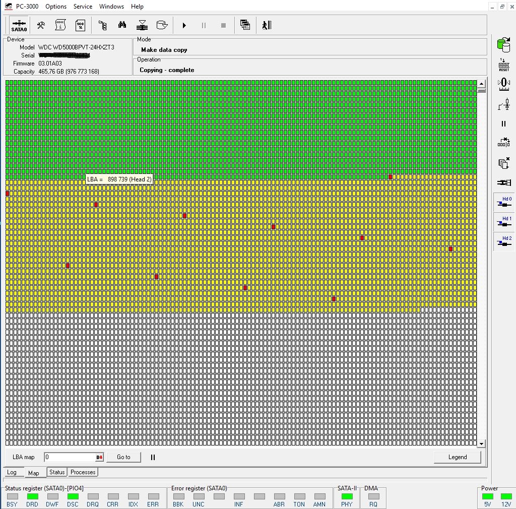

Posts: 396
Location: slovenija
Thank you Jared and Einstein9 for help.
I try to image by selective head without success.
It read from 0 to 890049. I can see that read from head 0, then from head 1 and finally from head 2. When come to 890049 with head 2 stop reading.
Behaveor with original heads and with donor heads is same.
If I raw recovery what it read I can see files.
Also under DE it show drive with all partitions, but then is problem to access partitions data.

I test all heds under PC3000 and all passed test.
I can Access cestors from 0 to 899263(that is the amount of data, which DE read. After 899263 sectors are not accesible.

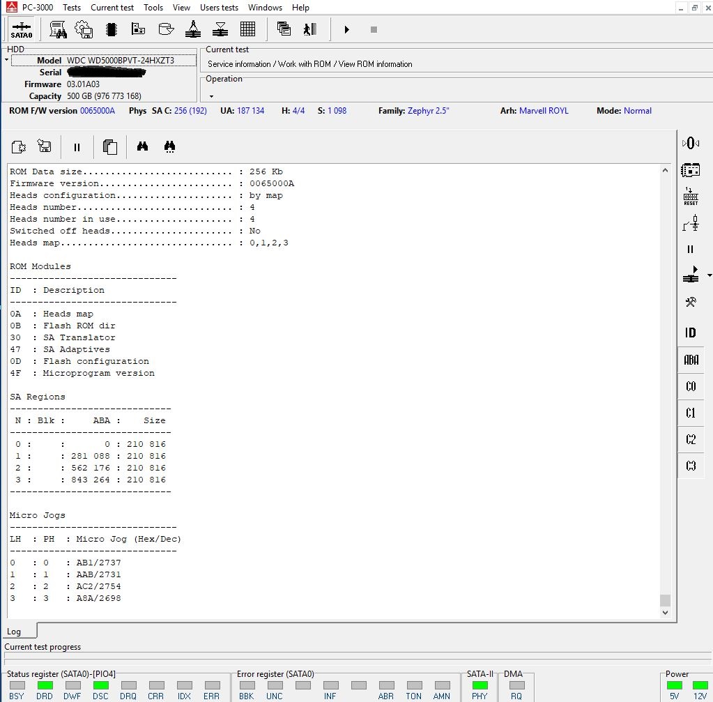

@jerovsek, could you upload your ROM? I'm curious as to why one tool reports 4 in-use heads while the other reports 3. Would it be worthwhile to compare the patient and donor resource dumps?
 Post subject: Re: WD5000BPVT-24HXZT3
PostPosted: March 25th, 2019, 4:15
Posts: 396
Location: slovenija
Hello Mr. Zabkar,
I work with PC3000.
WD Marwell utility show 4/4 heads with original PCB. In Data Extractor whiich is part of PC3000 it show only 3 heads.
When I write ROM and ROM moduls to donor PCB WD Marwel show 4/4 and also under DE I see 4 heads.
But with original PCB or with donor PCB I can Access only sectors from 0 to 899263.
It looks like something is wrong with translator.
Techno mode key
Techno mode key......................... : Ok
RAM:
HDD Info reading........................ : Ok
Heads number............................ : 4
Cyl Count............................... : 256
Zone allocation table................... : Ok
SA SPT.................................. : 1098
ROM:
Read ROM................................ : Ok
ROM Data size........................... : 256 Kb
Flash ROM dir reading................... : Ok
SA regions address...................... : by default
SA regions address (RAM)................ : by default
Module 02 access........................ : Granted
SA Translator loading................... : Ok
ROM Modules:
ROM version............................. : 65.0AE
ROM F/W version......................... : 0065000A
Overlay F/W version..................... : 65.0AE
Servo F/W version....................... : 05.0C
Heads number in use..................... : 4
Switched off heads...................... : No
Heads map............................... : 0,1,2,3
Service area:
SA dir reading (ID)..................... : Ok
SA Access............................... : Copy 0,Copy 1,Copy 2,Copy 3
Configuration reading................... : Ok
Master Password......................... : has not been set
User Password........................... : has not been set
