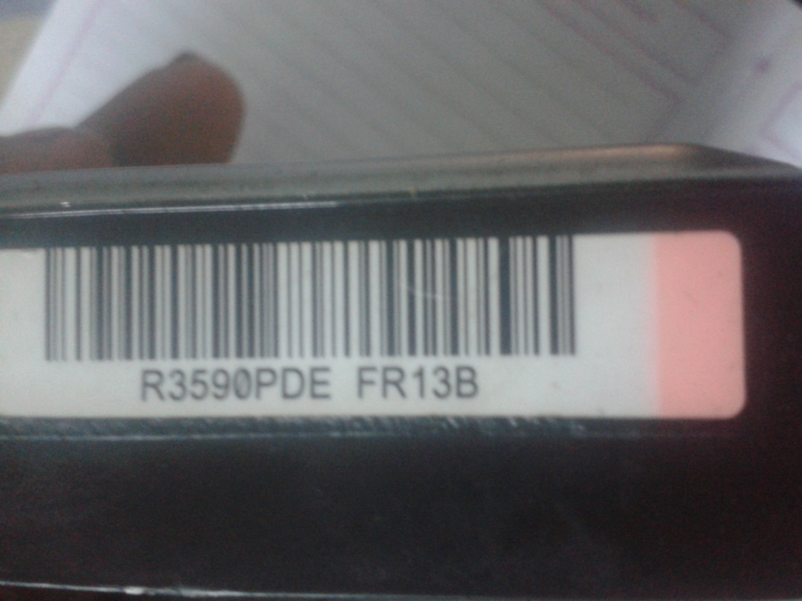

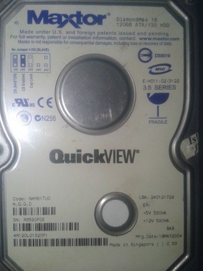

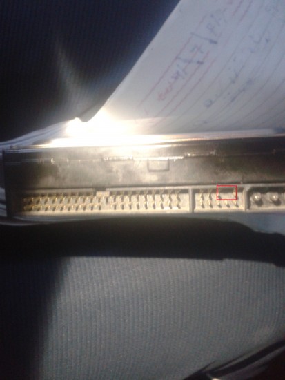

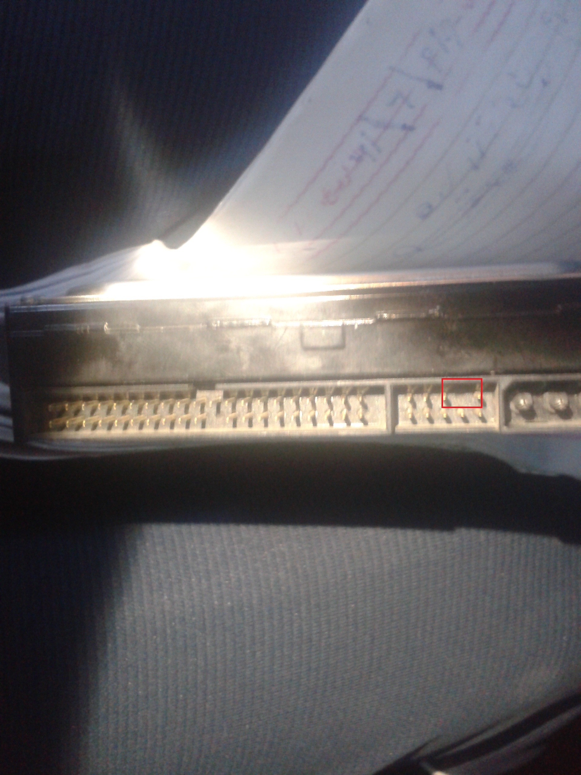

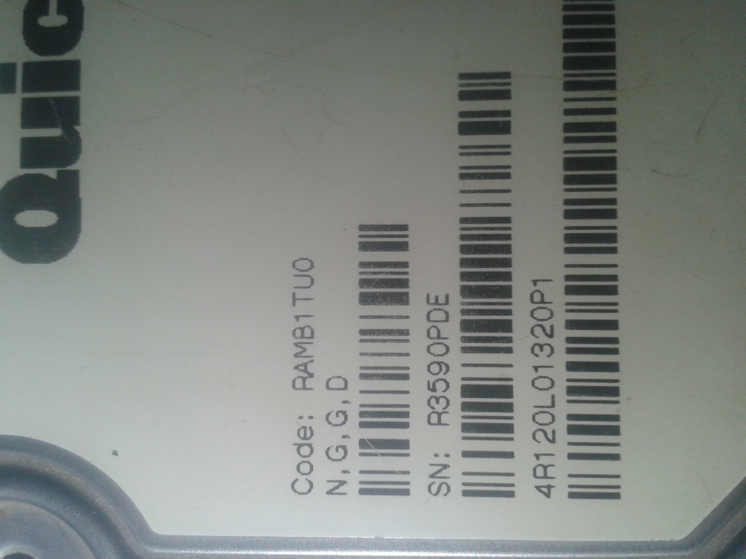

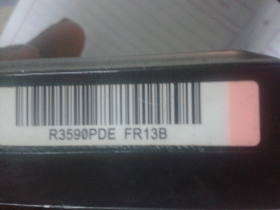

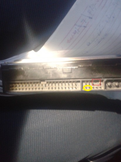

We're missing the Toshiba serial port connector for a 3.5" IDE drive. Does anyone have the pinout of GND, TX and RX on the HD, so I can connect it manually?
Thanks.

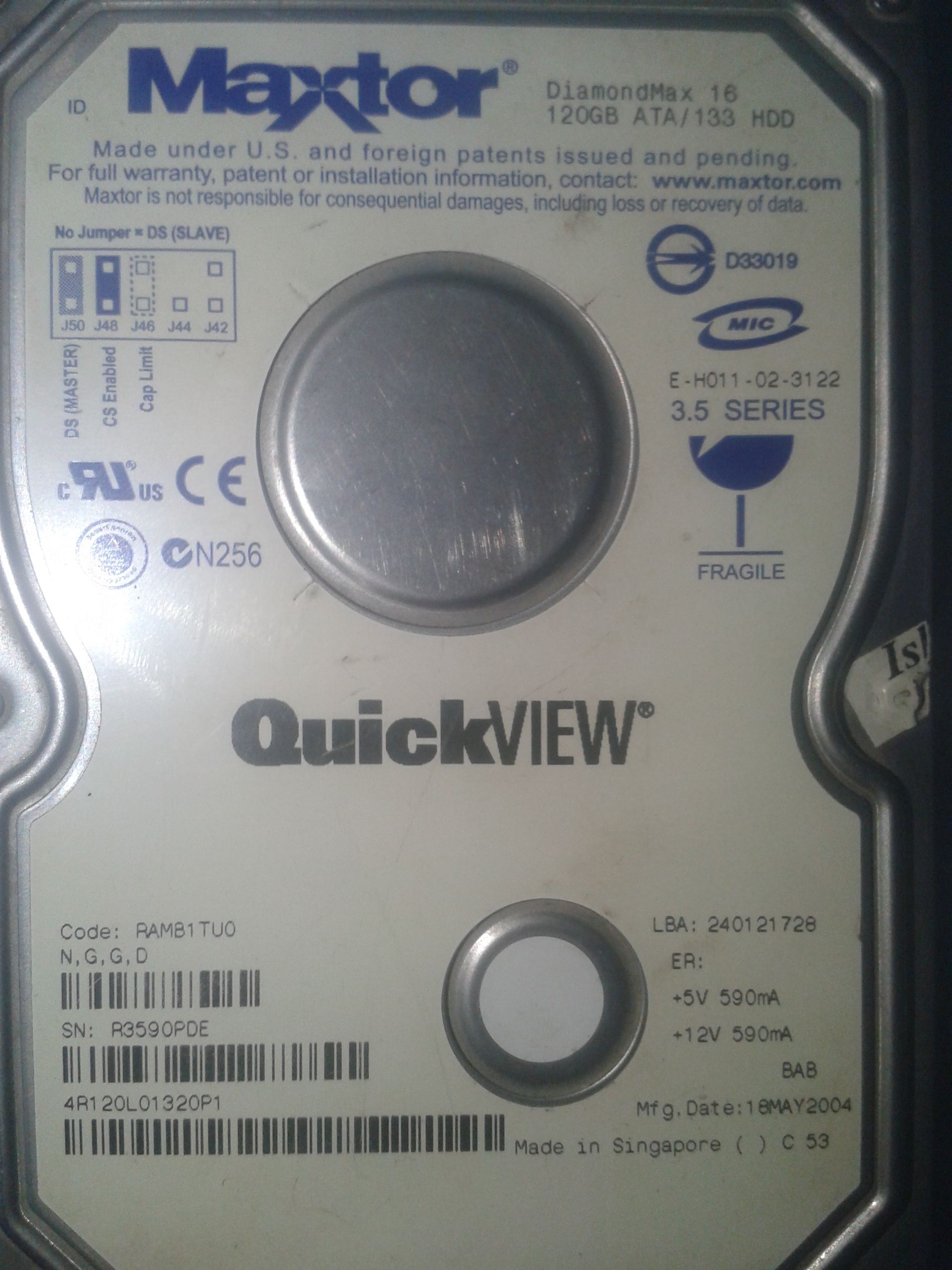

ddrecovery wrote:
Is that a Toshiba or a Maxtor?
Sorry for the errors Maxtor

I could be wrong here, but PC3000 does not manufacture a terminal connector for the Maxtor, so you might assume there is no Tx or Rx on these boards. You can however put the drive in safe mode using jumpers.

How to access safe mode
 Post subject: Re: Toshiba serial port connector
PostPosted: March 20th, 2019, 19:42
Posts: 1777
Location: Phoenix, AZ USA
Bottom left horizontally. See picture.
