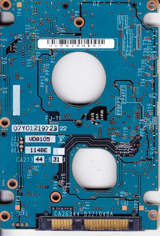

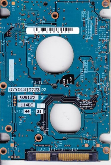

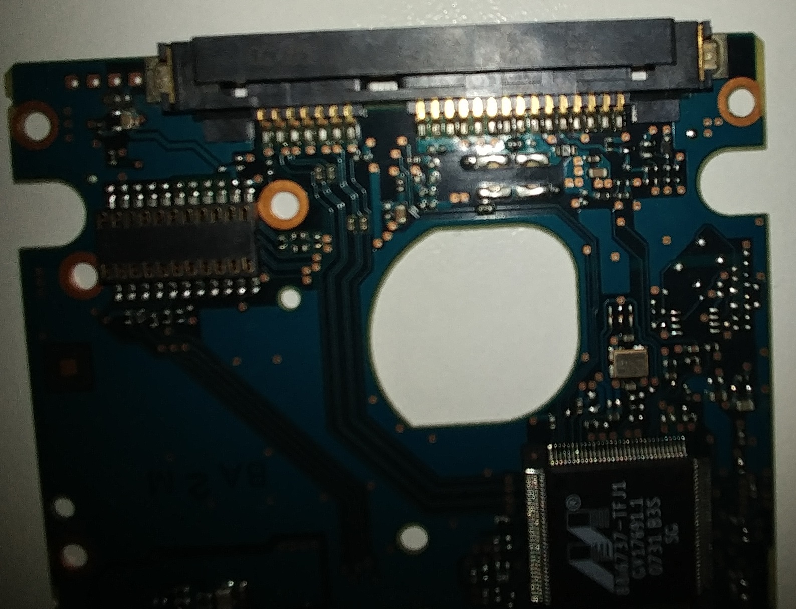

Hello
I have a Fujitsu drive that need to replace the PCB (Model: MHY2160BH, PN: PN: CA06889-B377000T)
The PCB doesn't contain an external ROM chip.
I found a PCB with same PCB REF (CA26344-B32104BA), same HDD model and same hdd PN.
- PC3000 support told me that its not enough and other numbers on white square on PCB need to match too (see patient PCB)
- DonorDrives told me that it should work (See donor drive)
Can anyone tell me please what are the criteria for Fujitsu PCB replacement to work?
Kind regards

 Post subject: Re: Fujitsu PCB compatibility criteria
PostPosted: April 10th, 2019, 5:59
Posts: 17232

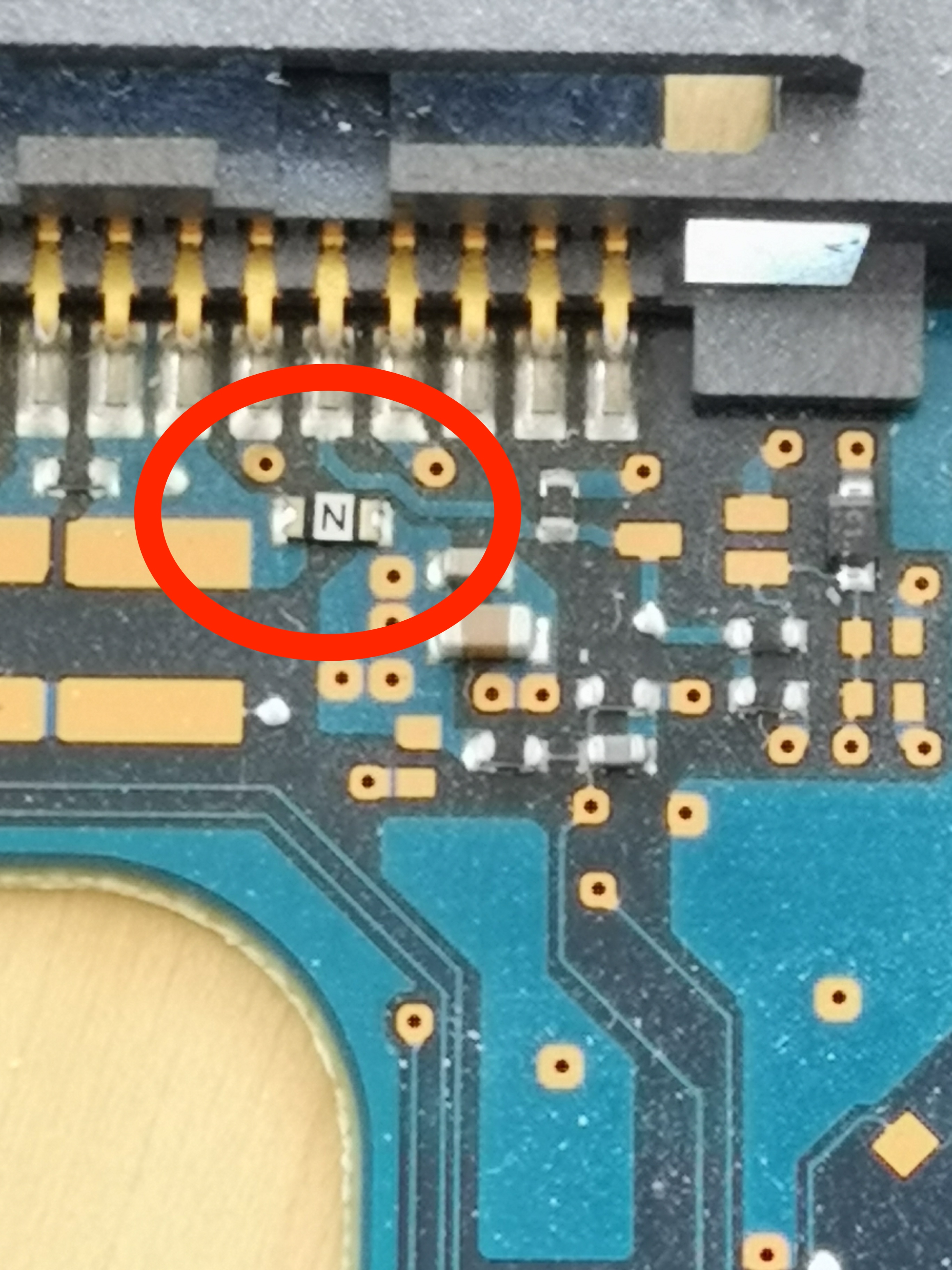

Did you check the fuse?

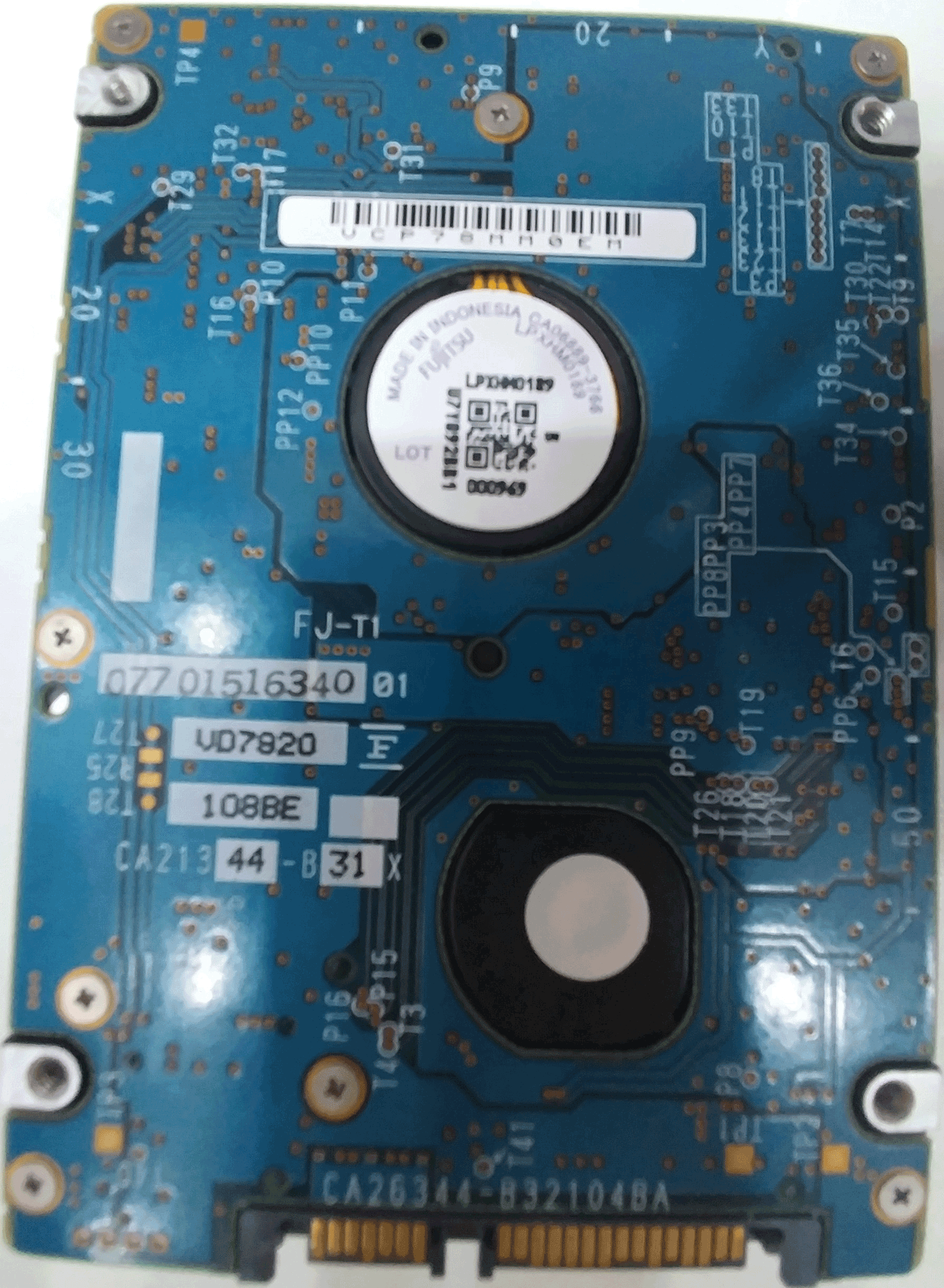

PostPosted: April 10th, 2019, 9:31
Joined: September 7th, 2012, 16:37
Posts: 197

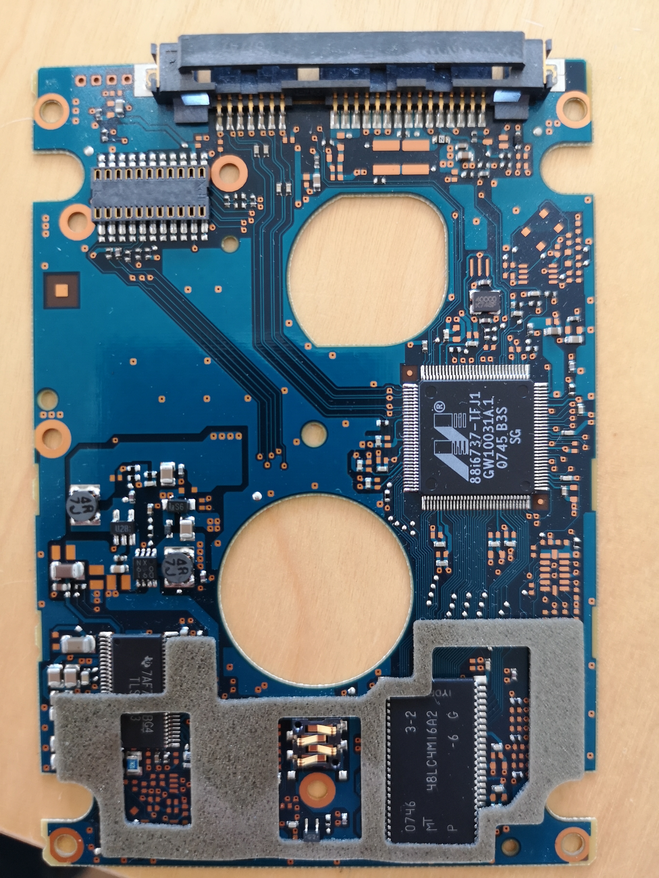

Dear fzabkar,
Thank you for your reply.
No i didn't. I didn't see/smell any smoke on the PCB. please see the PCB on the other side.
PostPosted: April 10th, 2019, 12:35
Posts: 849
You can use any PCB for the same model unless it has an external flash chip.
PostPosted: April 10th, 2019, 14:14
Joined: May 21st, 2007, 16:10
Posts: 1592
Location: Gothenburg/ Sweden
For new Pub, match 44 and 31
PostPosted: April 10th, 2019, 15:18
Posts: 197
Spildit wrote:
Why do you think the PCB needs to be replaced ? Do the drive spin at all ? If it doesn't spin can you ear any noise at all from the drive ?
Drive doesn't spin and there is no noise.
When I plug it to PC3000, and power ON, BSY light is OFF
PostPosted: April 10th, 2019, 15:35
It’s a poor photo, and I’m not at work to check a PCB.
That coupled with fat fingers on an iPad to edit the photo doesn’t make for an accurate edit of the photo, but I think this is the fuse (or a zero ohm resistor). Black component with a white “O” on it.
Check it for continuity....
PostPosted: April 11th, 2019, 3:06
Posts: 197

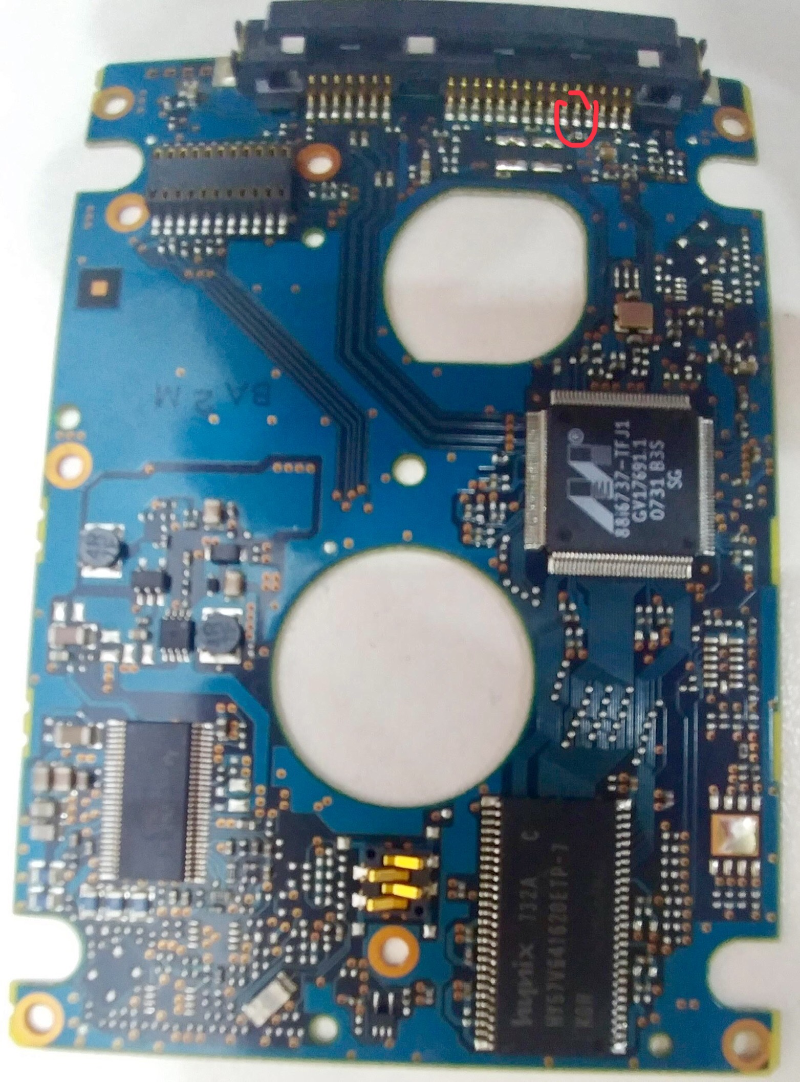

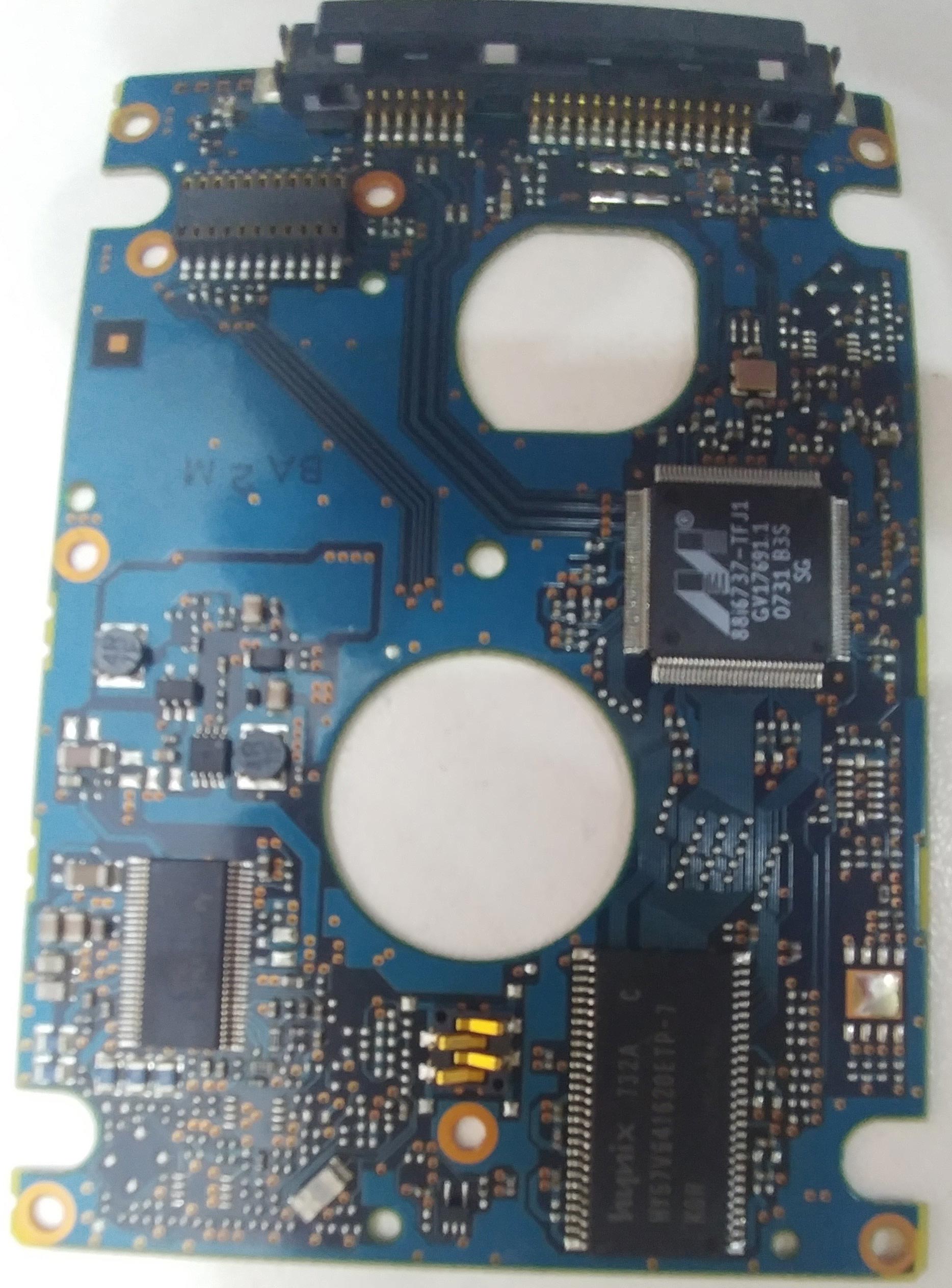

I re-checked that part of the PCB, it looks good.

Did you measure that part? not just looked at it?
