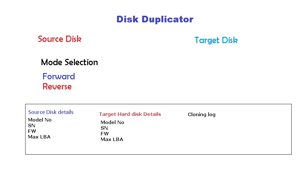

 Post subject: Re: Hard disk cloning Hardware
PostPosted: January 28th, 2020, 4:18
Joined: March 9th, 2017, 6:16
Posts: 127
Location: trinidad
Good Attempt S.Haran
This type of dedicated cloner is useful for onsite cloning or any junior technician with basic knowledge can do cloning easily.
I want similar cloner (sector by sector mode only) for both SATA and IDE. I have heard that block cloning can be achieved by issuing ATA copy commands as well.
Selected source should get write protected for accidental overwrite
