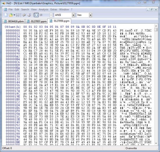

I have a Toshiba hdd. Customer have made Windows recover to old laptop hdd.
New windows have made a new D partition. And he lost all data.
I have searched with RStudio.
But there aren't any known files and any old partitions.. Found some kind of big files that has PBM PGM PPM ... extensions. Tried to search with some another programs. Same.
I leave searched in Hex NFTS, EXIF , and some different things. I cannot find anything.
Searched internet. Says PBM PGM PPM are some graphic or picture format. I tried to open it. But not opening. Also guessed it was image files. Searched file by file. . Nothing . Guessed compressed file. WinRAR not opening.
I tried to remove HDD password and unlock with MRT. Nothing changed.
I have some more hdd for my experience. There are Some hdd has some situations.
I have a hdd had bit locker. RStudio finding same extension files .
My guess this hdd encrypted with bit locker.
Anyone has advice . What is that files. And how can I recover them

can you open one each file type with HxD and post screenshot of file from 0x0 ?

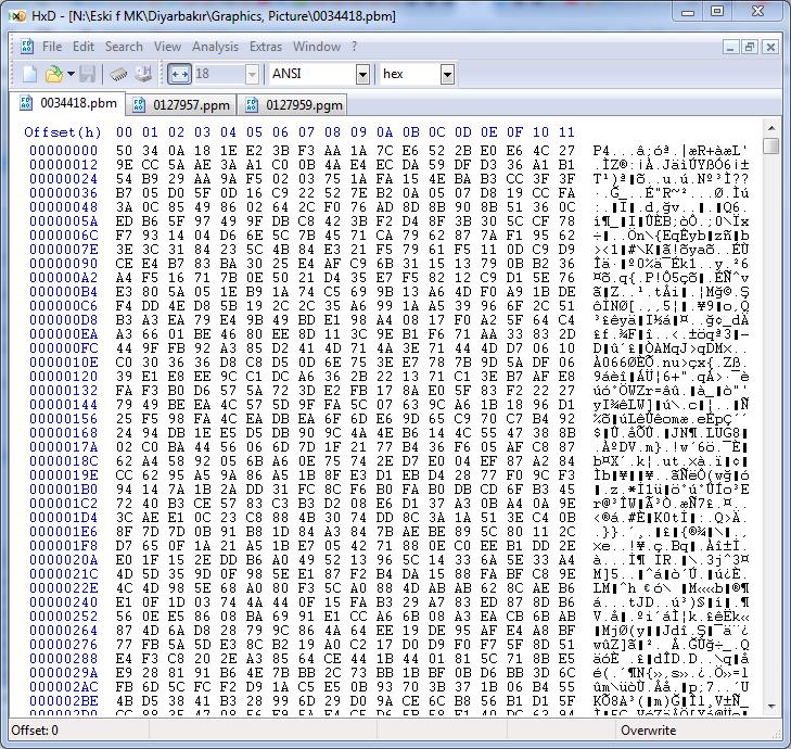

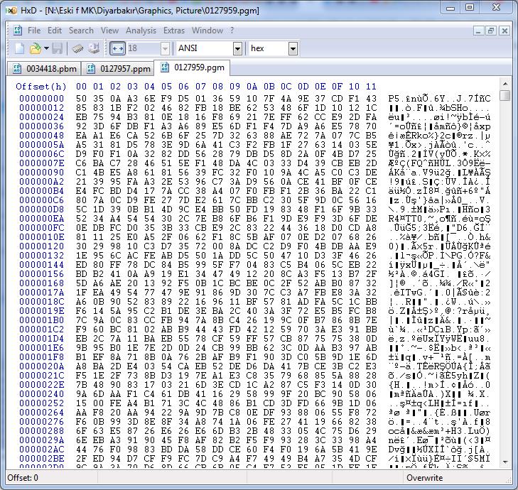

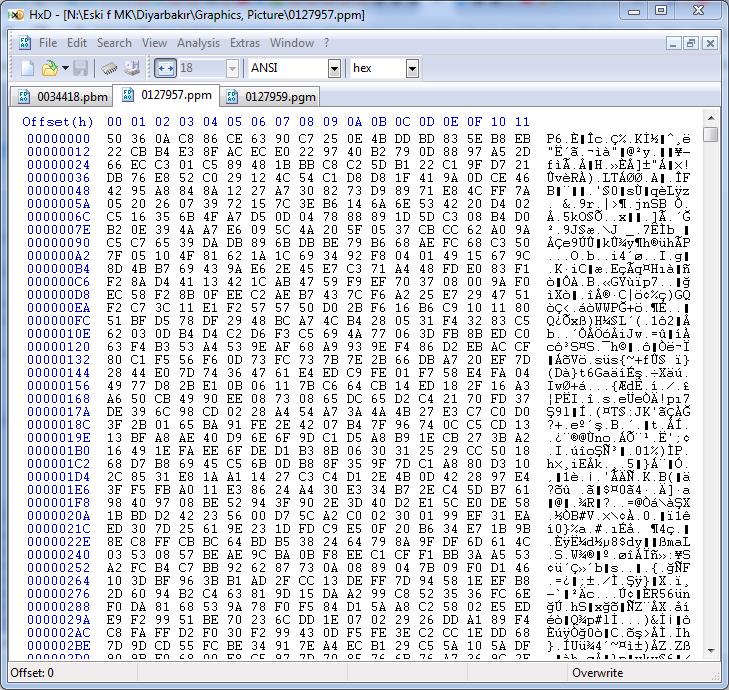

PPM
PGM
PBM

Hi, Googling for: PPM PBM PGM format
https://en.wikipedia.org/wiki/Netpbm_format
http://paulbourke.net/dataformats/ppm/
I haven't looked to see if files match these specs or not, but magic number appears to be about right.
if files are intact, the utility at second link may be able to save files in another format to better use them.
what folder were they in, or where were the files found relating to user file saving locations / OS worker files / Application specific folders? An application installed on the PC may provide some insight in what the files are for etc.

Spildit wrote:
Ok, here :
HddDonorMarket wrote:
- I have a Toshiba hdd.
-Customer have made Windows recover to old laptop hdd.
- New windows have made a new D partition. And he lost all data.
-I tried to remove HDD password and unlock with MRT. Nothing changed.
-I have a hdd had bit locker.
-My guess this hdd encrypted with bit locker.
1 - If a drive is LOCKED with ATA PASSWOR you will NOT HAVE any ACCESS TO LBA. Unlocking the HDD with MRT will do nothing. Drive was already unlocked to start with.
2 - Ask client if bitlocker was used and ask for bitlocker key.
3 - Your sectors are random garbage and not actual pictures. Data IS ENCRYPTED with 3rd party tools like Bitlocker, Truecrypt, etc.
4 - Re-Installing from the recovery CDs, etc did wipe the encryption keys and setting/partitons, etc ... so you are in for PAIN ...
5 - Most likely it's un-recoverable unless you can :
- Do a full clone
- Try to force full decryption with RepairBDE - http://www.hddoracle.com/viewtopic.php?f=94&t=542
- Use logic recovery ....
But most likely keys are gone and data is encrypted forever and un-recoverable ...
Thanks. I will send back this hdd to customer I guess.. But have at least another 2 hdd (garbage ) in my stock. Look like Same case. I will try with them.
