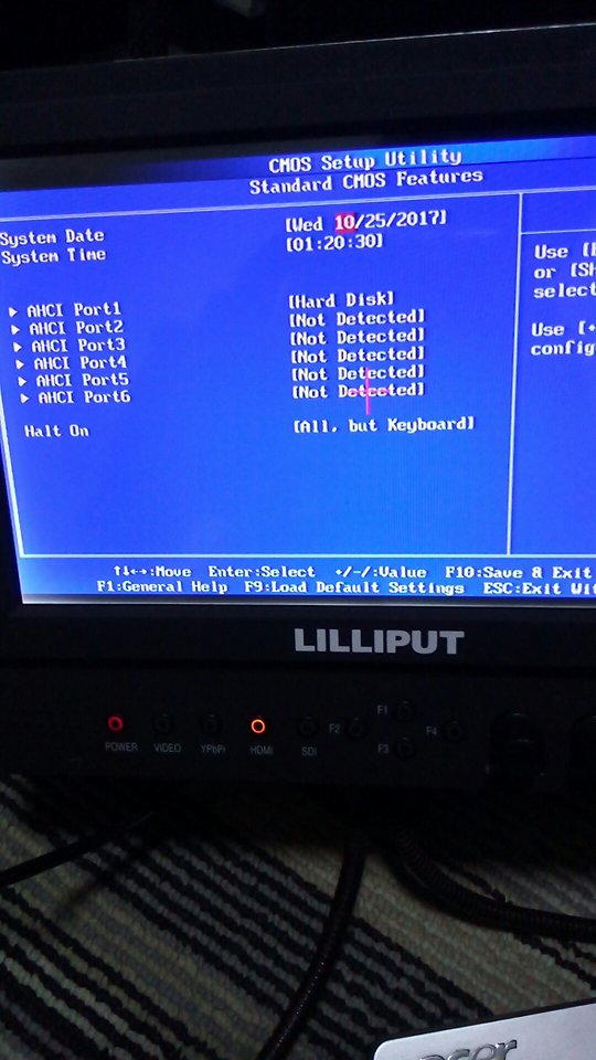

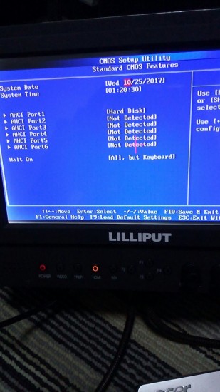

First of all , i also have same problem with Seagate 4 T external hard drive.
When i connect directly to SATA, there is still not see in BIOS as port 2 not dected.
2. Hard disk is spining but not with strange sound. Light is on.
Should i change pcb or any firmware problem?
What should i do more for recovery datas from these harddisk.

 Post subject: Re: Seagate 4 TB backup plus not being detected
PostPosted: October 25th, 2017, 18:20
Joined: October 23rd, 2017, 11:44
Posts: 6
Location: Yangon
PostPosted: October 25th, 2017, 18:25
Posts: 1388
Location: isreal
we need to see the terminal log
not a screenshot from the BIOS
