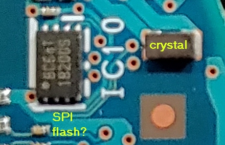

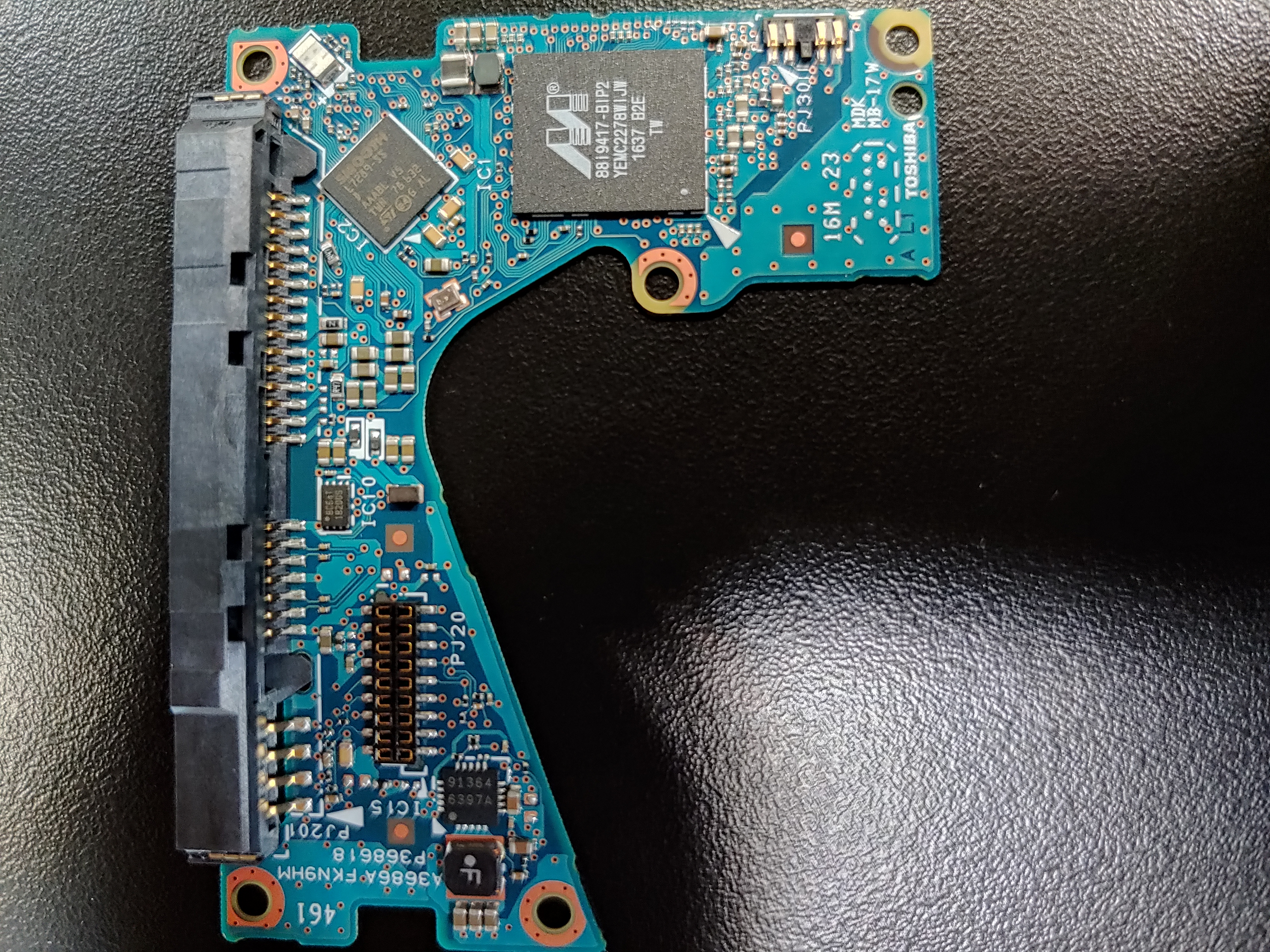

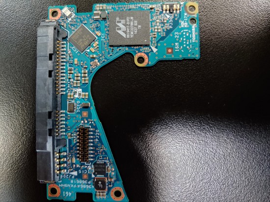

Tried to do a hot swap, but the donor is password protected and im running out of time for recovery. Ive replaced regular standard bios chips and motor chips but those are for boards I know and I havent encountered this with Toshiba yet. Id appreciate any help that could be provided in finding out the possibility in replacing bios I would be very thankful.
Donor

What are the markings on the 8-pin IC at IC10?

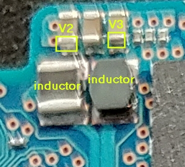

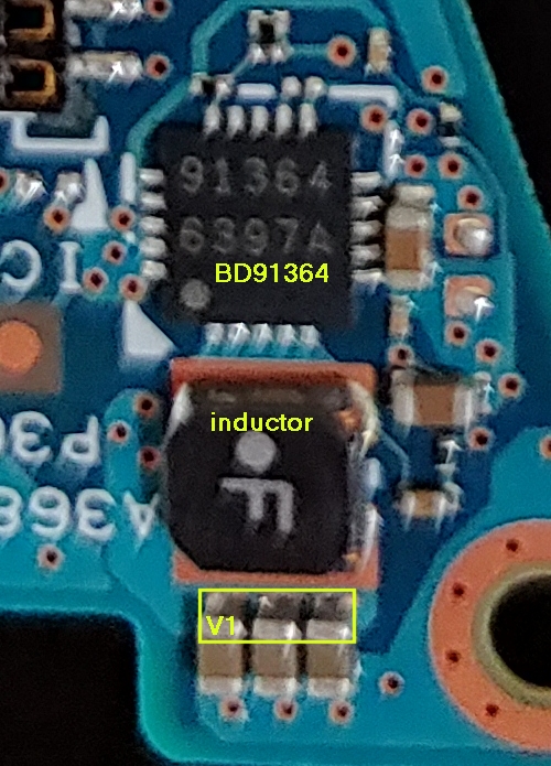

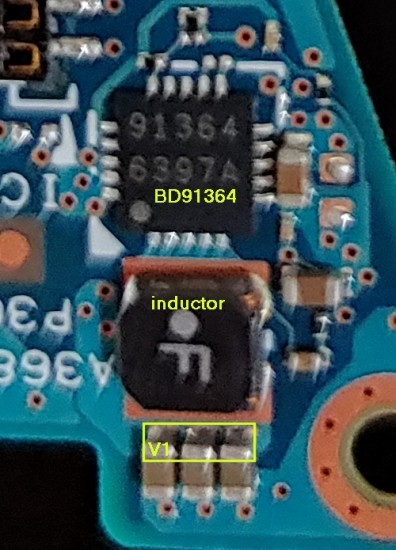

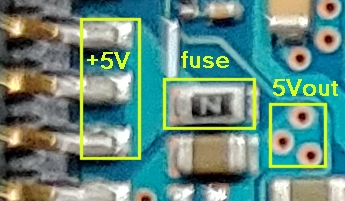

I have attached the voltage test points.

Error: The component I have labelled as a crystal appears to be something else. Sorry.

Drive does spin up and seek and get drive info, however once I try to do anything past that I loose power. I will test those points mentioned and post them.

Alright, after clearing glist so far so good however chip for motor is getting a bit on the hot side, but hopefully I can limp it along for recovery, if not I will get a better replacement. Normally I deal with wd and sometimes seagate so this was a bit foreign to me. Thank you for your information over this.
