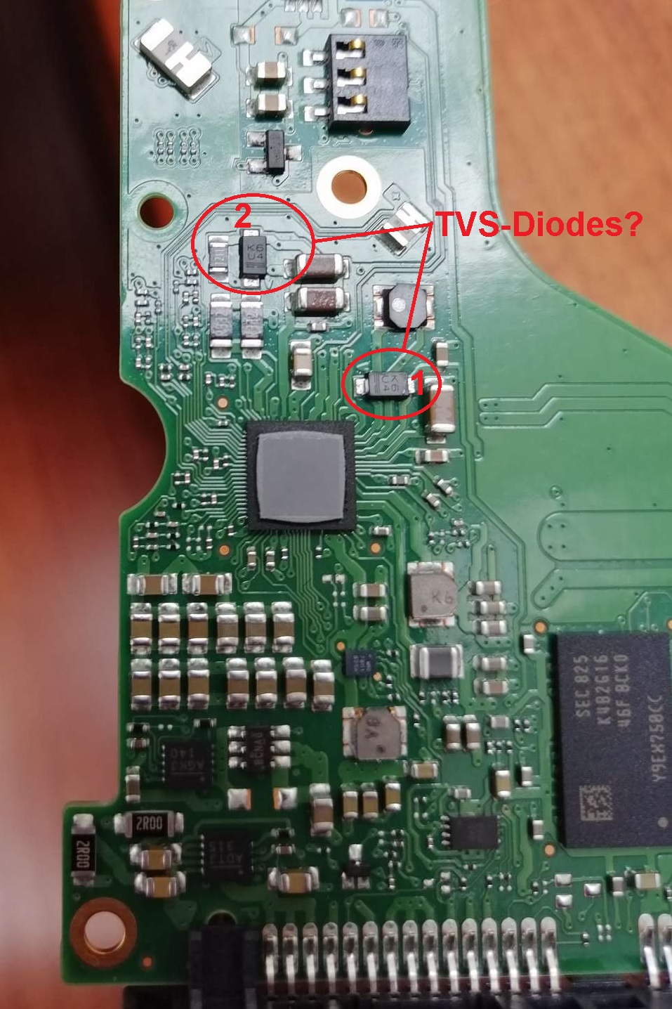

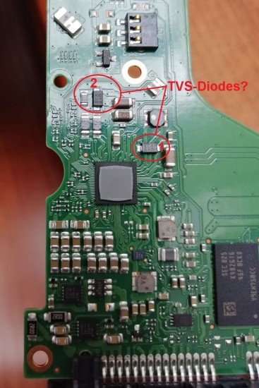

1) Attached is a photo of the PCB and the parts i identified as TVS-Diodes.
The reading on the chips says "K6U4..."
Is my assumption correct?
2) Attaching my cheap Multimeter and doing a diode test i get the following readings.
Diode 1:
Direction 1: 195 (i believe it's mV)
Direction 2: 1
Diode 2:
Direction 1: 195
Direction 2: 826
So they act differently?
And Diode 2 doesn't "block" in Direction 2?
So i can assume it's faulty?

Those are not TVS diodes. Do NOT remove them.
There are two electronic fuses marked "ADTJ" and "AGKJ".
Measure the resistance between +12V and ground, and +5V and ground.

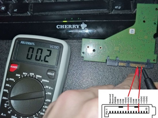

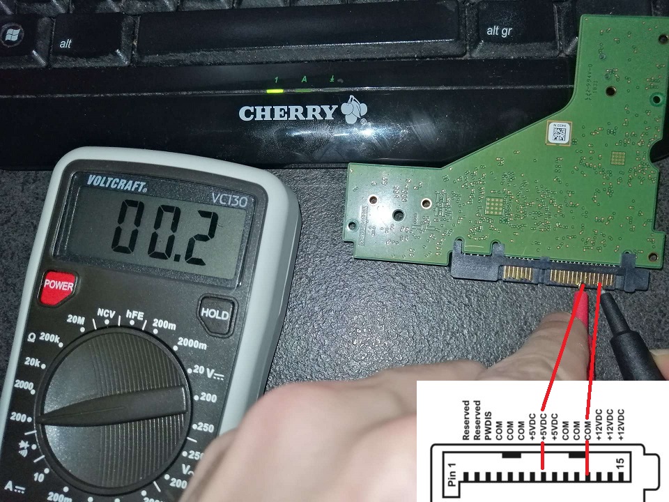

I suppose you want me to do this:
I used the Sata Pinout in the image above.
When i measure any of the 12V Pins with any of the ground pins i don't get a reading. Display stays at the default value "1".
When i measured the resistance between any of the 5V Pins and any of the Ground Pins it says "0.2" (which is the same as when i connect the testing probes directly).
Means i have a short on the 5V line?
Thanks so far.
 Post subject: Re: Ironwolf Nas 8TB internal SATA - PCB Dead?
PostPosted: May 7th, 2019, 18:16
Posts: 17230
Yes, there is a short at the +5V input to the drive. Now we need to find the shorted component(s).

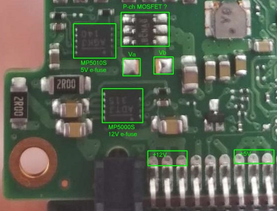

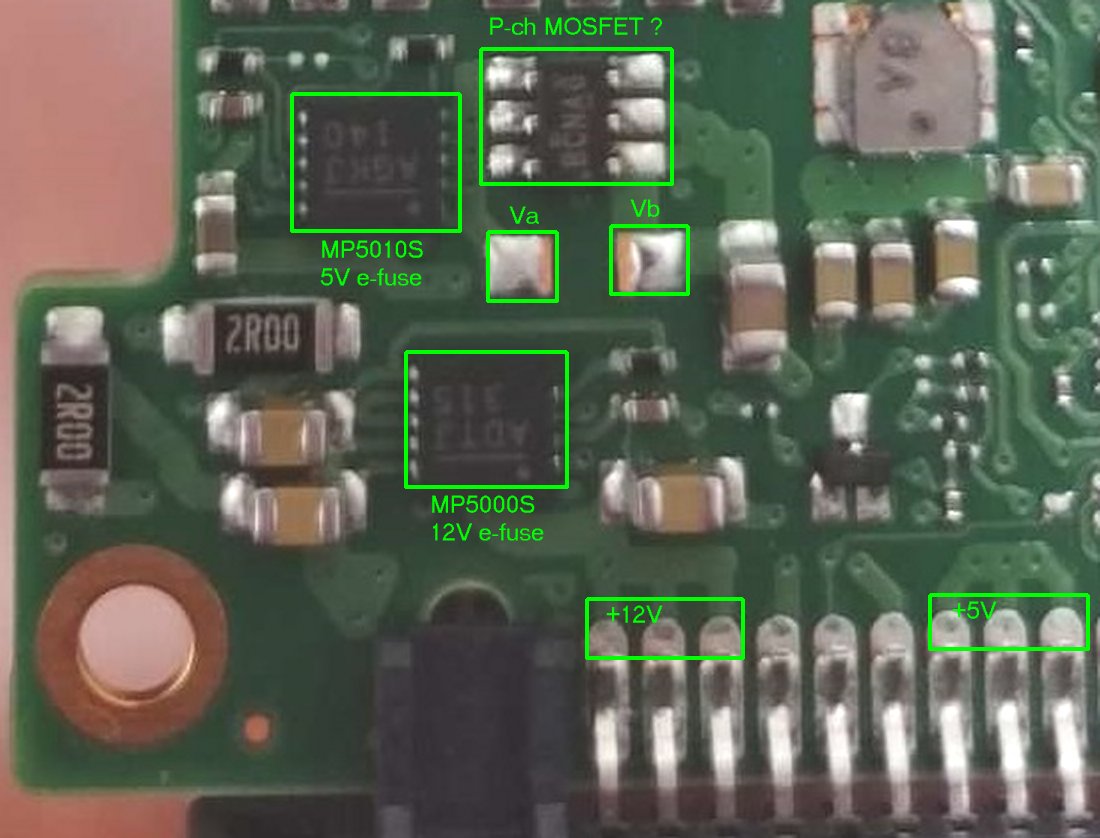

The 10-pin AGKJ chip is a 5V e-fuse. At its bottom right corner are two unpopulated square pads. Measure the resistance between each pad and ground.
PostPosted: May 7th, 2019, 20:03
Posts: 17230
Measure the resistances between ground and each of Va and Vb.
MP5000S, Monolithic Power, 12V, 1A - 5A Programmable Current Limit Switch, marking ADT, QFN10:
https://www.monolithicpower.com/DesktopModules/DocumentManage/API/Document/GetDocument?id=1399
MP5010S, Monolithic Power, 5V, 1A - 5A Programmable Current Limit Switch, marking AGK, QFN10:
https://www.monolithicpower.com/DesktopModules/DocumentManage/API/Document/GetDocument?id=1422

Measuring the resistance between Ground and Va and Vb yields "1" (OL) (200 Ohm-mode).
Measuring on a higher mode (200k Ohm) yields values around 110 kOhm for Va,
and 199 kOhm for Vb.
PostPosted: May 8th, 2019, 4:53
Posts: 17230
The 5V e-fuse IC is shorted. I would first check the output of your PSU.
You can choose to replace the fuse, or you can remove it and bridge it, but you must ensure that your PSU is good.
This is the latest link to the datasheet:
https://www.monolithicpower.com/en/documentview/productdocument/index/doc_url/L01QNTAxMFNfcjEuMC5wZGY/prod_id/NDE3/
Edit: One other possible culprit is the capacitor to the left of the IC.

I would cut the ground pin of the e-fuse with flush cutters, and then see if the short circuit persists. If the short is still present, then examine the capacitor. Or you could cut the capacitor first and retest for a short.
If the e-fuse is shorted, then cut all its pins and run a wire from SATA +5V to Va. This will isolate the e-fuse and bypass it.
