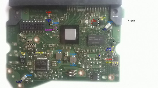

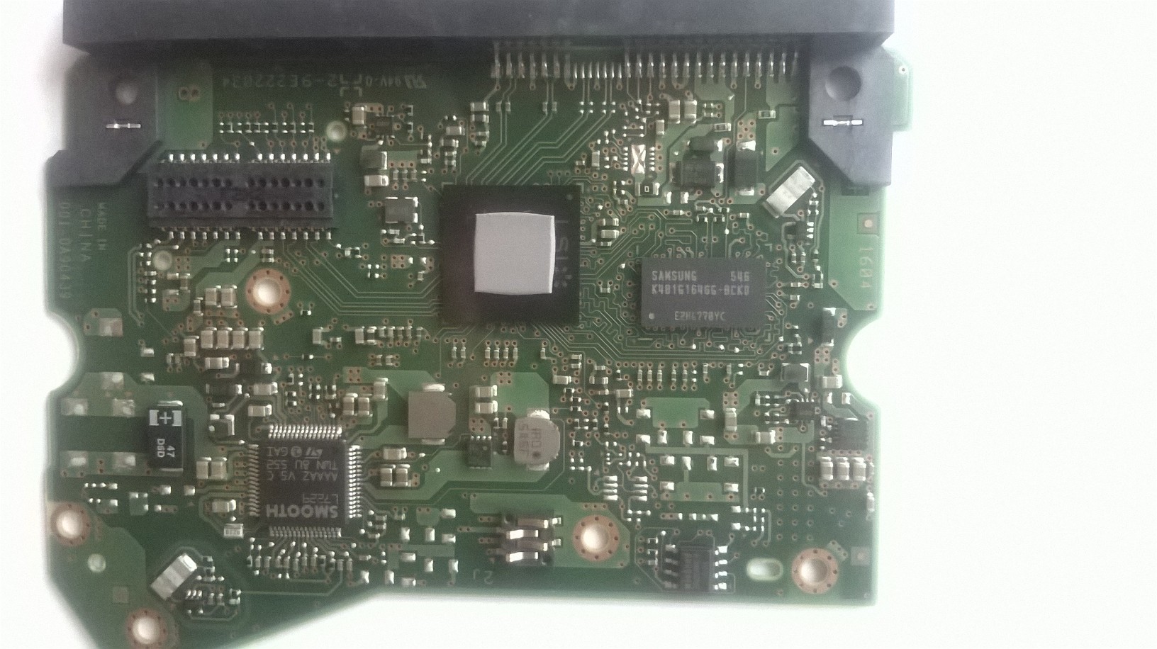

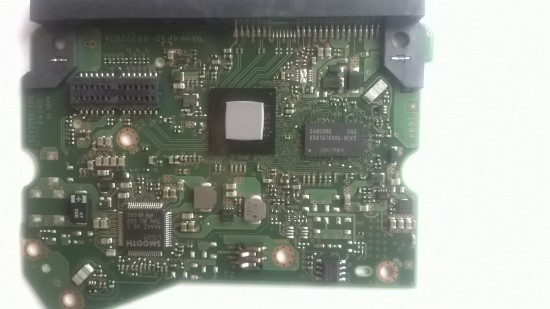

i've this hard drive with faulty pcb:
WD80EZZX-11CSGA0
P/N: 2W10100
PCB Revision: 0A90439
PCB Sticker: 0J35276 BA5145B
this is an HGST helium drive, pcb has damaged SMOOTH L7229 chip.
I can't find this pcb anywhere, could any of you kindly lend me this PCB or at least help me to find it?
Thank you.

I'm curious. Where is the damage to the SMOOTH chip? Are either of the TVS diodes shorted?
 Post subject: Re: PCB 0J35276 BA5145B for WD80EZZX-11CSGA0
PostPosted: May 10th, 2019, 19:09
Posts: 1768
Location: Verona, Italy
No Frank, TVS diodes are not shorted.
The drive just doesn't spin, it's completely silent.

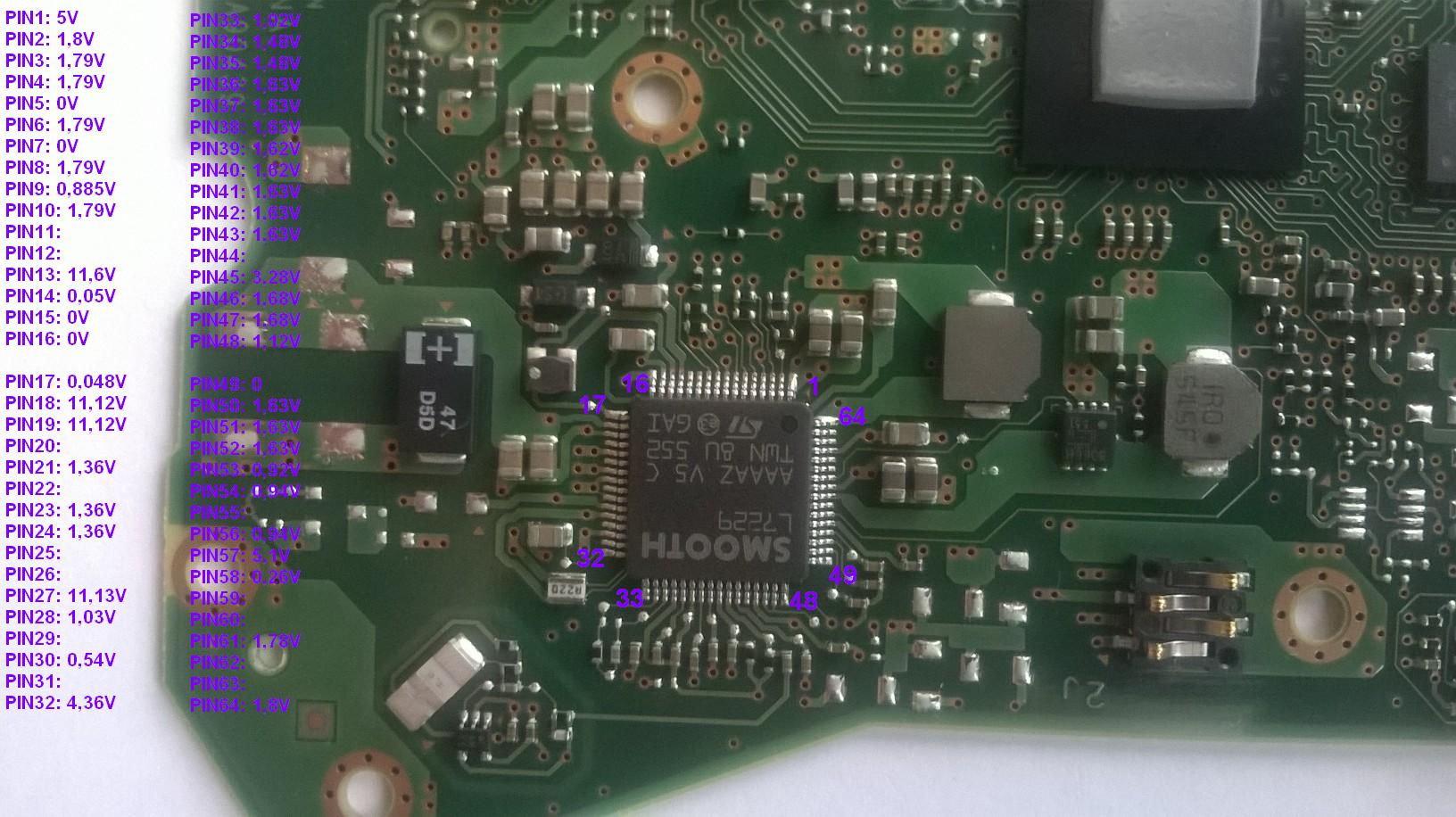

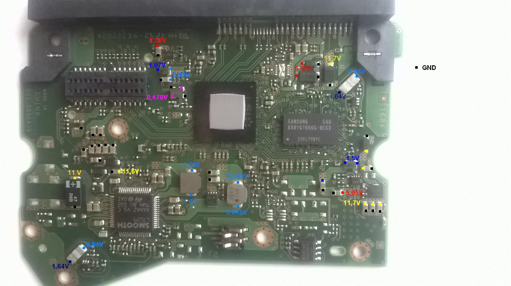

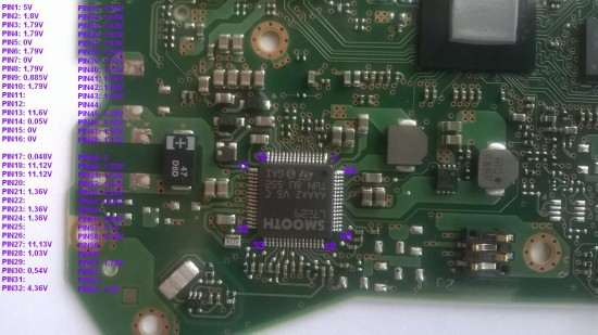

This hard drive came here with no power on issue (it was completely silent).
I thought pcb was faulty so i did some test...
First i did power on under MRT, ID was correct and DRD + DSC registers where green.
Then i started to do some signal checking with multimeter, see pics:
After that i power off and went to have lunch, when i came back to continue with further test, smooth chip smoked right away when i powered on. :(
