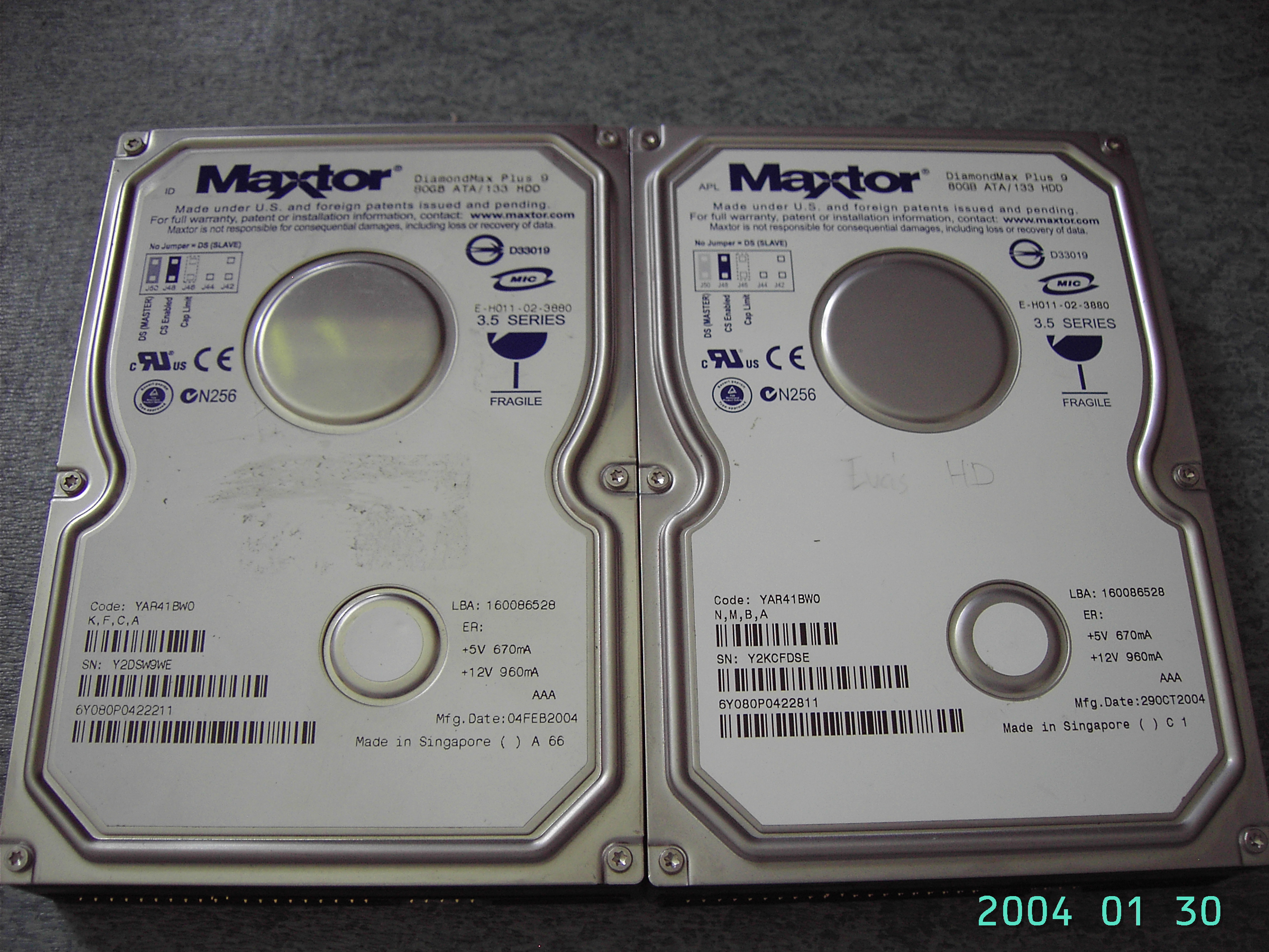

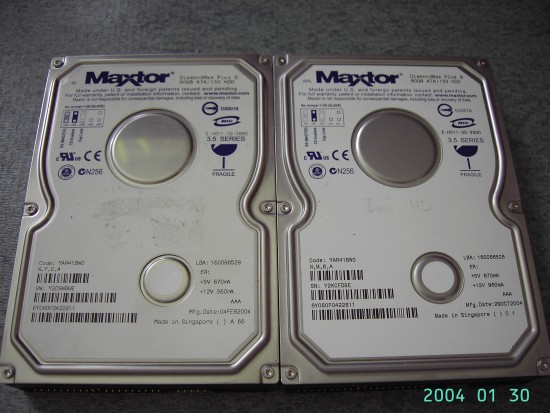

Here are the two HD that I use. The one to the left is working and the one to the right is the one that was "fried". From what I understand they shpould be similar as they have the same chip on the pcb and same number on the front.

6Y080P0422811
You need to find a driver with matching number 28, your donor drive has number 22 so probably it's not compatible.
Get one with number 28 to be sure.
6Y080P0xx28xx (xx = not important)
or find a pcb with matching sticker number and same MCU number, pcb number looks like "D6FYA"

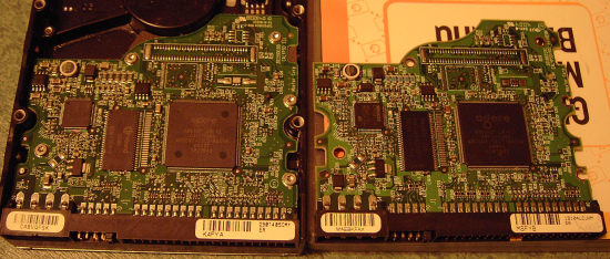

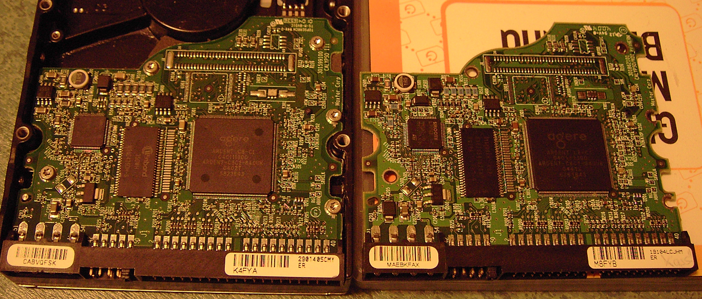

Here is a picture of the two pcb's, the one to the right is the "fried" one that I replaced with the left one.

However donor pcb is not compatible, the original pcb has code "M8FYB", the donor has code "K4FYA".
Also MCU chip on original pcb has code 040111800, donor MCU seem to be 040111500 (difficult to see).

The large agere chip is marked with 040111300 on both pcb's so that chip is the same on both pcb's.

mcu number is the same but different pcb code, so maybe this is the problem (assuming that the preamp is not damaged).
You have to find the proper donor pcb, the best way is to find a donor drive with:
identical firmware (YAR41BW0)
s/n: Y2xxxxxx (xx = not important)
PCB: M8FYB with mcu 040111300
then swap pcb, if still doesn't work then it would mean that head pre-amp is fried.
