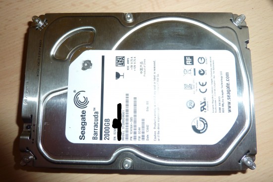

Hi @ all.

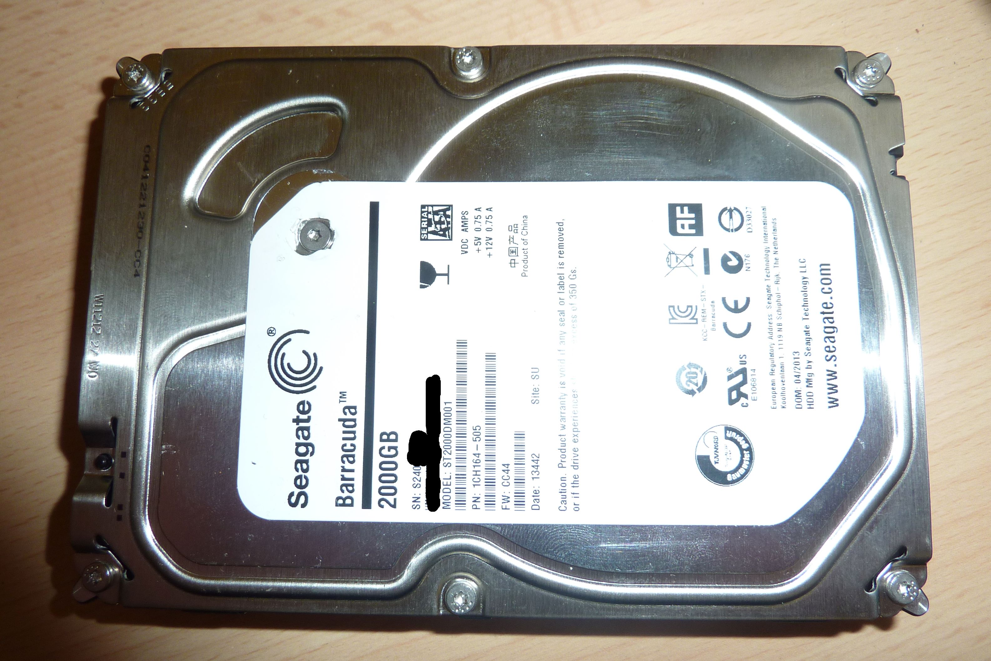

Today i have a damaged Seagate ST2000DM001. The drive spins up ... chirp, click, chirp, click ... spin down.
Terminal output is:
Boot 0x40M
Spin Up
FAIL  Servo Op=0100 Resp=0003
0100 0000 0000 0000 0000 0000 0000 0000 0000 0000 0000 0000 0000 0000 0000 0000 0000 0000 0000 0000 0000 0000 0000 0000 0000 0000 0000 0000 0000 0000 0000 0000
ResponseFrame 1B40 0046 03B4 4A80 0008 0000 0000 0000 0C07 0000 0000 0000 0000 0000 0000 0000 B787 070B 1754 9AFB 892A 6D6E F961 0017 2819 6F8A 0000 007F 0004 0000 0018 0004 0010
ResponseFrame 2300 0047 03B4 4B80 0008 0000 0000 0000 0BD4 0000 0000 0000 0000 0000 0000 0000 B787 070B 1754 9AFB 892A 6D6E F961 0017 2819 6F8A 0000 007F 0004 0000 0017 0004 0000
Drive IDs correct with serial/FW but wrong size.
On the top platter i found a spot (about 10mm) with dust of smoke, same spot inside the top cover. Platter has no visible scratches.
I think that this head is burned and suggest, that the preamp also died. (Hard drive enclosure is also dead, probably overvoltage)
Can anyone tell me how to determine/measure if the preamp is dead? I searched the PC3K docs and the forums but didn't find a howto for that.
At next step i'll try headswap. Is there any "save" workaround to clean the platter from this smoke-dust? Should i try to clean it at the moment of head-swap or after reading the data from the other heads? Whats the meaning of the experts here?
At least - i'm searching for the right donor - drive is a ST2000DM001 - SN: S240.... - FW: CC44 - PN: 1CH164-505 - Date: 13442 - if you have, please make an offer.

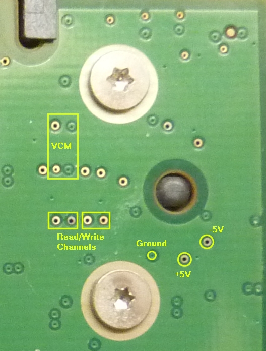

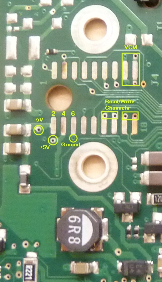

Does Ctrl-L report the preamp ID? If not, and if you upload the ROM dump, I could find the preamp ID for you.
Also, if you upload detailed photos of the HDD and bridge PCBs, I could help you to determine if the 5V supply rail was overwhelmed. I can't see any other way for the preamp to have been damaged, unless the motor controller failed and overvolted the preamp's negative supply rail. But then this would mean that the HDD PCB is a donor with the patient's ROM.
I could also show you the +5V and -5V test pins for the preamp. A resistance test may reveal whether the preamp is dead.
Still one more test would be to measure the read and write channel DC voltages when the drive is spinning.

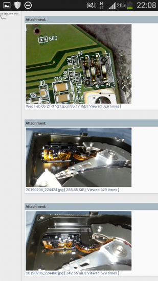

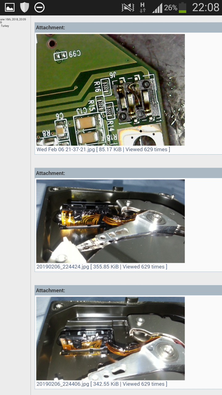

HddDonorMarket wrote:
This is real fun.
When my trying to learn something. I have isolated PCB. Then final in pictures.
Hdd not work after isolated. I guessed head problem. I felt bad smell. Lol. Opened hdd.
The attachment Wed Feb 06 21-37-21.jpg is no longer available
The attachment 20190206_224424.jpg is no longer available
The attachment 20190206_224406.jpg is no longer available
https://forum.hddguru.com/viewtopic.php?f=1&t=38177
Same issue? ?

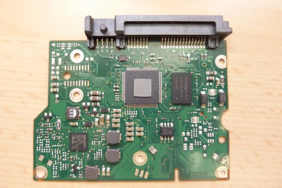

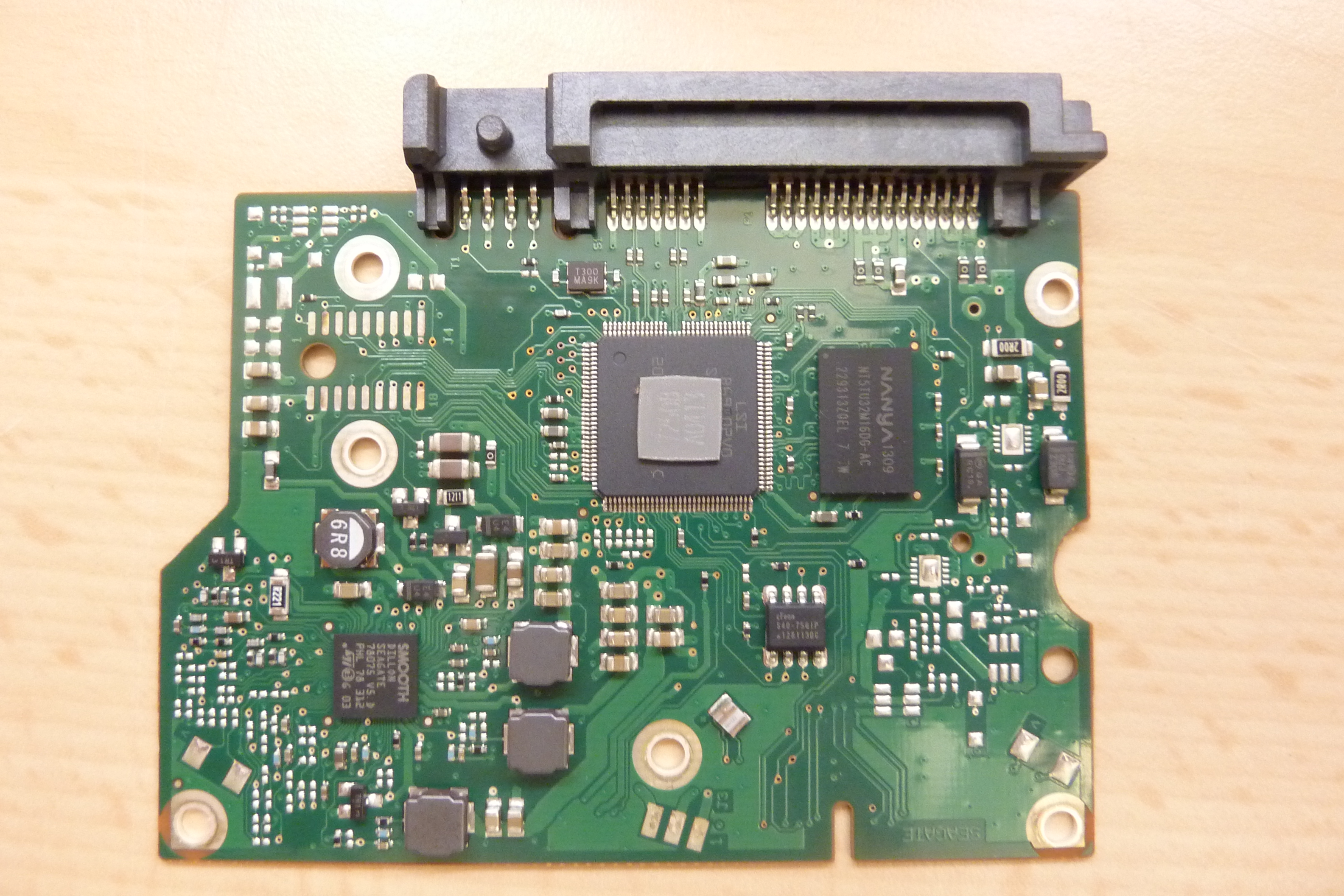

Otherwise, someone may be able to analyse the servo errors for you.

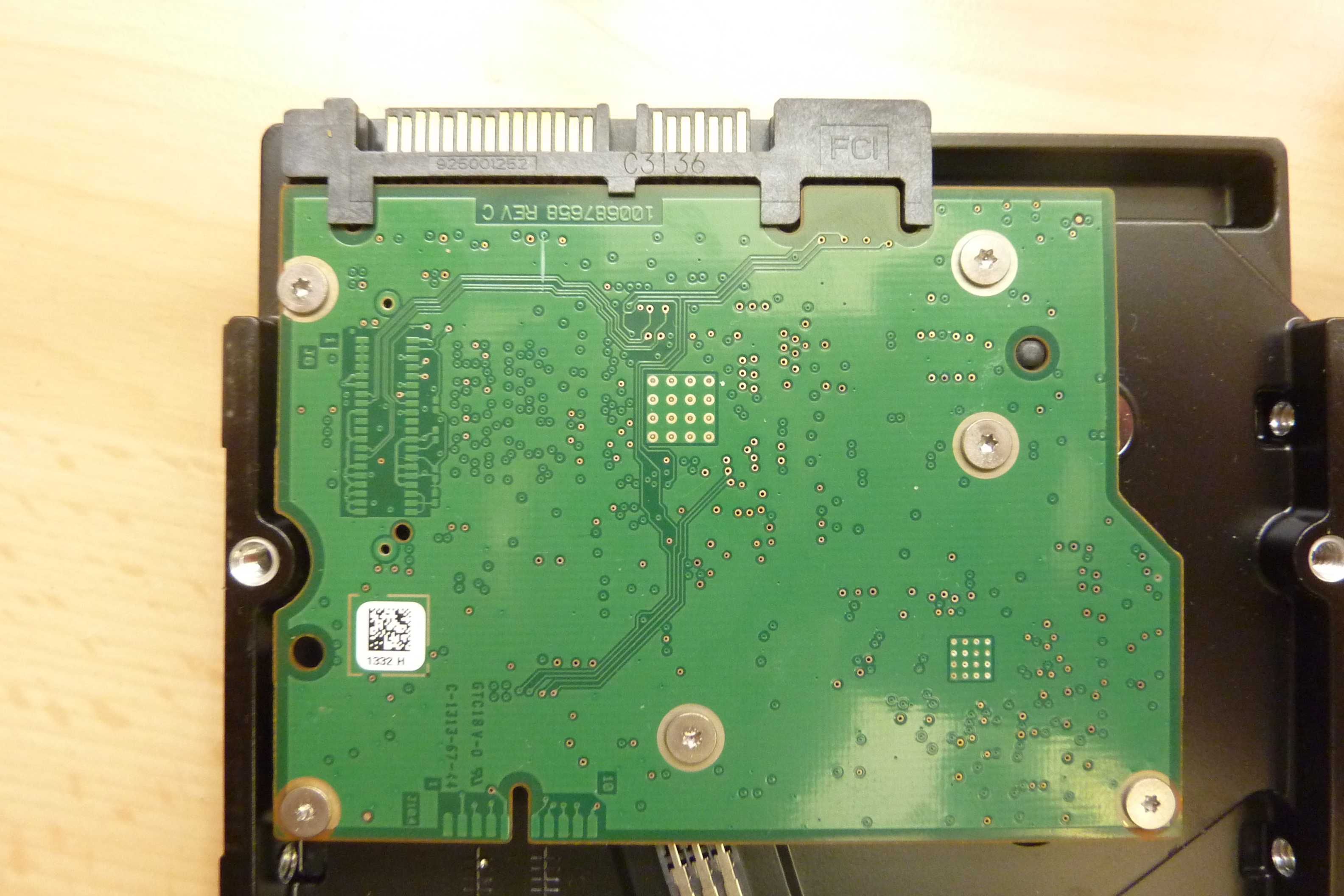

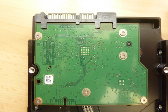

Thanks fzabkar,
Ctrl-L doesn't give anything - but i determined the Preamp version "B4 03" like described in the ACE-Blog.
Detailed photos are uploaded.

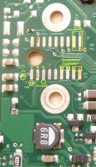

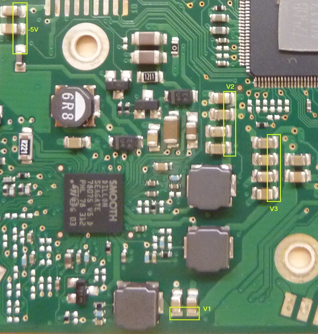

 Post subject: Re: Check damaged preamp / clean Platters from dust
PostPosted: June 4th, 2019, 20:31
Posts: 17230

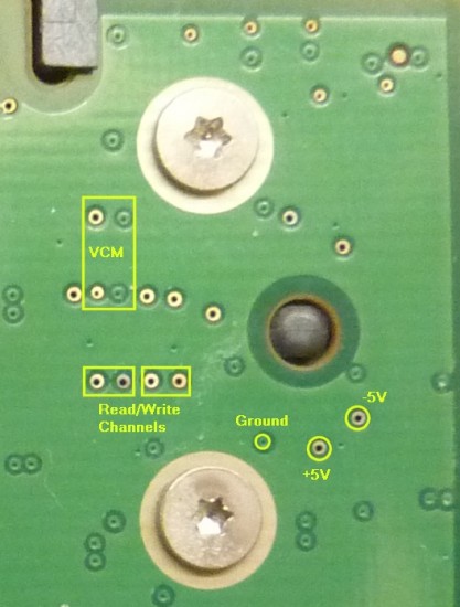

I don't know what is in ACE's blog, but if the preamp ID was retrieved from the preamp itself, then it is most probably OK.

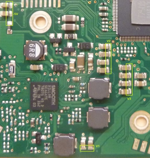

Otherwise I would measure the resistances between ground and each of the +5V and -5V test points. (I'm not sure if I have correctly identified the +5V and Ground pins, but a continuity check with the SATA power connector should confirm this.) Perform the tests with the PCB on and off the drive.
Measure the voltages between ground and each of the Read/Write Channels test points. Do this with the PCB off the drive, and with the drive spinning. I believe that the DC levels of these test points should sit in the middle of the Vio range (0V - 1.8V).
The other HDA signals will probably be sitting at digital logic levels. ISTR that the regulator outputs (V1, V2, V3) will probably be 0.9V, 0.9V, and 1.8V, but not necessarily in that order.
