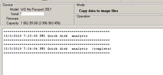

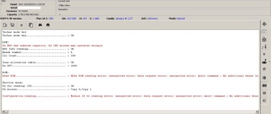

I have got this WD my passport 2TB as per customer disk asks for format.
This model is not supported in my udma. In sector access disk shows all sectors zero. What could be the issue and possible solution.
Id hardware encryption part is not getting involved is the reason showing all zeros ?(I think it should show garbage instead)
Or WD smartware metadata is corrupt. If anyone has experienced same situation then pls. help.

Some SMR drives by Western Digital have an issue with the secondary translator that can cause all sectors to be zero. They also support TRIM on some external models, but it most likely a translator issue. You can test the theory on a Spyglass model. Put some data on it, regen translator, power cycle, now data appears as zeros. There are at least 2 new modules involved. You can read some basic info on WD SMR drives here. I'm guessing Doomer has done some advanced research on these so he might want to expand on this.

Short answer - data is gone.
These drives have a bug(or feature) that sometimes causes the secondary translator to become empty.
When it happens data is usually unrecoverable
