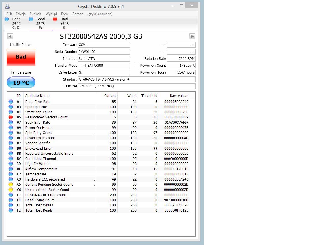

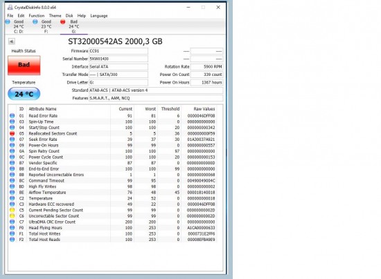

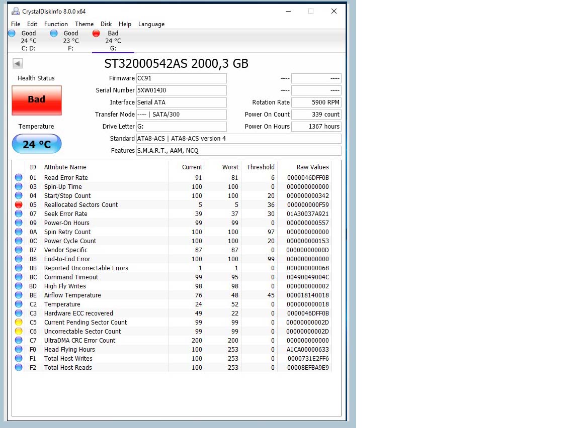

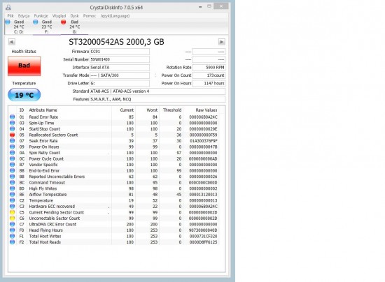

I'm posting SMART:
1- before first attempts
2. after maaaaaany attempts (after 166 power on and 220h)
I know there is some BAD sectors allocated, but this parameter doesn't increase... So ...

File comment: SMART AFTER
File comment: SMART BEFORE

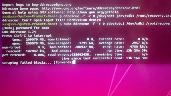

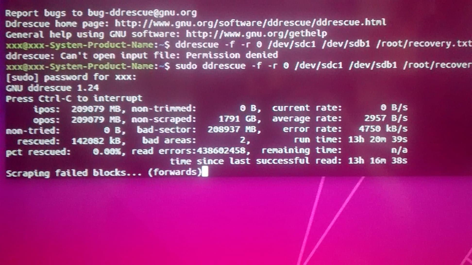

For now i can only post ddrescue screenshot after 13h of working .. So as I said. It recover first 142 MB and hang, so after few minutes of recovering I get only read errors all the time for 13h, so i decide to abort action ...

I'll humbly admit that my knowledge and experience are limited, but I know that some drives just freeze when an error is encountered, and require a power cycle for ddrescue to proceed successfully again. I've had a Toshiba drive (purchased new a few months prior) which misbehaved that way, I had to shut it down and start it up countless times to recover the non backed-up files on it (and I didn't even know about ddrescue at the time so I had to restart the copy of the aborted file with Robocopy). More recently I took care of a badly failing HGST drive which had a similar issue (and was clicking like crazy, not the infamous “click-of-death” but a frequent clicking which stopped eventually for long enough so some more bytes could be extracted again – and at the end I got all the non-system files in good shape except 20 which were corrupted). So if you see that nothing is read (do use the -P switch to get a preview), that the read speed stays at 0, and the “bad sector” size gets very high very quickly, hit CTRL+C, shut down the drive, wait a few seconds, start it up again, hit the “up” key and ENTER to re-launch the same command (or change some parameter, for instance if it hit a wall going forward ask it to go backward, or the other way around), and pray Joe Pesci...
HDDSuperClone is supposed to deal better with that kind of situation, although I don't know if those special features are available in the free version.
But, reading your first post again, it would seem like you already tried maaaaaany times to restart it during those attempts, so the above might be completely irrelevant...
Have you tried ddru_ntfsbitmap ? And have you tried imaging in reverse, starting from the very end (you have to find the exact size) and using the -R switch ?
