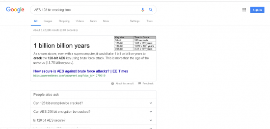

Hello friends
Recently I saw bitlocker encrypted disk without password / key was easily decrypted in pc3000 udma .
Mine is old version as i have not updated in 2 years.
My question is how its possible? Bitlocker uses 4 different types of AES algorithams which is US govt. official standards for storing sensitive data. It takes trillions of years to get the key even if all supercomputing power in the world is combined.
Then how it was done in pc3000 ? What are limitations , in which case it is not possible.
Which type of AES algorithams are supported in pc3000 ?
Can someone pls. answer my query.
https://www.thesslstore.com/blog/what-i ... ncryption/
