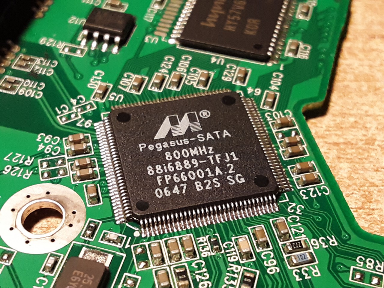

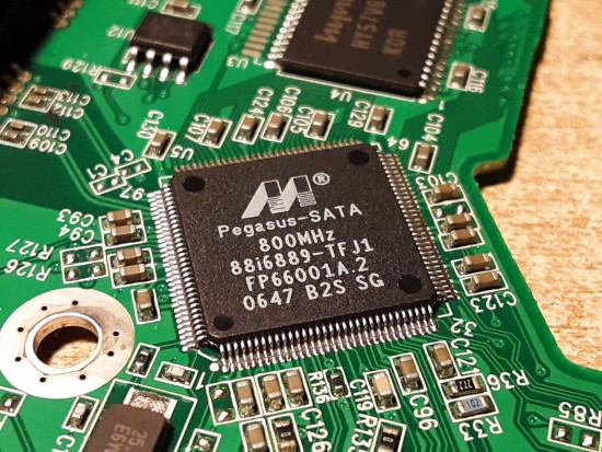

this is the MCU that is on the board

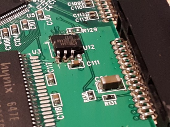

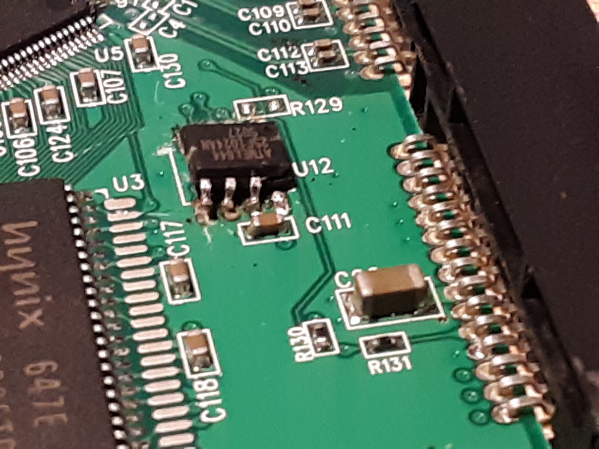

but as i was trying to remove the U12 chip from the winxp hdd board, one of the pins broke off flush with the chip. am i totally screwed at fixing the winxp hdd now? or do i have another option?

this pin
EDIT:
and another pin just broke off.
it is clear now that just my soldering iron and a small needle is not good enough for the job.

you should have done this with DONOR PCB. now you late.
i think this is vcc pin. now you should contact DR center.

Maybe a competent engineer can do something with the broken pins?
So one way of doing it would be to carefully remove whats left of the broken ic and fit it to the replacement board.
Then with a sharp scalpel one can very carefully scrape away the black material next to each broken pin just enough to expose the remains of the pin. Then solder a fine wires to the pcb and then to the ic exposed connections.
I have to say one almost requires the hand skills of a surgeon to do this but it can be done. Then quickly copy off the required data.
Please do not try to do this yourself but find somebody who is good with micro component level pcb repairs and the like. Maybe a competent mobile phone repair specialist who does it in house.
