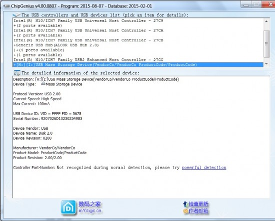

I have USB with 2 partitions >The first partition is read only. I try to format the usb with diskpart and many program (IM-Magic Partition ,EaseUS,.....). I got this message (The disk is write protect).
Pls any advice to format the usb.

sometimes first partition is a virtual CDROM, I cant remember what the thing was now, but there was also something that had apps on a partition that would load when inserted, and there is also some with security.
if partitions were created by a user, such as mucking about with Linux or whatever, then diskpart should get it right. Did you run diskpart as administrator? did you try like as here:
https://superuser.com/questions/536813/how-to-delete-a-partition-on-a-usb-drive or the bootice part here:
https://www.pendrivelinux.com/restoring-your-usb-key-partition/
otherwise the drive could be corrupt

The Usb flash(50 pcs) has 2 partitions. The first is read only has (Advertising for a product) the second one can formated
I run diskpart , MiniTool Partition Wizard and others as administrator in not work ( Still read only)

I did something like this few times for Ads. Companies selling bulk (similar idea)
more info. about it here: http://reboot.pro/topic/17271-create-a- ... ive/page-2
you need to use the factory tools based on flash controller to make one.
start from here: https://www.usbdev.ru/files/
I use ChipGenius software
