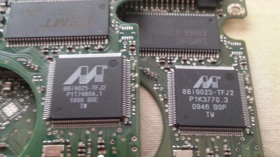

HM641JI
Pcb BF41 00306A
PCB died. Some chips burned.
I removed bios chip and soldered to working donor PCB.
Terminal log :
Apple Macpro RAID connect phy calibrationPLL locked!ChipRev = 63B0
Drive doesn't spin.
I tried another drive with same pcb. Same , only ChipRev = value different. And doesn't spin.
Again soldered original rom to donor. Working normal. It's about patient drives ROM
I couldn't find anything with Google.

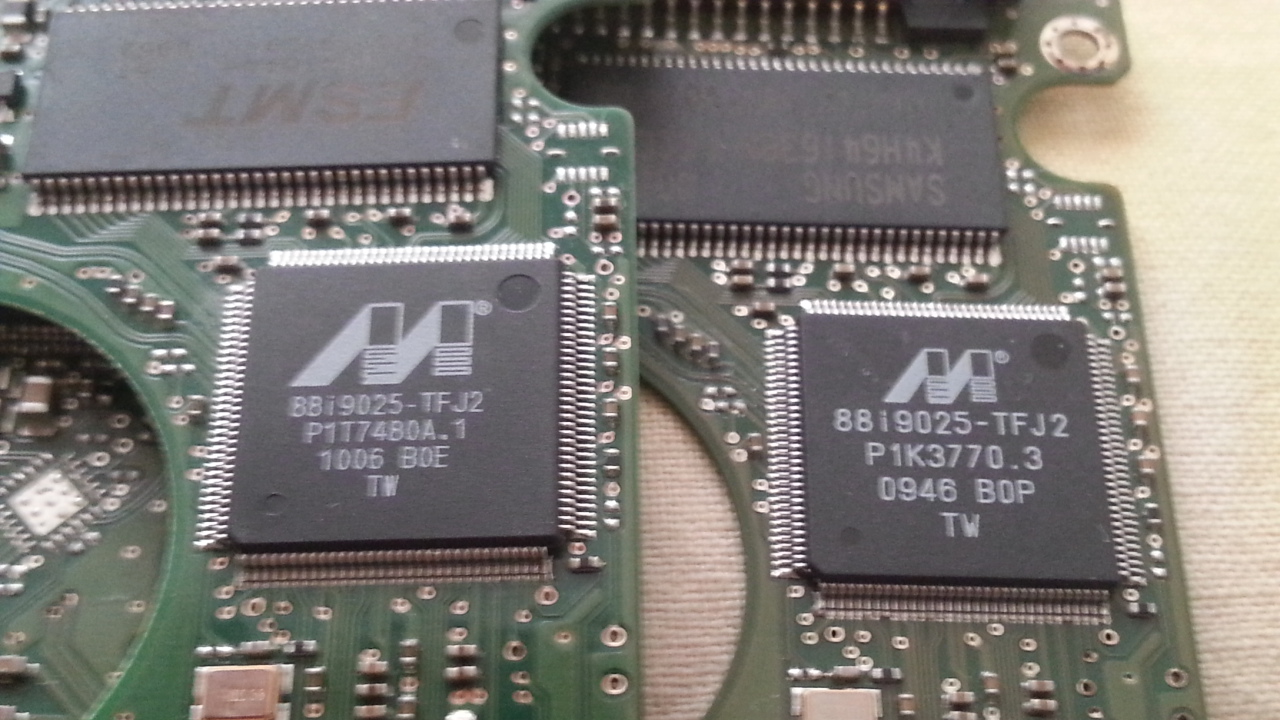

Can you show us the markings on each of your patient and donor MCUs?

Left donor right patient
Different MCU label
Could be not matching PCB?

The MCUs appear to be matched (both "B0").
