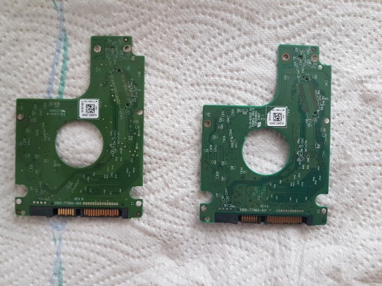

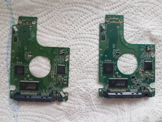

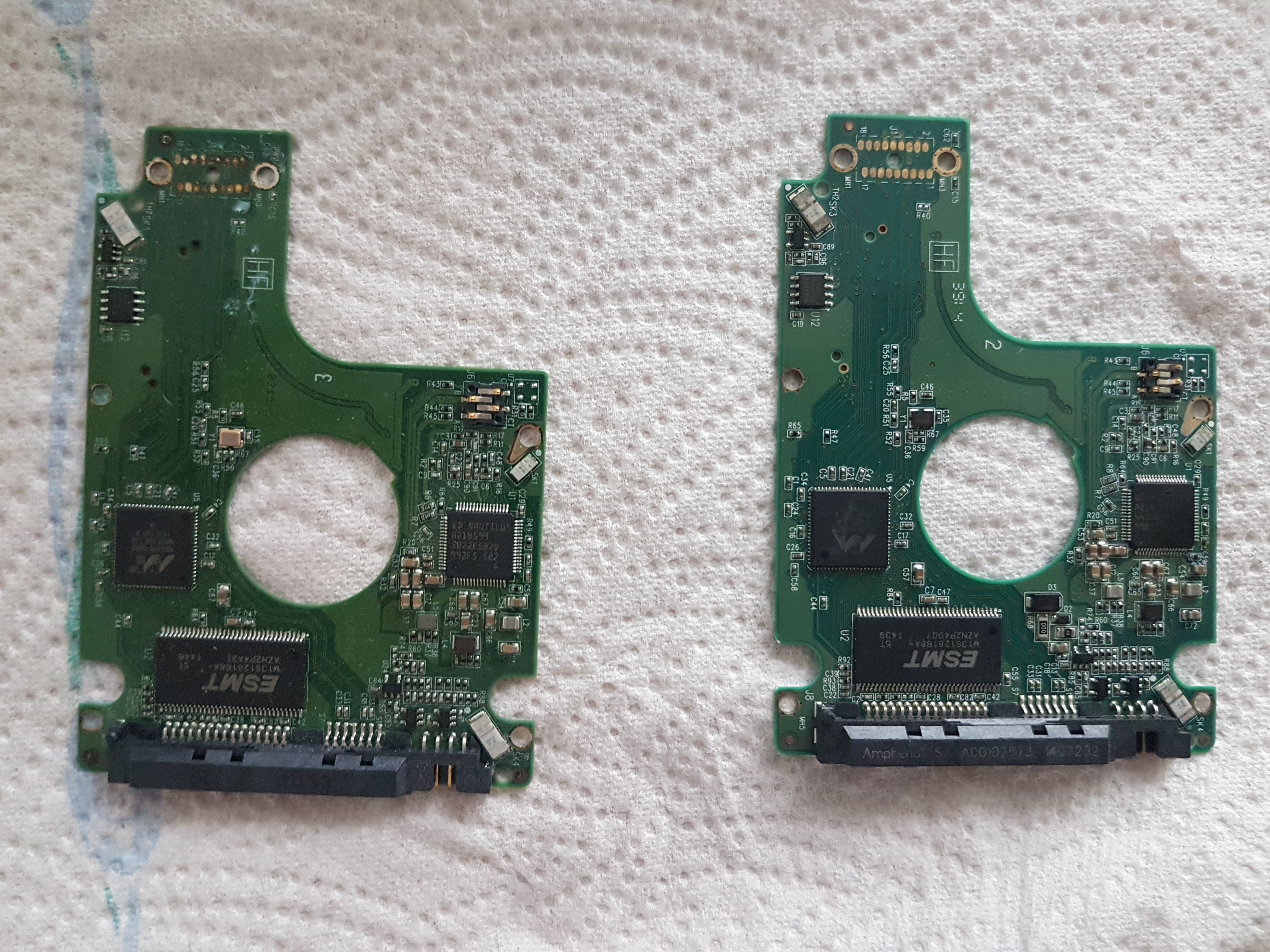

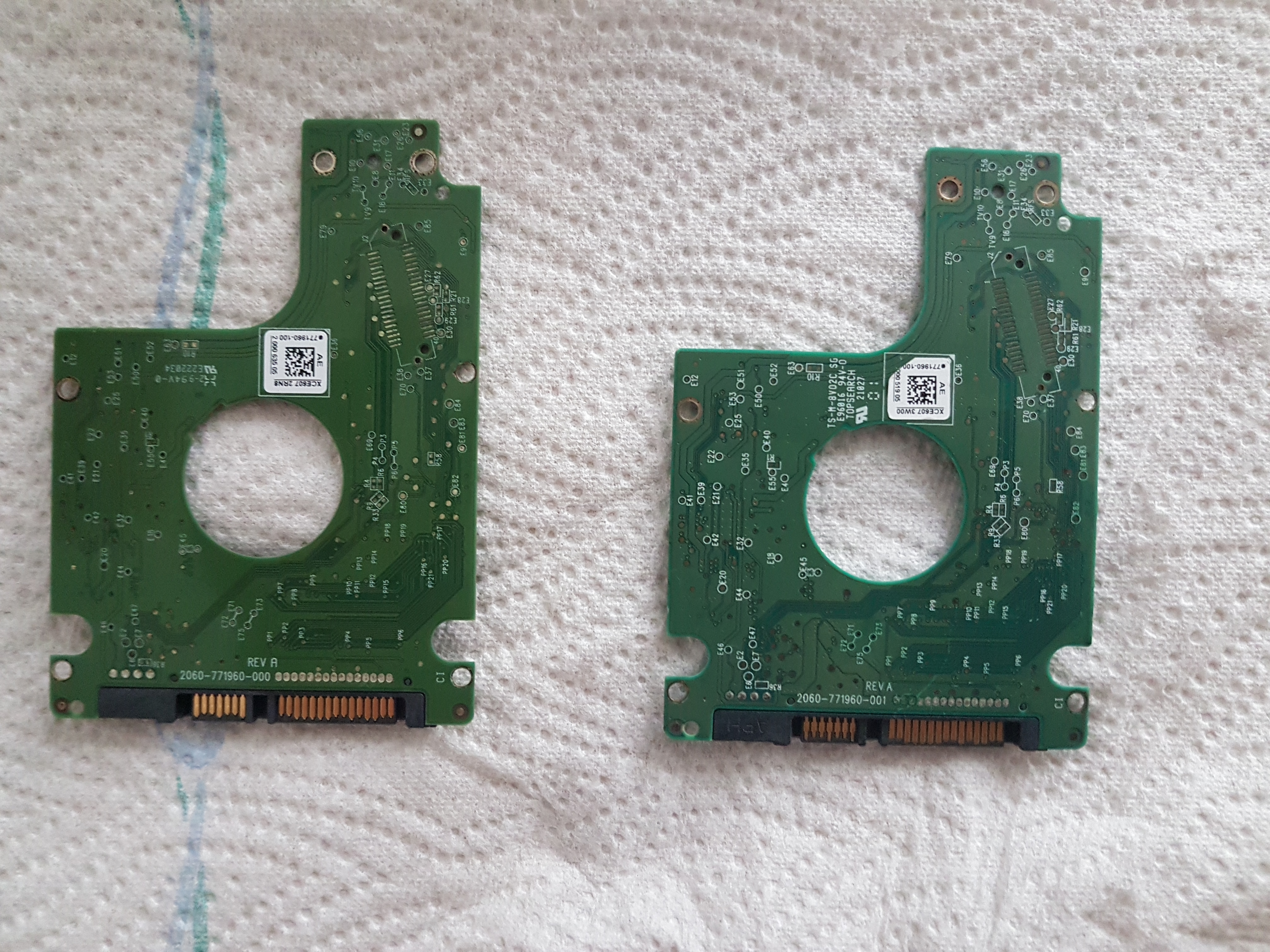

the PCB of my HDD broke and I decided to get a new one. However I accidentally got a new PCB with the number 2060-771960-001. The old PCB had number 2060-771960-000.
Can I still transfer the BIOS chip from the broken one to the new one and expect it to be compatible or should I get a new one with 2060-771960-000?
Left one is the broken PCB, right one the new PCB I got

That PCB will be good.

+1 that PCB will work just fine.

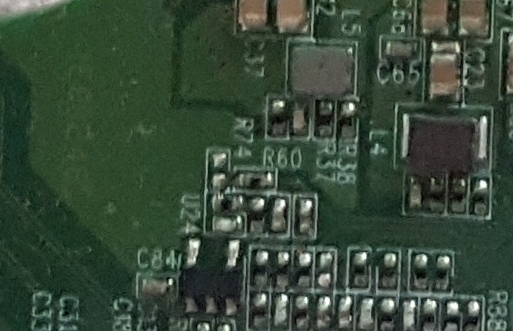

Not a native speaker, so broke is maybe the wrong word in that context. I had a powercut and after I plugged the fuse back in the hdd stopped working. You can see it is burned in the top left corner.
That doesn't look like damage.
Oxidisation on Western Digital PCBs:
http://www.hddoracle.com/viewtopic.php?f=86&t=649
Does the drive still spin up after the power cut?

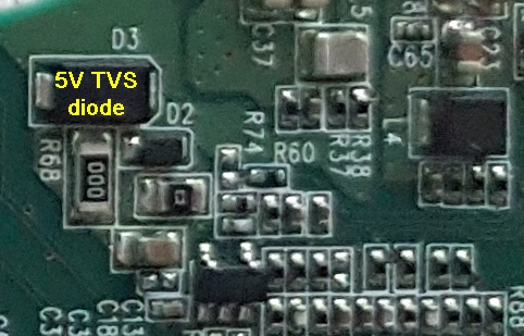

The only difference between the two PCBs appears to be the 5V TVS diode.
I have only ever seen this oxidization on WD 3.5" drives. I have never seen it on a 2.5" drive.

It doesn´t spin up at all. I cleaned the contacts and they look brand new now, but it is still not working. I will replace the PCB and swap the bios chip and see if it works then.

Update: It worked and I was able to recover all the data. How save is it to keep using the hard drive now? Is it only a matter of time before it fails again or can I keep it as a backup drive?
