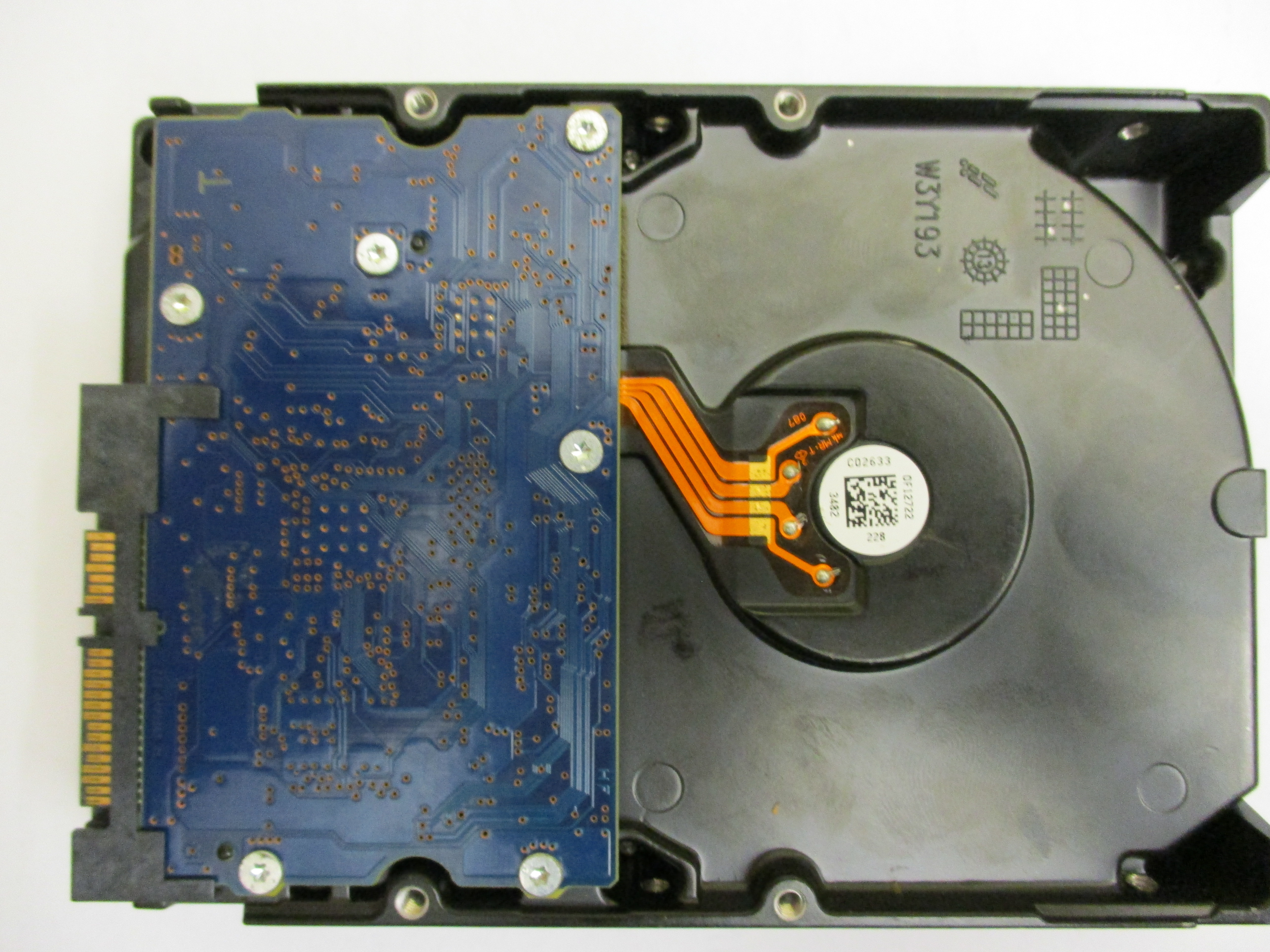

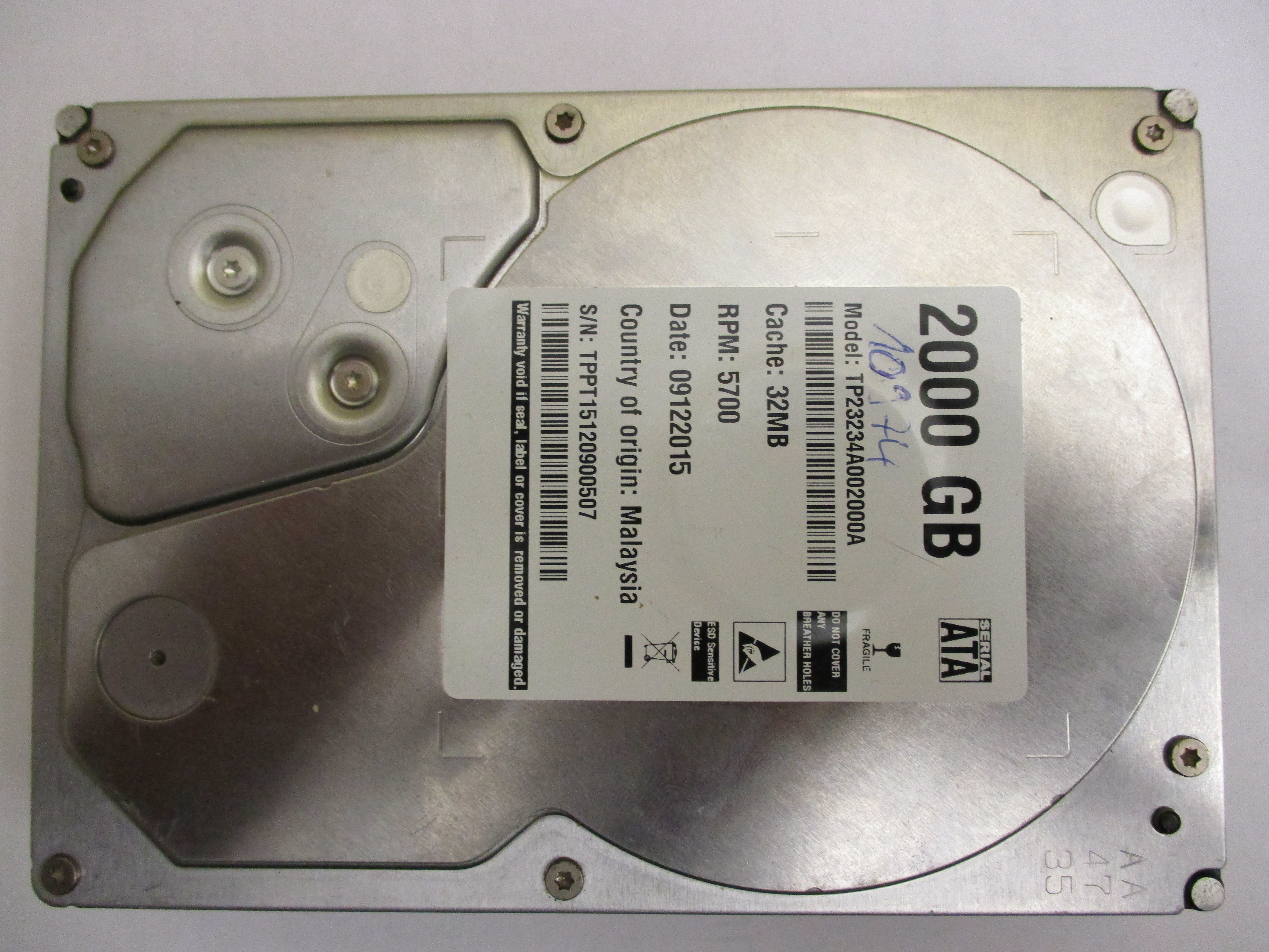

Hello Gurus,
ich have a 2TB HDD which doesn't come ready and clicking. Has anybody seen such HDD before?
Model-Number on the Label is TPS23234A002000A. PCB-Label-Nr. is 0A90380. In ROM ich can find this string: "Hxx5C30xxBLE63x Microcode (C) 2012, HGST, a Western Digital company."
So it's a rebranded HGST-HDD. Can this be handled by PC3K? Which model of HGST/WD-HDD is it?
Thanks in advance!
Boerge
 Post subject: Re: unknown rebranded fake HDD - please help to identify
PostPosted: August 13th, 2019, 16:28
Posts: 17390
https://www.hdd-parts.com/nsearch.html?section=&query=0A90380&searchsubmit=Search&vwcatalog=yhst-14437584971410
    HDS5C3020BLE630
    HCS5C3020BLE630
PostPosted: August 13th, 2019, 16:31
Probably not fake, just refurbished.
PostPosted: August 13th, 2019, 16:39
Joined: May 29th, 2017, 10:38
Posts: 26
Location: Germany
Thanks! I'll try headswap.
PostPosted: August 16th, 2019, 15:41
Joined: May 5th, 2004, 20:06
Posts: 2782
Teleplan white label
