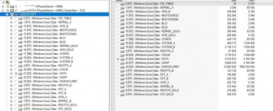

I have a 4TB disk that belongs to a MyCloud Home (with just 1 disk) to recover data.
The disk has some bad sectors on the initial sectors but I can see the partitions like picture1.
But I am not able to recover any structure (full or partial) from the main partition. I used PC3000, R-Studio and UFS - no luck
The main partition is Ext4.
Any suggestion to try on this case?
What is the best software to recover Ext partitions?

What is in the 7.8 TB DISKVOLUME1 folder? That is where I'd be looking.

I would also pay som attention on 3,63 TB "DISKVOLUME1" and check some superblocks there.
