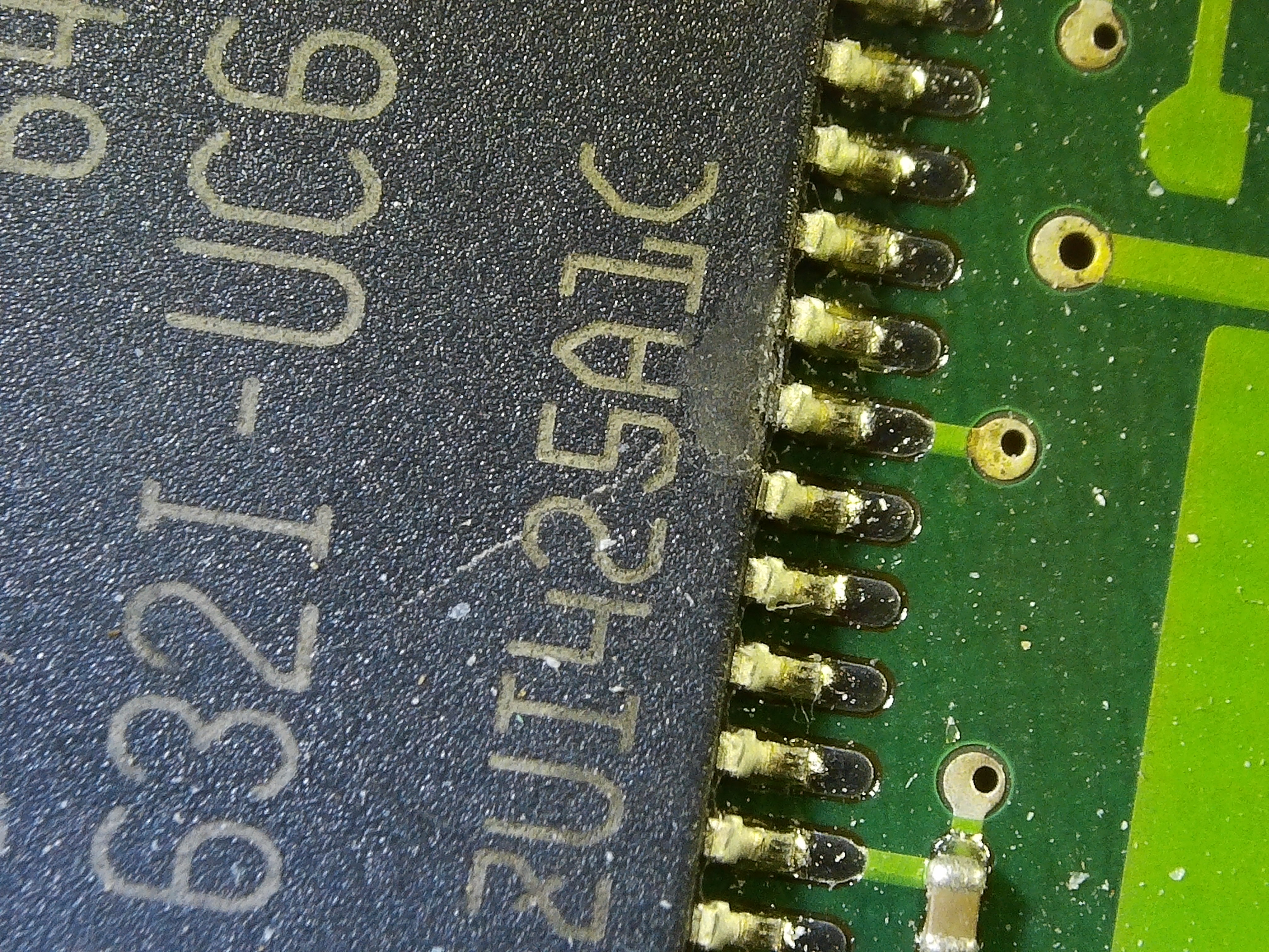

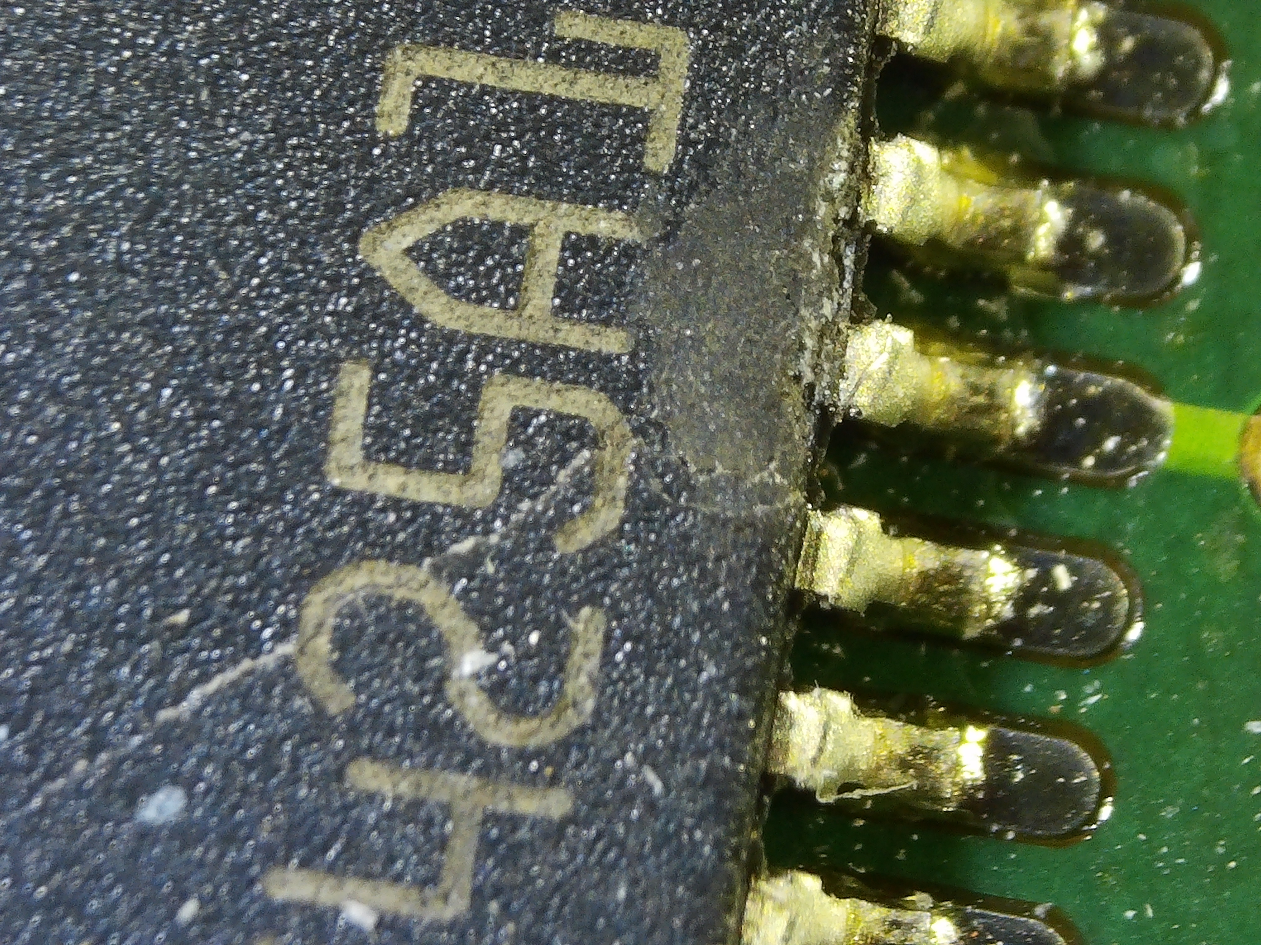

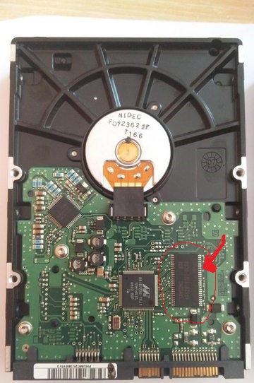

I've got a Samsung HD501LJ 500gig harddrive that i'm looking to repair. I think i've found the problem, but i'm not sure what the best(for me) way is to go about trying to repair it. From my google'ing i've found out that the BIOS is embedded inside another chip(MCU?). I believe it is located in the big square chip in the middle of the board. My problem seems to be the large rectangular chip beside that has been cracked.(pictures attached) I can solder, but not that well. I've never soldered/desoldered an IC before.
I guess i'm just looking for guidance on what i could do to possibly fix this harddive. Should i replace just that cracked chip? Can i find another harddrive w/ the same specs and replace the whole PCB? Is there something software wise that i can use a donor harddrive with?

Sorry about that. When i apply power there is no spin-up or anything. The computer doesn't register anything but i can hear "the electronic hum" as i call it. And when i unplug it the noise fades out within about 3 seconds.
Re: Samsung HD501LJ PCB help
May 15th, 2020, 11:47
The RAM chip might have blown and cracked. I am not sure. Look like you need to replace the whole PCB and transplant the Large squire MCU to transfer the BIOS. Perhaps an electric shop can move the chips, or get a data recovery lab to recover the data. Should be cheap as its only a hardware fault and not a firmware, internal problem.

Just replace the entire PCB from identical donor and you will be ok.

I agree with Unknown. Find a matching rev board and you should be ok, unless that hum is a seized motor. then a board will not fix it.
May 15th, 2020, 13:57
Thank you. I will find a matching board and attempt an MCU swap!
May 15th, 2020, 14:45
Before swapping the MCU, just try the matching rev board without any swapping of chips. It may just work

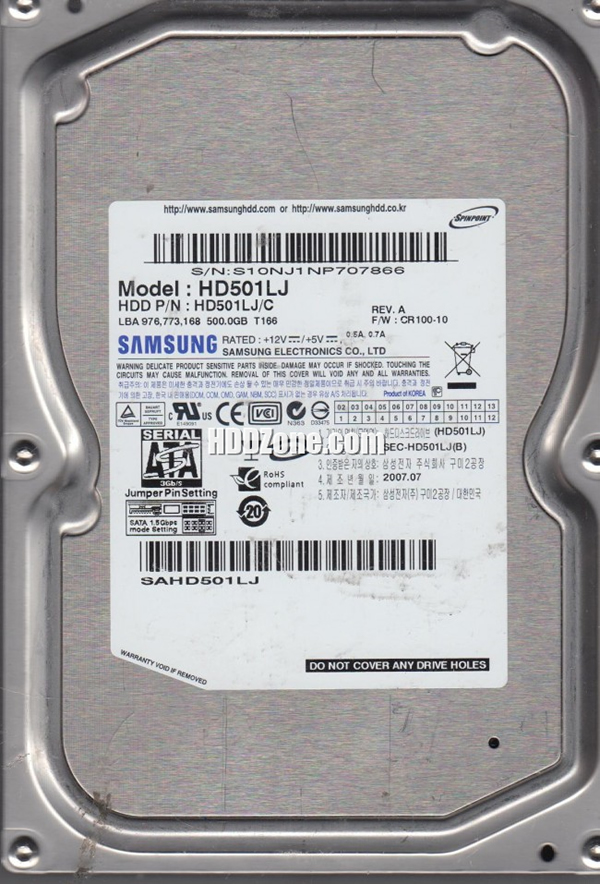

May 15th, 2020, 14:56
Is there a firmware version printed on the drive label?
Something like "CR100-12" from memory.

no, that's not printed anywhere. What's wrong with that ram chip? Is it burnt there? It might not be the only component burnt on that board...
May 15th, 2020, 19:10
If you would like to test the PCB on its own, measure the voltages at the "100" and 4R7 coils. Also measure the voltages at the SOT-89 transistor behind the motor controller IC.
If you would like me to identify these supply voltage test points for you, please upload a detailed photo (or CCD scan) of the PCB.

pepe wrote:no, that's not printed anywhere.
How do you know this? The OP did not post a pic of his label that I can see.
Sometimes the FW version is printed on the drive label on this model.
May 17th, 2020, 14:00
hm, odd, i never noticed... :) i will check some around here
May 18th, 2020, 6:14
Yeah, it's not on many but I have definitely seen it on few here :-)
