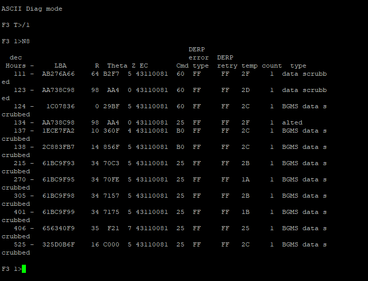

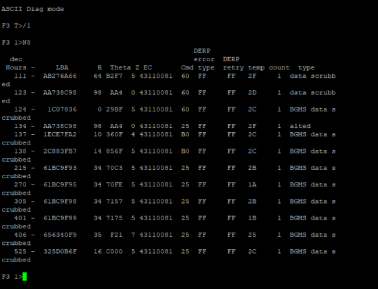

Hi all,
Drive 1 has been connected so far, no errors during startup, so extracted SMART and Event Log. Waiting for your opinions...

F3 1>N8
DERP
dec error DERP
Hours - LBA R Theta Z EC Cmd type retry temp count type

31688 - 13AA1AE4 6 CB8 0 43110081 61 FF FF 1E 1 BGMS data s crubbed
31688 - 13AA1AE7 6 D00 0 43110081 61 FF FF 1E 1 BGMS data s crubbed
31716 - DCDA95D1 90 E9C2 2 43110081 61 FF FF 1F 1 BGMS data s crubbed
31716 - DD29BC4C 90 7BC6 4 43110081 61 FF FF 1F 1 BGMS data s crubbed
31717 - E2EA8740 94 F551 2 43110081 61 FF FF 20 1 BGMS data s crubbed
31740 - AA738602 98 B39 0 43110081 60 FF FF 1D 1 alted
31743 - 45ED821 1 FAF5 0 43110081 61 FF FF 1E 1 BGMS data s crubbed
31744 - DD0219E3 90 2AEC 4 43110081 61 FF FF 24 1 BGMS data s crubbed
31745 - AA53112C 98 B6A 0 80 61 FF FF 22 77 marked as B BM
31745 - AA53112C 98 B6A 0 43110081 61 FF FF 22 1 write bbm a lted
31745 - AA5317C3 64 15DD 5 80 60 FF FF 22 DD marked as B BM
31746 - AA5317C3 64 15DD 5 80 61 FF FF 22 49 marked as B BM
31746 - 1 0 17 0 C0 61 FF FF 20 1 SMART trip
31746 - AA5317C3 64 15DD 5 80 61 FF FF 20 89 marked as B BM
31747 - AA5317C3 64 15DD 5 80 61 FF FF 1F 7B marked as B BM
31747 - 1 0 17 0 C0 B0 FF FF 1F 1 SMART trip
31747 - AA5317C3 64 15DD 5 80 61 FF FF 1F A marked as B BM
31747 - AA5317C3 64 15DD 5 43110081 61 FF FF 1F 1 write bbm d ata scrubbed
31747 - 1 0 17 0 C0 61 FF FF 1E 1 SMART trip
31747 - 13AA1AE8 6 D18 0 43110081 61 FF FF 1E 1 BGMS write bbm data scrubbed
31747 - 1 0 17 0 C0 61 FF FF 1E 5 SMART trip
31748 - 1 0 17 0 C0 61 FF FF 1E 7 SMART trip
31749 - 1 0 17 0 C0 61 FF FF 1F 2 SMART trip
31749 - 2AAC0125 14 9A76 5 43110081 61 FF FF 20 1 BGMS write bbm data scrubbed
31749 - 1 0 17 0 C0 61 FF FF 20 4 SMART trip
31750 - 1 0 17 0 C0 61 FF FF 1D 7 SMART trip
31751 - 1 0 17 0 C0 61 FF FF 1D 6 SMART trip
31752 - 1 0 17 0 C0 61 FF FF 1D 7 SMART trip
31753 - 1 0 17 0 C0 61 FF FF 21 6 SMART trip
31754 - 1 0 17 0 C0 61 FF FF 20 7 SMART trip
31755 - 1 0 17 0 C0 61 FF FF 1D 6 SMART trip
31756 - 1 0 17 0 C0 61 FF FF 1E 7 SMART trip
31757 - 1 0 17 0 C0 61 FF FF 1E 6 SMART trip
31758 - 1 0 17 0 C0 61 FF FF 1C 7 SMART trip
31759 - 1 0 17 0 C0 61 FF FF 1C 6 SMART trip
31760 - 1 0 17 0 C0 61 FF FF 1A 7 SMART trip
31761 - 1 0 17 0 C0 61 FF FF 19 6 SMART trip
31762 - 1 0 17 0 C0 61 FF FF 1C 6 SMART trip
31762 - AA531E5A 64 A22 5 80 61 FF FF 1C 1 BGMS marked as BBM
31762 - AA532BDA 64 FE8D 5 43110081 61 FF FF 1C 1 BGMS write bbm data scrubbed
31762 - AA533271 64 F2D2 5 43110081 61 FF FF 1C 1 BGMS write bbm data scrubbed
31762 - 1 0 17 0 C0 61 FF FF 1C 1 SMART trip
31763 - 1 0 17 0 C0 61 FF FF 1D 6 SMART trip
31764 - 1 0 17 0 C0 61 FF FF 1B 4 SMART trip
31764 - B78C262A 70 C27B 2 43110081 61 FF FF 1C 1 BGMS write bbm data scrubbed
31764 - 1 0 17 0 C0 61 FF FF 1C 3 SMART trip
31765 - 1 0 17 0 C0 61 FF FF 1D 6 SMART trip
31766 - 1 0 17 0 C0 61 FF FF 1D 7 SMART trip
31767 - 1 0 17 0 C0 61 FF FF 1C 1 SMART trip
31767 - CA38A08A 79 4AD 2 43110081 61 FF FF 1C 1 BGMS write bbm data scrubbed
31767 - CAACEF54 80 6DB1 4 43110081 61 FF FF 1D 1 BGMS write bbm data scrubbed
31767 - 1 0 17 0 C0 61 FF FF 1D 5 SMART trip
31768 - 1 0 17 0 C0 61 FF FF 1C 7 SMART trip
31769 - 1 0 17 0 C0 61 FF FF 1D 6 SMART trip
31770 - 1 0 17 0 C0 61 FF FF 1E 7 SMART trip
31771 - 1 0 17 0 C0 61 FF FF 1E 8 SMART trip
31771 - 16BE19 0 B1D0 2 43110081 60 FF FF 11 1 BGMS data s crubbed
31771 - 1 0 17 0 C0 B0 FF FF 13 2 SMART trip
31772 - 1 0 17 0 C0 25 FF FF 28 8 SMART trip
30346 - 4F58B0B 1 1FE7 4 43110081 61 FF FF 1B 1 BGMS data s crubbed
30348 - 14C6B50E 6 461 5 43110081 61 FF FF 1A 1 BGMS data s crubbed
30349 - 211D7032 10 B75 4 43110081 60 FF FF 1B 1 BGMS data s crubbed
30350 - 2A27A5AF 13 C638 4 43110081 61 FF FF 1C 1 BGMS data s crubbed
30356 - 5A85C0DA 31 45D9 4 43110081 61 FF FF 1D 1 BGMS data s crubbed
30356 - 5A85C0DC 31 4610 4 43110081 61 FF FF 1D 1 BGMS data s crubbed
30356 - 5D877EFC 32 164E 4 43110081 60 FF FF 1D 1 BGMS data s crubbed
30401 - DC53544F 90 364D 2 43110081 60 FF FF 1D 1 BGMS data s crubbed
30401 - DC536D19 90 7C4B 2 43110081 60 FF FF 1D 1 BGMS data s crubbed
30403 - 474529B 1 A565 3 43110081 61 FF FF 1B 1 BGMS data s crubbed
30409 - 30C08C13 16 A396 4 43110081 61 FF FF 1B 1 BGMS data s crubbed
30409 - DC5332B3 90 6B0D 2 43110081 61 FF FF 1A 1 BGMS data s crubbed
30417 - A18F7A8C 59 ADFD 4 43110081 61 FF FF 1E 1 BGMS data s crubbed
30424 - DC52B927 90 76F3 2 43110081 61 FF FF 1F 1 BGMS data s crubbed
30430 - CA810C89 79 C5D8 4 43110081 60 FF FF 1D 1 BGMS data s crubbed
30435 - E0402F61 92 5B9C 4 43110081 60 FF FF 1C 1 BGMS data s crubbed
30456 - A0A168BA 59 5DED 4 43110081 61 FF FF 1C 1 BGMS data s crubbed
30461 - 1146410 0 8FE 3 43110081 61 FF FF 1B 1 BGMS data s crubbed
30461 - 116E68A 0 586 4 43110081 61 FF FF 1B 1 BGMS data s crubbed
30461 - 30D76AC 0 57D3 5 43110081 61 FF FF 1B 1 BGMS data s crubbed
30465 - 26EC7490 12 2859 4 43110081 61 FF FF 1C 1 BGMS data s crubbed
30466 - 28C948A2 13 1609 4 43110081 61 FF FF 1C 1 BGMS data s crubbed
30466 - 29B77511 13 CE0D 4 43110081 61 FF FF 1C 1 BGMS data s crubbed
30471 - DC535E33 90 EACB 2 43110081 61 FF FF 1D 1 BGMS data s crubbed
30489 - CA810C8A 79 C600 4 43110081 61 FF FF 1B 1 BGMS data s crubbed
30493 - DBB20E50 89 90A2 2 43110081 61 FF FF 1A 1 BGMS data s crubbed
30493 - DCDC8F01 90 B0 2 43110081 61 FF FF 1A 1 BGMS data s crubbed
30493 - DCDC9478 90 F1DD 2 43110081 61 FF FF 1A 1 BGMS data s crubbed
30495 - E6829617 96 EFC2 2 43110081 61 FF FF 1A 1 BGMS data s crubbed
30517 - A0A1E52D 59 7D68 4 43110081 61 FF FF 1A 1 BGMS data s crubbed
30518 - DCE3D009 90 5A29 4 43110081 61 FF FF 1C 1 BGMS data s crubbed
30519 - 11766A5 0 71A6 4 43110081 61 FF FF 1A 1 BGMS data s crubbed
30520 - 5458305 1 2C06 1 43110081 61 FF FF 1A 1 BGMS data s crubbed
30524 - DCE3F758 90 20ED 4 43110081 61 FF FF 1A 1 BGMS data s crubbed
30527 - DC53B0FE 90 309D 2 43110081 61 FF FF 1B 1 BGMS data s crubbed
30531 - 61FF2497 33 3DE1 4 43110081 61 FF FF 1A 1 BGMS data s crubbed
30548 - D056337D 83 468B 2 43110081 60 FF FF 1A 1 BGMS data s crubbed
30635 - 4745295 1 A4D4 3 43110081 61 FF FF 1E 1 BGMS data s crubbed
30635 - 4E9A558 1 71BF 2 43110081 61 FF FF 1E 1 BGMS data s crubbed
30636 - B3AA148 3 E7AB 4 43110081 61 FF FF 1E 1 BGMS data s crubbed
30637 - 11B12575 5 895 2 43110081 61 FF FF 1D 1 BGMS data s crubbed
30647 - 6300A335 34 E055 4 43110081 60 FF FF 1E 1 BGMS data s crubbed
30655 - DC4D3971 89 5AE8 1 43110081 60 FF FF 1D 1 BGMS data s crubbed
30665 - CE64C58D 82 7CCE 4 43110081 61 FF FF 1C 1 BGMS data s crubbed
30669 - E682960F 96 EE3B 2 43110081 60 FF FF 1D 1 BGMS data s crubbed
30691 - A0A1E52D 59 7D68 4 43110081 61 FF FF 1F 1 BGMS data s crubbed
30691 - 9F51 0 9A42 0 43110081 60 FF FF 1F 1 BGMS data s crubbed
30694 - 6083A6 0 C7F 3 43110081 60 FF FF 1E 1 BGMS data s crubbed
30694 - 9C021C 0 A444 4 43110081 61 FF FF 1E 1 BGMS data s crubbed
30694 - 1025700 0 77DB 1 43110081 61 FF FF 1F 1 BGMS data s crubbed
30709 - D7F11C68 87 E51B 2 43110081 61 FF FF 1E 1 BGMS data s crubbed
30753 - 2A4872 0 F0A3 5 43110081 61 FF FF 1A 1 BGMS data s crubbed
30753 - 4B0F71D 1 B8A 4 43110081 60 FF FF 1A 1 BGMS data s crubbed
30754 - E084395 4 53EA 2 43110081 60 FF FF 1B 1 BGMS data s crubbed
30755 - DA13A74C 88 0 3 43110081 61 FF FF 1B 1 BGMS data s crubbed
30757 - 220C069C 10 CAFD 3 43110081 61 FF FF 1A 1 BGMS data s crubbed
30784 - DCDE8D6A 90 FE1A 2 43110081 61 FF FF 1F 1 BGMS data s crubbed
30785 - E2FF9559 94 61C3 2 43110081 61 FF FF 1D 1 BGMS data s crubbed
30793 - D039EA77 83 0 2 43110081 61 FF FF 1E 1 BGMS data s crubbed
30810 - 15319B 0 5A5F 2 43110081 61 FF FF 20 1 BGMS data s crubbed
30811 - 5458306 1 2C1E 1 43110081 60 FF FF 20 1 BGMS data s crubbed
30815 - A22A6ABC 59 0 1 43110081 60 FF FF 21 1 BGMS data s crubbed
30819 - 28CA3440 13 293A 4 43110081 61 FF FF 20 1 BGMS data s crubbed
30819 - DC53B92A 90 9941 2 43110081 61 FF FF 1E 1 BGMS data s crubbed
30843 - C8711E27 78 7352 2 43110081 61 FF FF 1E 1 BGMS data s crubbed
30846 - DC80BF04 90 19DB 2 43110081 61 FF FF 1F 1 BGMS data s crubbed
30874 - EC9A383 4 DB10 4 43110081 61 FF FF 1D 1 BGMS data s crubbed
30878 - 2A284CED 13 272C 4 43110081 61 FF FF 20 1 BGMS data s crubbed
30884 - 622F3FE2 34 E62 4 43110081 60 FF FF 1C 1 BGMS data s crubbed
30895 - AB277100 98 A0F 0 43110081 60 FF FF 1A 1 BGMS alted
30897 - DCD93408 90 1374 1 43110081 61 FF FF 1B 1 BGMS data s crubbed
30900 - D7F12C5B 87 A4FA 2 43110081 61 FF FF 1B 1 BGMS data s crubbed
30902 - CDC75F00 82 1731 5 43110081 61 FF FF 20 1 BGMS data s crubbed
30905 - CC3080BE 80 1D86 4 43110081 60 FF FF 1F 1 BGMS data s crubbed
30907 - CA2D7027 79 9762 4 43110081 61 FF FF 1D 1 BGMS data s crubbed
30935 - 4745290 1 A45A 3 43110081 61 FF FF 20 1 BGMS data s crubbed
30935 - 4EA5E20 1 6186 2 43110081 60 FF FF 20 1 BGMS data s crubbed
30935 - 52AF09D 1 FC06 4 43110081 61 FF FF 20 1 BGMS data s crubbed
30936 - E09C644 4 6A5 2 43110081 61 FF FF 20 1 BGMS data s crubbed
30937 - 14C6B503 6 349 5 43110081 61 FF FF 20 1 BGMS data s crubbed
30939 - 29EBDDD7 13 966D 4 43110081 61 FF FF 20 1 BGMS data s crubbed
30943 - DC543188 90 594C 2 43110081 61 FF FF 1D 1 BGMS data s crubbed
30945 - 58190837 30 131D 1 43110081 61 FF FF 1F 1 BGMS data s crubbed
30945 - 9F51 0 9A42 0 43110081 61 FF FF 1F 1 BGMS data s crubbed
30992 - 144A1B7 0 F4C6 5 43110081 61 FF FF 20 1 BGMS data s crubbed
30993 - 10B05A41 5 73B 4 43110081 60 FF FF 1E 1 BGMS data s crubbed
31010 - DCD9298F 90 2C00 1 43110081 61 FF FF 1D 1 BGMS data s crubbed
31016 - BB98FAAD 72 4D27 2 43110081 61 FF FF 1F 1 BGMS data s crubbed
31047 - DC54628A 90 CC1C 2 43110081 61 FF FF 1E 1 BGMS data s crubbed
31050 - 1159D40F 5 5C98 2 43110081 61 FF FF 1E 1 BGMS data s crubbed
31052 - DA137470 88 C0BA 3 43110081 61 FF FF 22 1 BGMS data s crubbed
31053 - 2974DBEE 13 B1C0 4 43110081 61 FF FF 20 1 BGMS data s crubbed
31053 - 2974E91A 13 FBFC 4 43110081 61 FF FF 20 1 BGMS data s crubbed
31054 - 30C08C11 16 A362 4 43110081 61 FF FF 1C 1 BGMS data s crubbed
31058 - A18F2305 59 570F 4 43110081 61 FF FF 1F 1 BGMS data s crubbed
31077 - C9B2D604 79 67D 2 43110081 61 FF FF 1D 1 BGMS data s crubbed
31081 - D7395080 87 AA56 4 43110081 61 FF FF 1F 1 BGMS data s crubbed
31082 - DC54FA16 90 EC2C 2 43110081 61 FF FF 1F 1 BGMS data s crubbed
31083 - E2E377C7 94 2831 4 43110081 61 FF FF 1B 1 BGMS data s crubbed
31110 - 115E4902 5 B158 2 43110081 60 FF FF 1A 1 BGMS data s crubbed
31112 - 21285EC7 10 45B0 2 43110081 61 FF FF 1A 1 BGMS data s crubbed
31113 - 26A8DD46 12 2827 4 43110081 61 FF FF 1A 1 BGMS data s crubbed
31113 - 2758821F 13 FC81 2 43110081 60 FF FF 1B 1 BGMS data s crubbed
31120 - 60EB3706 33 D76A 4 43110081 61 FF FF 1A 1 BGMS data s crubbed
31130 - AC3D0480 65 4A22 5 43110081 61 FF FF 1C 1 BGMS data s crubbed
31135 - C78C0EDC 78 DB89 4 43110081 61 FF FF 1A 1 BGMS data s crubbed
31135 - CAACEF55 80 6DD8 4 43110081 60 FF FF 1A 1 BGMS data s crubbed
31136 - D031C708 83 C84C 4 43110081 61 FF FF 19 1 BGMS data s crubbed
31139 - E101CC38 93 3A7A 4 43110081 60 FF FF 1A 1 BGMS data s crubbed
31140 - E54E87F3 95 6C52 4 43110081 61 FF FF 19 1 BGMS data s crubbed
31165 - 11D9502 0 45CF 5 43110081 61 FF FF 1A 1 BGMS data s crubbed
31165 - 212D497 0 F39 4 43110081 61 FF FF 1A 1 BGMS data s crubbed
31165 - 4064E2E 1 1121 5 43110081 61 FF FF 1A 1 BGMS data s crubbed
31165 - 4745291 1 A473 3 43110081 61 FF FF 1A 1 BGMS data s crubbed
31165 - 52AF090 1 FAC3 4 43110081 61 FF FF 1A 1 BGMS data s crubbed
31165 - 52AF091 1 FADC 4 43110081 61 FF FF 1A 1 BGMS data s crubbed
31168 - 20A7CD9B 10 91B9 4 43110081 61 FF FF 19 1 BGMS data s crubbed
31169 - 26ACF44C 12 B23D 4 43110081 B0 FF FF 1D 1 BGMS data s crubbed
31169 - 26EC748F 12 2840 4 43110081 61 FF FF 1D 1 BGMS data s crubbed
31170 - DCF79EFA 90 C365 7 43110081 61 FF FF 1D 1 BGMS data s crubbed
31175 - A1EEE86C 60 336E 4 43110081 61 FF FF 1A 1 BGMS data s crubbed
31196 - E0A5BF27 92 F2F6 2 43110081 61 FF FF 1E 1 BGMS data s crubbed
31221 - 36FA793 1 892E 1 43110081 61 FF FF 1F 1 BGMS data s crubbed
31221 - 40A97B6 1 21AC 5 43110081 61 FF FF 20 1 BGMS data s crubbed
31226 - 28C5BE07 13 4C63 4 43110081 60 FF FF 1C 1 BGMS data s crubbed
31228 - 39115FA2 19 2AF9 4 43110081 61 FF FF 1D 1 BGMS data s crubbed
31233 - 61FF24A5 33 3F71 4 43110081 61 FF FF 1D 1 BGMS data s crubbed
31246 - DA13A74C 88 0 3 43110081 60 FF FF 21 1 BGMS data s crubbed
31254 - DC53397C 90 967F 2 43110081 61 FF FF 1D 1 BGMS data s crubbed
31286 - 3672F212 18 D920 6 43110081 61 FF FF 1C 1 BGMS data s crubbed
31310 - DC4F4CCB 89 F6E8 1 43110081 61 FF FF 1B 1 BGMS data s crubbed
31319 - D8B4DDF0 88 8B5 5 43110081 61 FF FF 1C 1 BGMS data s crubbed
31322 - DA137470 88 C0BA 3 43110081 61 FF FF 1C 1 BGMS data s crubbed
31337 - 162642 0 C6FD 2 43110081 61 FF FF 19 1 BGMS data s crubbed
31337 - 44D1572 1 76E9 1 43110081 60 FF FF 1A 1 BGMS data s crubbed
31337 - 4702C5B 1 A62C 2 43110081 61 FF FF 1A 1 BGMS data s crubbed
31337 - 5D65832 1 AE03 1 43110081 61 FF FF 1C 1 BGMS data s crubbed
31361 - BF6E7B81 74 E41 2 43110081 61 FF FF 1D 1 BGMS data s crubbed
31367 - E09DD3A7 92 5005 4 43110081 61 FF FF 1E 1 BGMS data s crubbed
31368 - E21C21F4 93 8943 5 43110081 60 FF FF 1F 1 BGMS data s crubbed
31369 - E85B5C25 97 47D5 4 43110081 61 FF FF 20 1 BGMS data s crubbed
31391 - A22A8719 59 D4E7 1 43110081 60 FF FF 23 1 BGMS data s crubbed
31393 - 216B309 0 FB2C 5 43110081 61 FF FF 1F 1 BGMS data s crubbed
31398 - 29EC1C97 13 BBA4 4 43110081 61 FF FF 20 1 BGMS data s crubbed

Took a look at the DERP event log. Doesn't look like the drive has problems at all. I think occassional data scrubbing is normal, as well the one alted sector.
I wonder what happened originally with the drives. Maybe the old firmware indeed had a bug, or they had been subject to excessive vibration...
