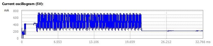

After transplanting IC602 from patient to donor however, the hdd still refuses to become recognizable and makes a series of clicking noises quite soon (~2-3 sec.) after spinning up. it used to click before but AFAIR the clicking started at a later stage and sounded somewhat less distressing. To me, there were no acoustic signs of loose or sticky heads at any time thats why i tried the conversion.
I recorded the series of clicking sounds and encoded with Opus-codec and put it in attached .zip as neither .opus nor .mp3 seems to be an allowed extension for uploads on hddguru. Unfortunately I didn't record the disk's sounds with it original USB-board...

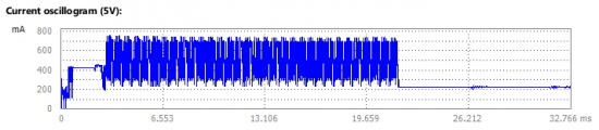

I've also measured the current during the initial spinup-phase as seen in attached image.
Now I'm wondering where to head next; any suggestions on what to try? I'm wondering if the conversion itself worked and e.g. the heads are an issue with this disk. Hope there is some hope left?
