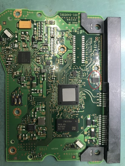

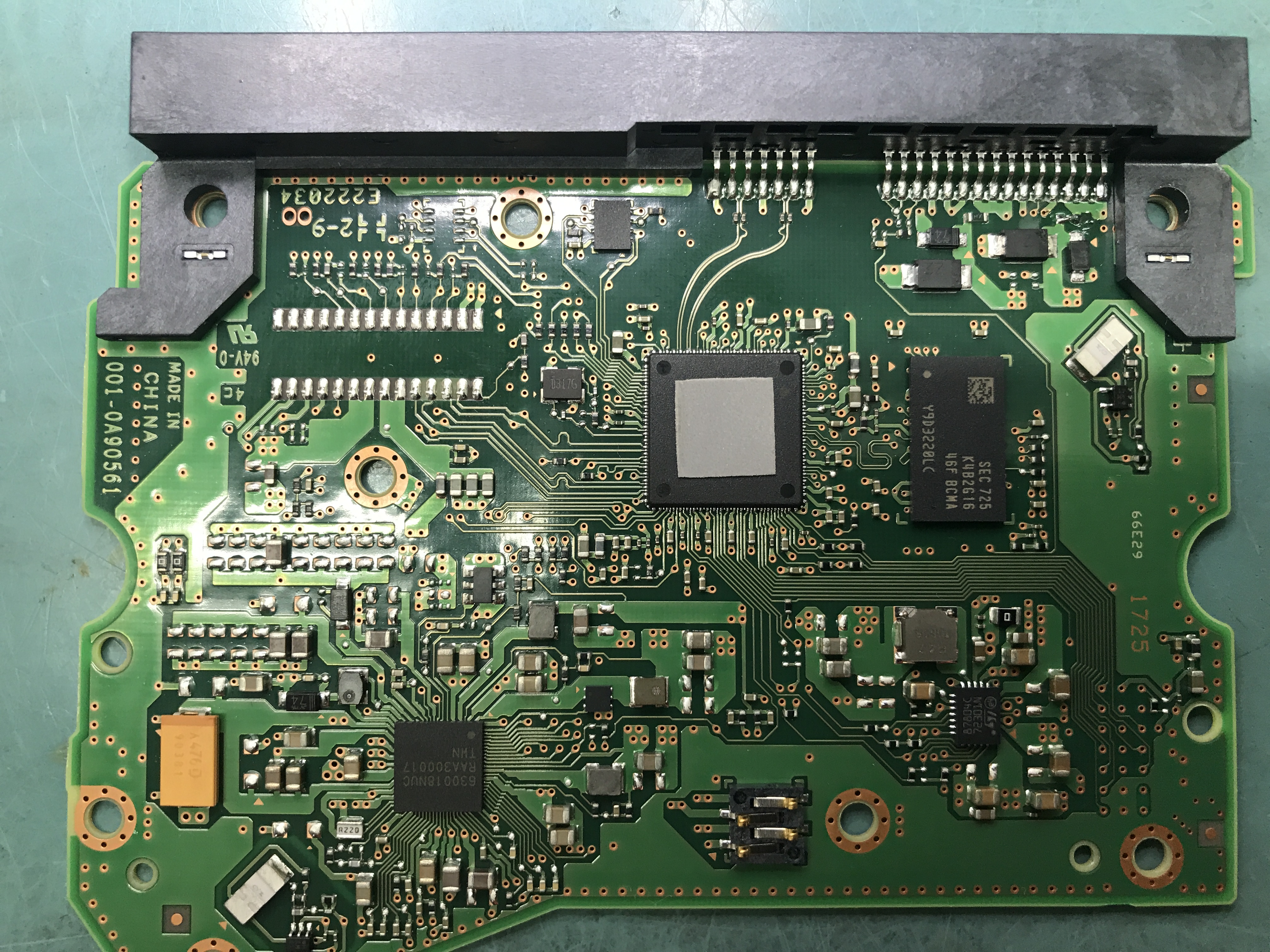

I have a WD mybook WD80EZAZ-11TDBA0 it has no power,is the rom now masked to main processor? I have cover the 3.3V pin hoping it will work but it doesnt work. in PC3000 12V rail line error, 5V line is ok.
There is a HX marking components which was damage, probably fuse?
Any help much appreciated.

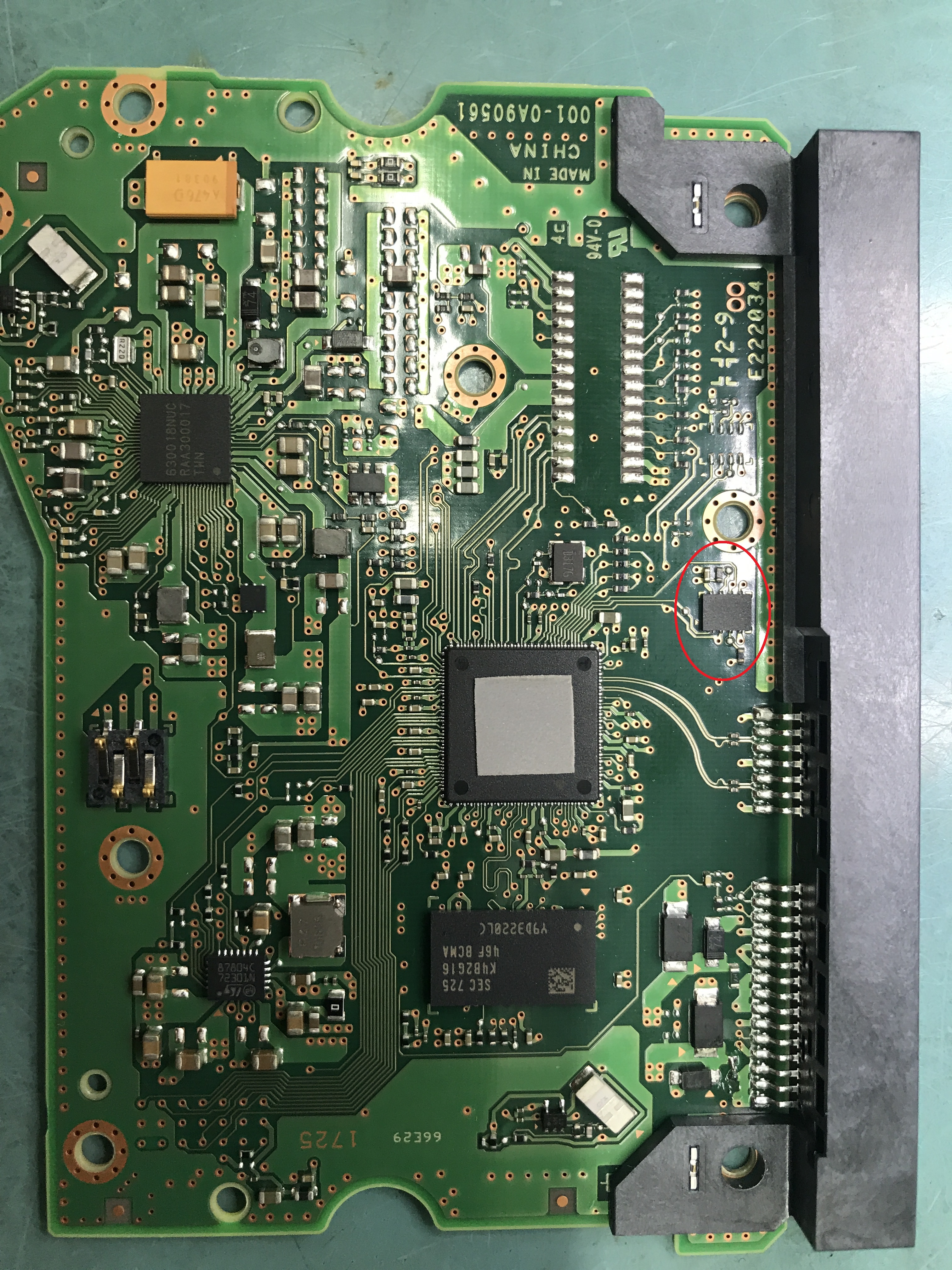

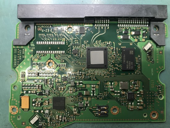

Is not the ROM where I marked in red?

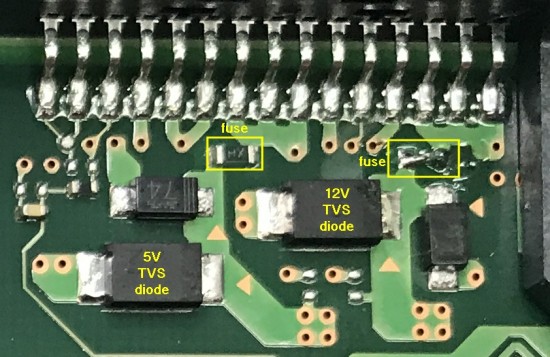

Check the 12V TVS diode and its associated fuse.
Yes.
http://www.hddoracle.com/viewtopic.php?f=21&t=2549&p=20305#p20305

Please do tell us how you go replacing the diode and fuse. It should be a 5-minute job.
 Post subject: Re: WD mybook WD80EZAZ-11TDBA0 no power masked ROM?
PostPosted: September 9th, 2019, 21:32
Posts: 1241
Location: inside ROM
Done, replaced 12V TVS and a fuse, luckily the HDA is still ok. thanks again for your help Spokk & Fzabkar
