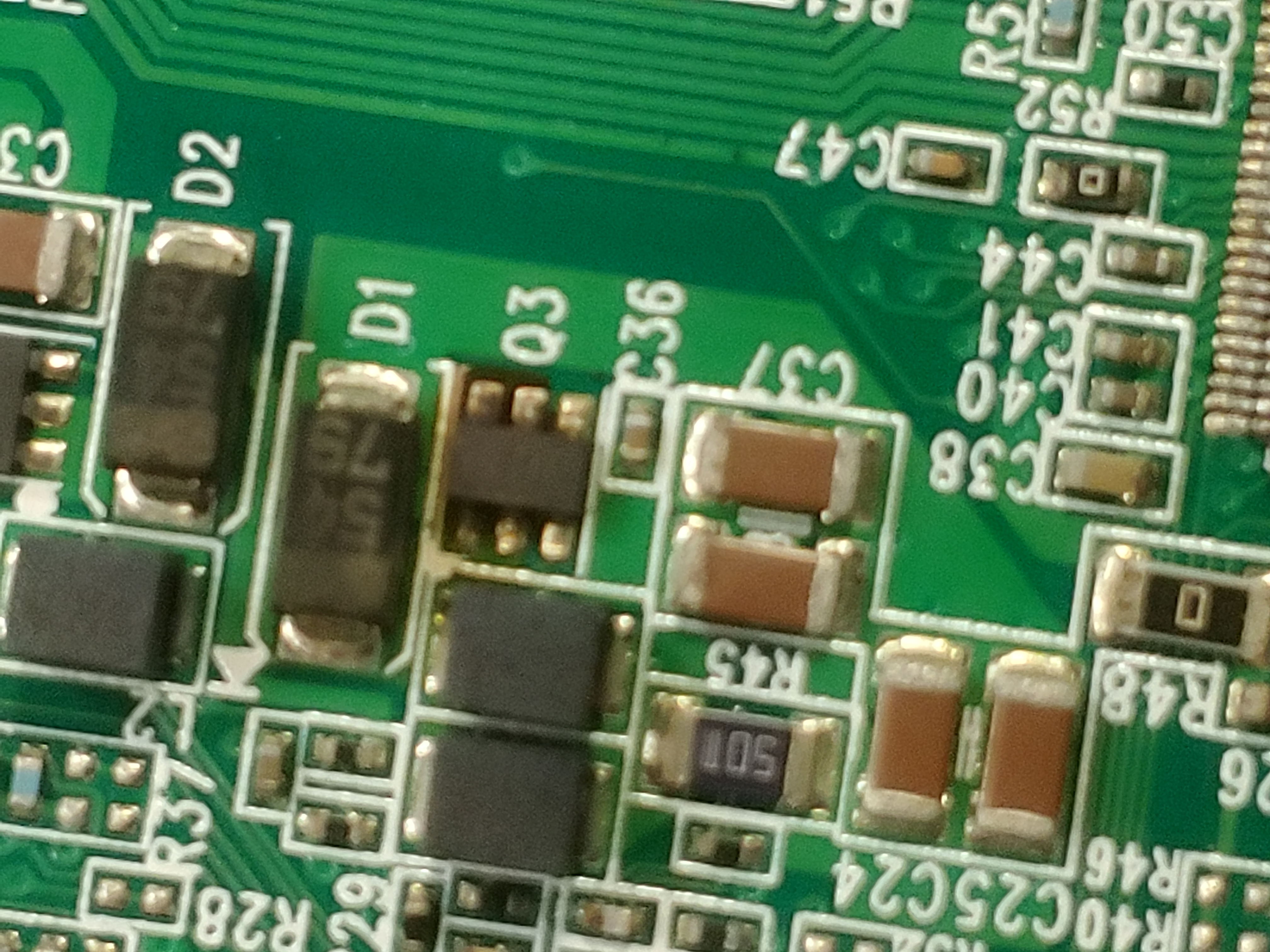

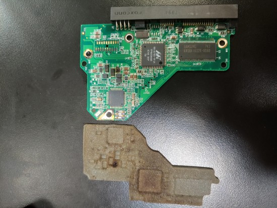

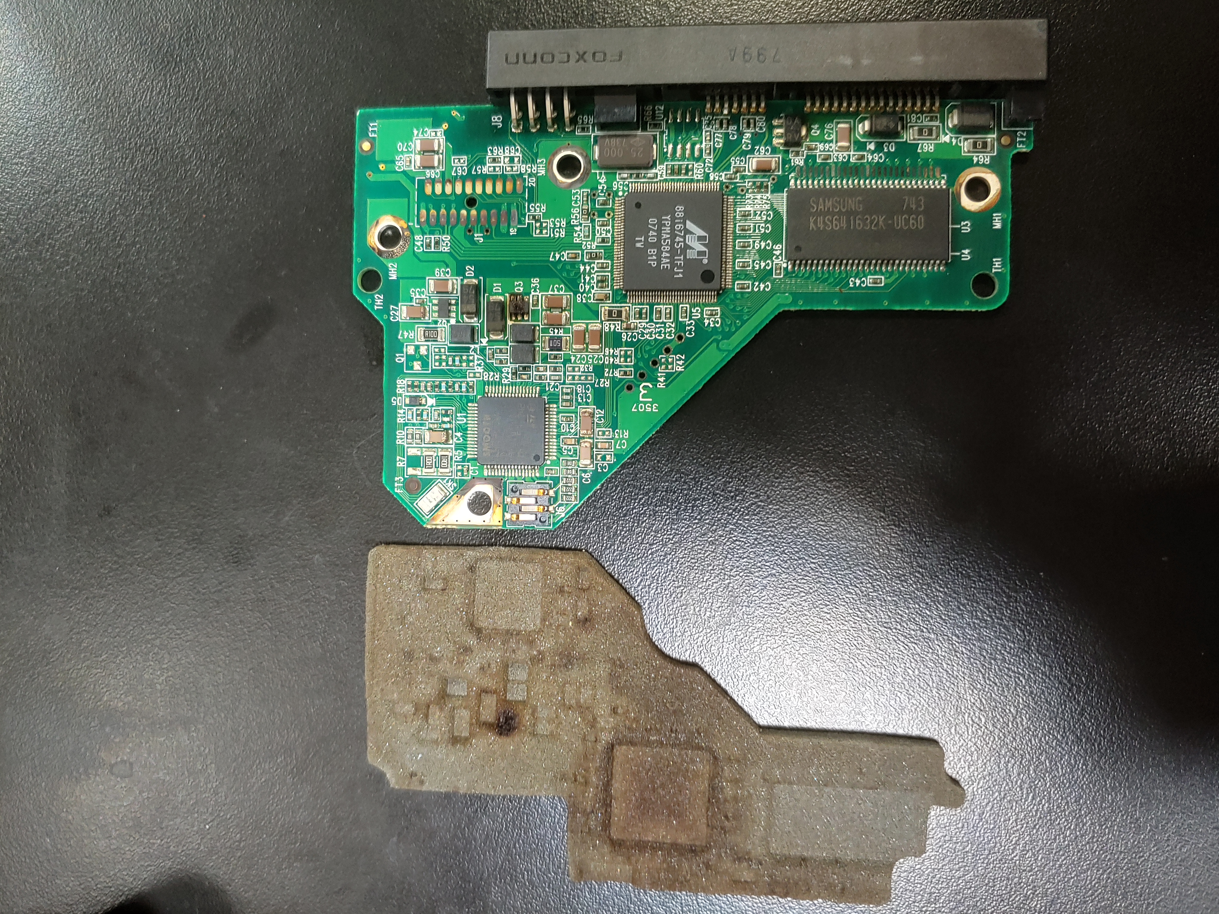

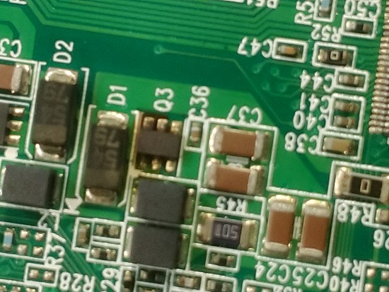

Tested board and found it to be getting power but cant get motor going, there is a bad component but I'm having trouble locating what exactly it is, its on q3 in the photos.
File comment: Close up of q3 after cleaning
File comment: Full board

I would recommend replacing the entire PCB and regenerate ROM from SA.

Part markings would help, but could it be something like this?
http://www.1688eric.com/upload/pdf/2012-7-23/IRF5800TR.pdf
Confirm that the resistance between the inductors and ground is not zero, otherwise there may be a problem with the load.

Markings on it are one of these (hard to tell) T-0, T-Q, I-0, I-Q
Bottom is illegible of it so hopefully that helps confirm what it is, and I will test it when I am infront of it again. Thank you for that and the information on if I need to replace board!
