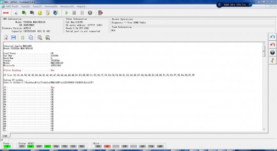

Is it possible to block head over ROM before heads reading data over platter
Toshiba MQUBD100
I have a very bad case.
4 head 2 platter.
Platters upper surfaces totaly starched.
Surfaces
0 good
1 bad
2 good
3 bad
Heads also gone very bad . Bended abnormal. Clients DIY disaster.
I swapped head. 1st try I guess MRT recognised disk after long wait. I could checked only g list was empty.. Plist couldn't open. Tried Head map on MRT DE. Not possible. And after short time drive again clicking. 2nd power on Clicking long time. My guess trying to add huge defect and drive clicking. Or heads gone again.
My question
Is it possible to block head 1 and 3 over rom. I imagine that to block that heads before heads reading /writing data on platters. Maybe a lil chance if it's possible
I killed 1st donor. Would kill 1 or 2 donors for that case.

You don't have any idea how the Toshiba drives work, do you? :D :D :D
To start the media firmware the drive has to read DD.bin and some other modules from surface 3.
Otherwise it runs the Flash firmware and the access to platters is blocked...
Some terminal commands could help in your case , but I doubt they are implemented in MRT or PC3K...

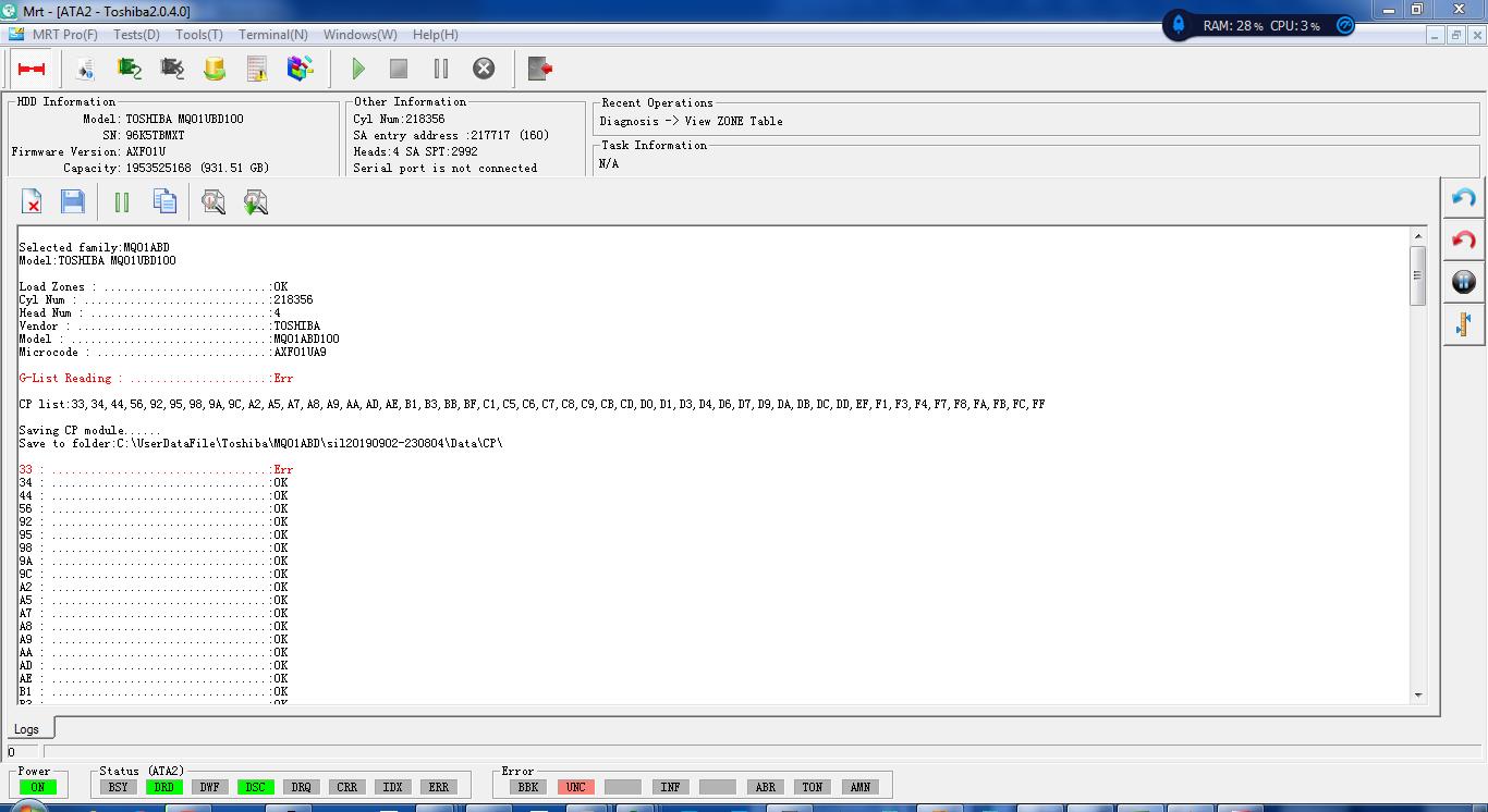

Yes I dont know much about DR and Toshiba drives. But;
I removed PCB from drive. And MRT recognised drive info and reading ROM and ROM modules. Showing head numbers . And Zone tables. Meaning, head map in ROM
MQABD Series like this. MK series not like this.
Selected family:MQ01ABD
Model:TOSHIBA MQ01UBD100
Load Zones : .........................:OK
Cyl Num : ............................:218356
Head Num : ...........................:4
Vendor : .............................:TOSHIBA
Model : ..............................:MQ01ABD100
Microcode : ..........................:AXF01UA9
G-List Reading : .....................:Err
CP list:33,34,44,56,92,95,98,9A,9C,A2,A5,A7,
This is Flaeh firmware. No access to platters. You need:
Microcode : ..........................:AX101UA9
Yes. Are you kidding?
Yes because I cannot access drive in that condition .
Yes I am trying to find to access data on platter.
Yes because I removed PCB from drive.
