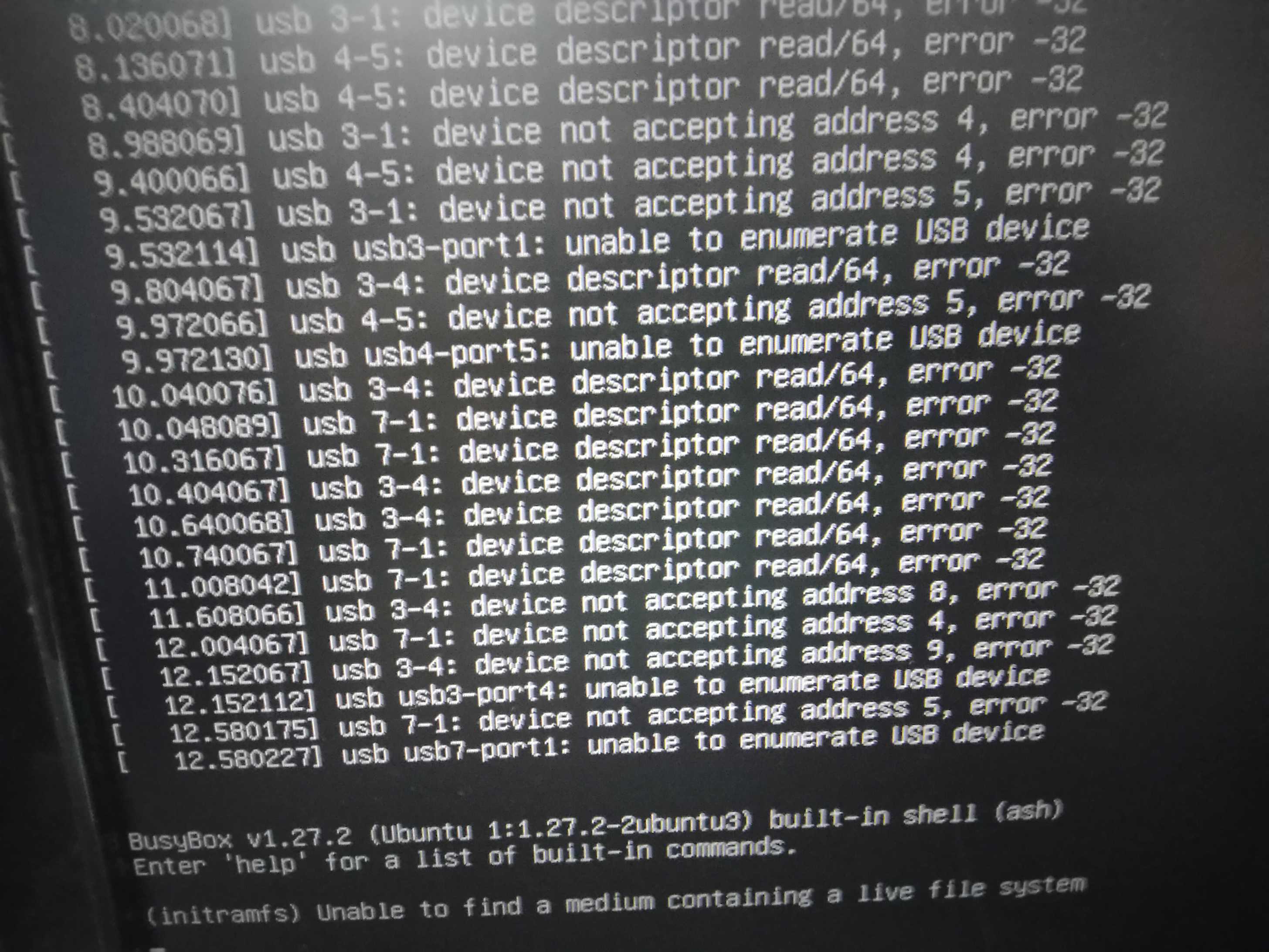

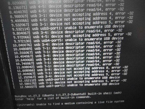

I am trying to clone a 16GB pen drive which is in failing state .It gets detected but cloning (Dos based ) stops after few MB. I tried reverse as well but it also stops after 700mb.
Strangely linux is supposed to be best os for such work. In this case hddsuperclone and ubuntu does not boot itself.
Linux or cloning software should ideally ignore file system and should not try to mount file system which may result in trouble like in windows.
Here I could clone using mere outdated dos but latest OS failed to do this task.
Maximus is there any updated build coming up to overcome this issue ? Will this issue get resolved in paid version ?
here is snapshot of errors.

With the log, can you not image until it goes stupid, Stop imaging, Remove and reconnect the flash drive, Restart imaging where you left off and repeat until you get a full image of the flash drive?
Yes, this will be very time consuming. But, that is the price you pay for free.

First and foremost, if the data is worth paying for, consult a data recovery professional that can deal with flash. I know you said you can’t afford the Pro version of HDDSuperClone, but what is it worth to the owner of the flash drive (the client)? If the data is important, then it should go to a pro. But if it is not worth spending much if any money, then maybe we could try some DIY. I will say that I am doubtful for any sort of good DIY recovery, given the circumstances.
From what I have read, I am assuming that when the drive is plugged into Linux, it locks up the system and is not readable. Normal Linux releases will still try to mount the drive, unless you have auto mounting turned off. The live CD version of HDDLive should have auto mounting turned off. But that may not be enough. Even with auto mounting turned off, Linux will still try to read some areas of the drive when connected. That could cause it to lock up.
I am looking for real case USB testing with the Pro version. If you are willing to try some things, and report exact steps and results, I may be willing to give a free short term license. But understand that I may not respond quickly, so it may take some time to work things out. If interested, PM me and we will discuss it further.

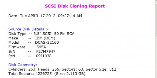

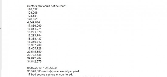

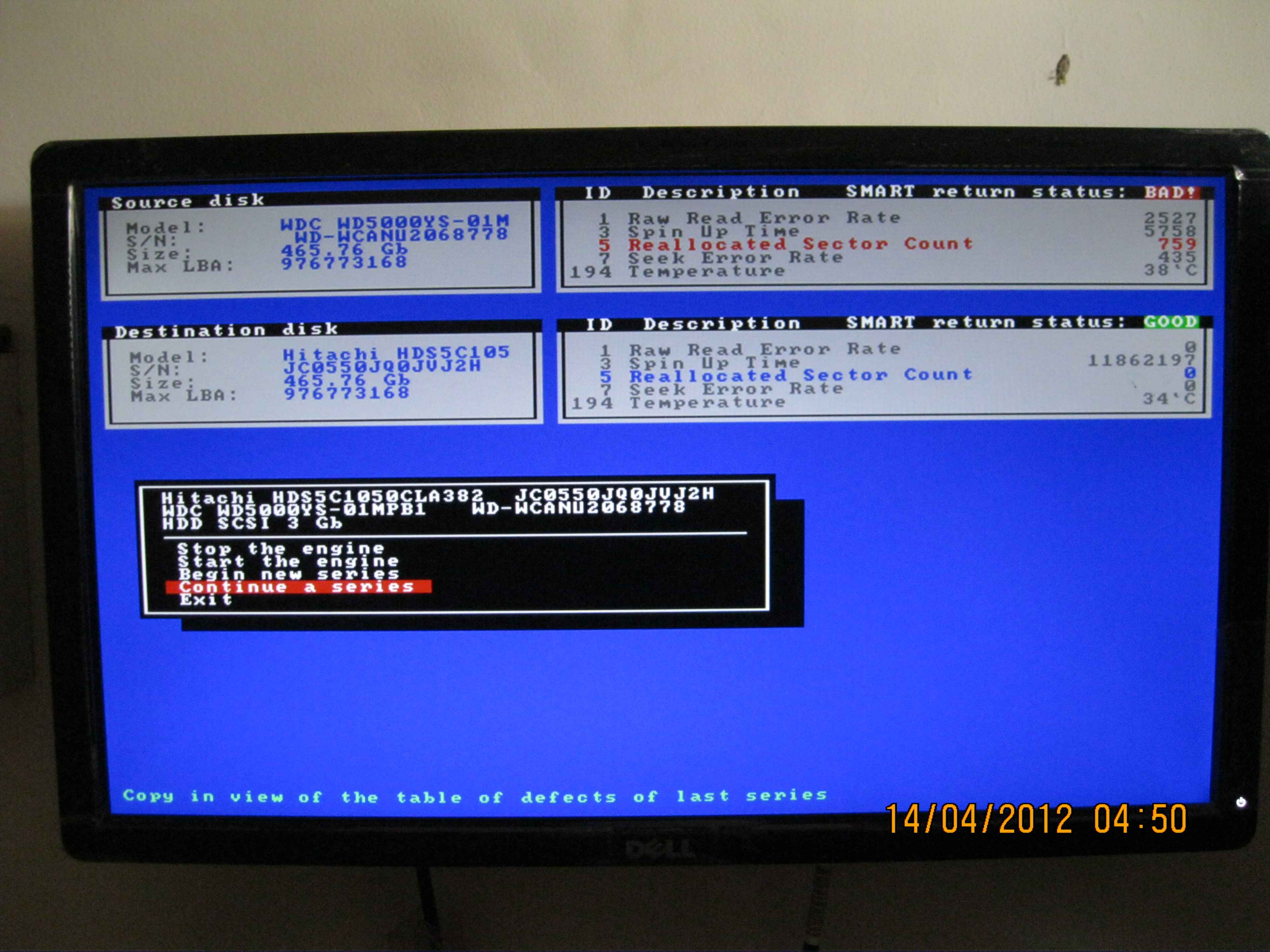

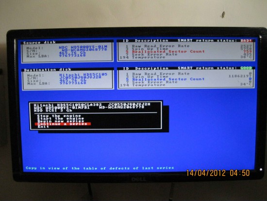

Thanks all for replies ,

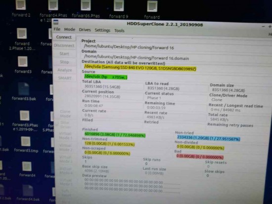

lcoughey I have already done that which is no more working, somehow cloning program should jump troubled sectors and continue cloning. Here we can try different jump sizes depending upon damaged area. .Being a data recovery professional I have done so many similar cases in the past with great success.
I own pro version of infamous and dead HD Duplicator as well (https://forum.hddguru.com/viewtopic.php ... 0&start=20) ,besides now outdated prosoft engineering media tools (this is from the era of floppies)
I have got success with dos based tools than even linux ( some of the forensic cloning tools modify dos not to mount /alter a byte )

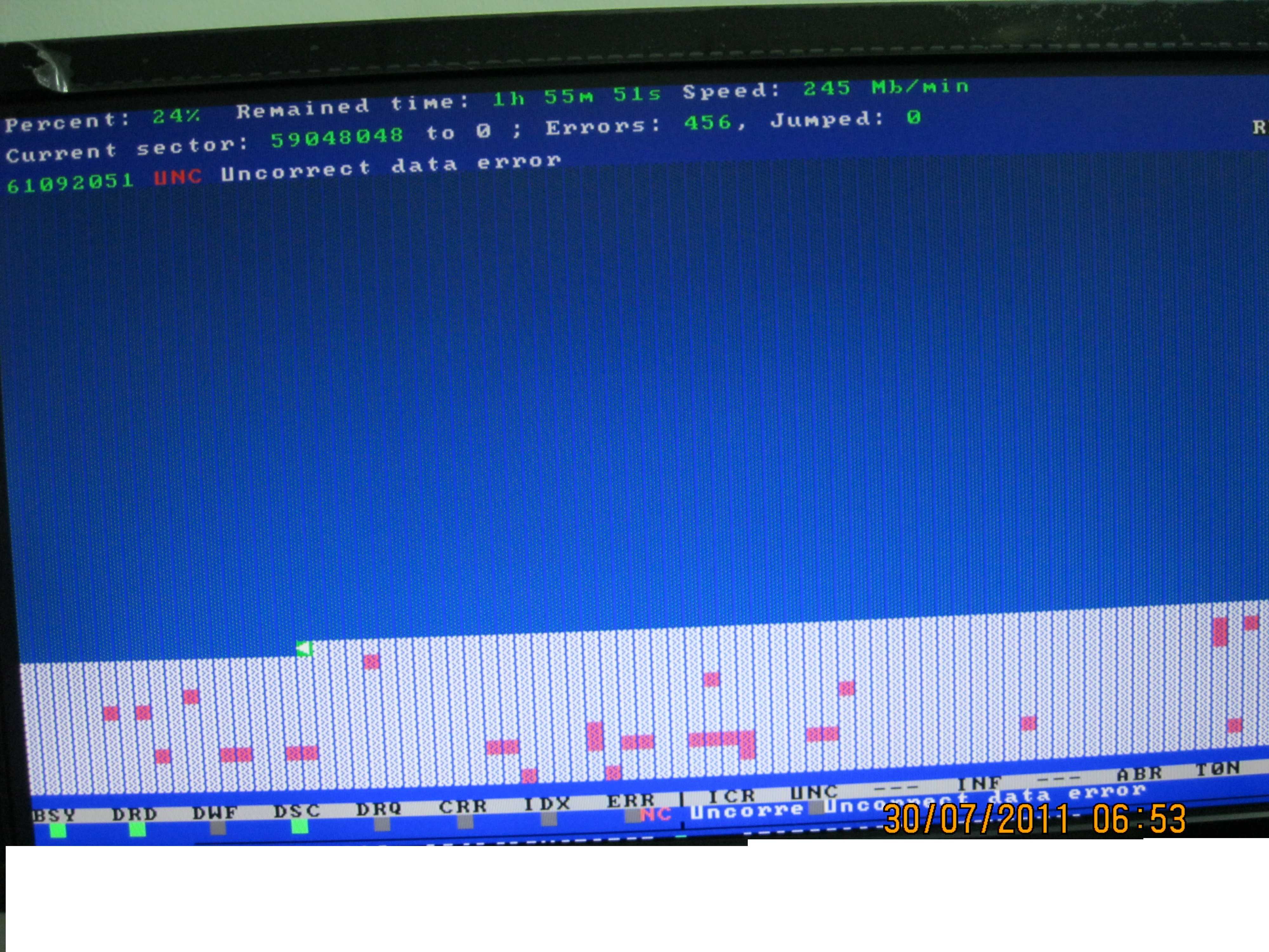

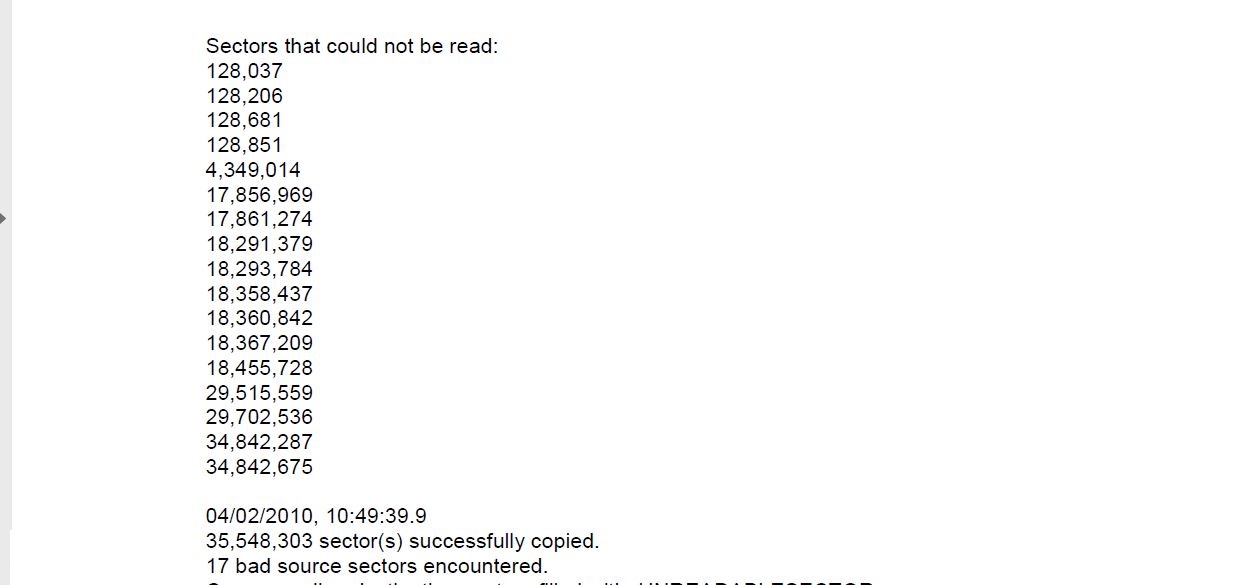

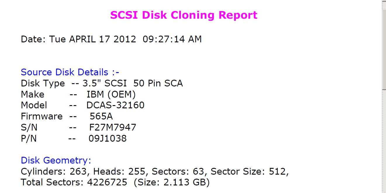

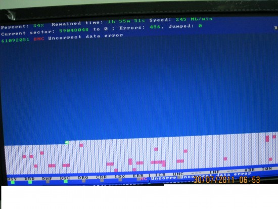

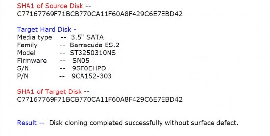

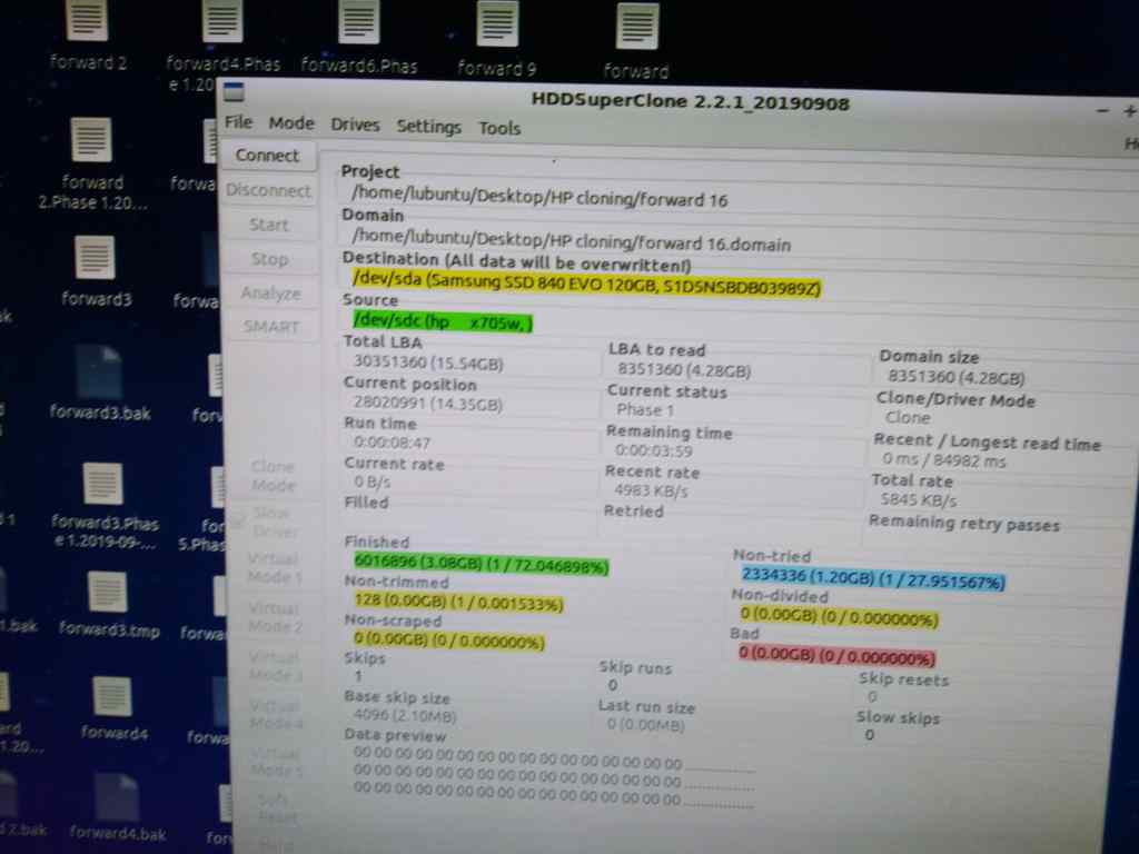

Thanks to maximus for making available pro licence of hddsuperclone.
I have completed cloning with flying colours .
In forward cloning I have cloned as much as possible sectors till 14.35GB , rest of the sectors I have done through reverse cloning.
To my surprise 16GB FAT32 was fully accessible with some missing folders. But recovering file system showed those as well.
Overall nearly 90% + Data recovered from failed pen drive without chip off.

I have a couple things to say on this. First, from the logs I have received, this recovery was done using the free version SCSI passthrough, so the Pro version is not relevant to this recovery at this time. I blame myself for not being more clear in communication. Second, it is becoming more and more clear to me that I really need to create some example style instructions. The user manual gives definitions of all the features and settings, but does not give instruction on how to use them.
