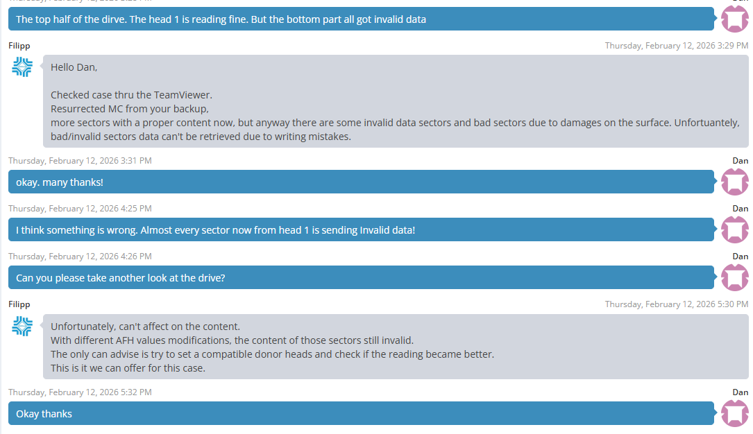

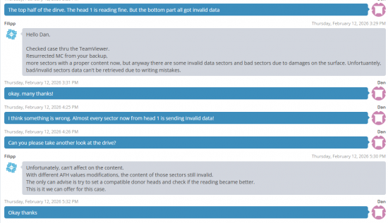

Have anyone found a solution for this after 5 years.
It is mainly on SMR Seagate (Rosewood) drives
Here is the answer form Acelabs TS
 Post subject: Re: ST2000LM007-1R8174 SBK2 Sectors Problem
PostPosted: February 13th, 2026, 5:49
Joined: November 3rd, 2023, 7:57
Posts: 53
The only solution I have found is to play with AFH values or a new set of heads, but even then some sectors still read the same so its not guaranteed. But new heads and AFH values have helped me to read more than I could with original settings and heads.
