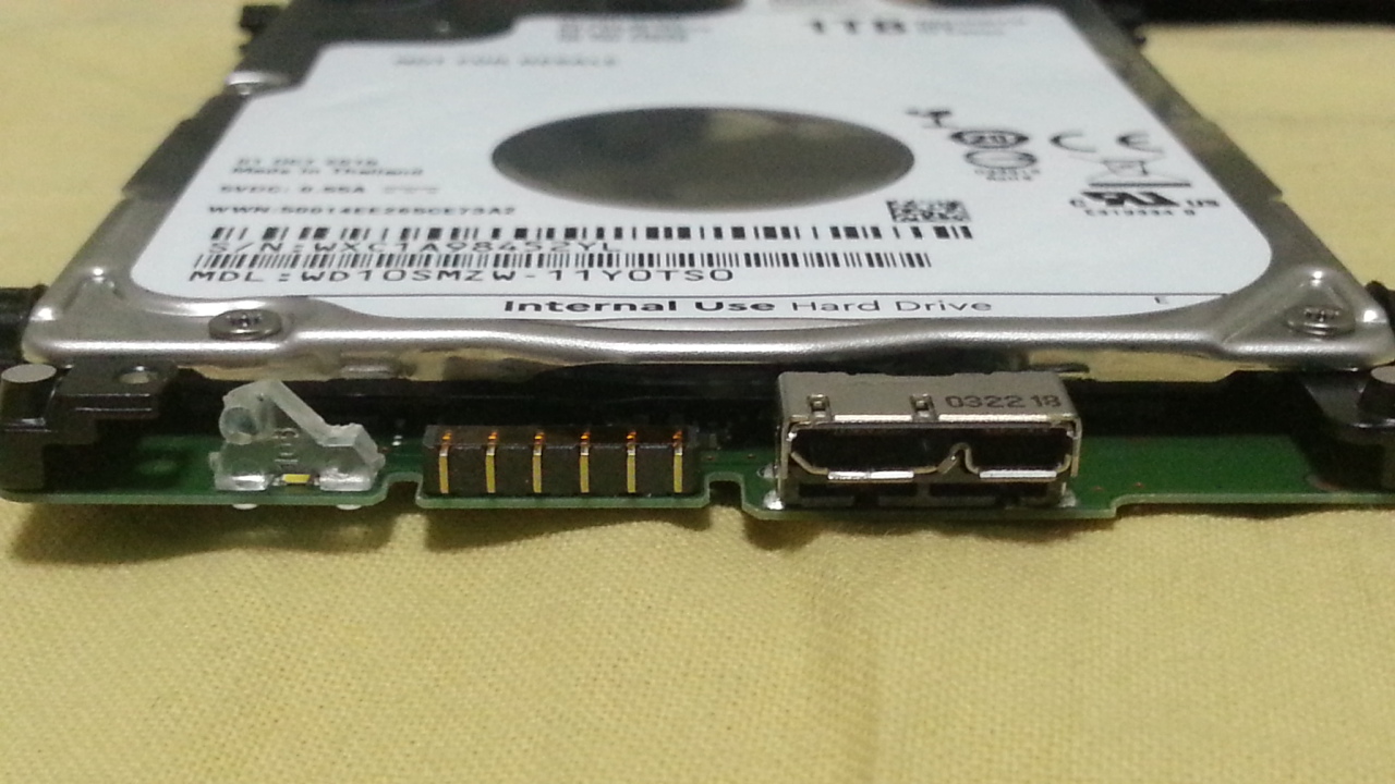

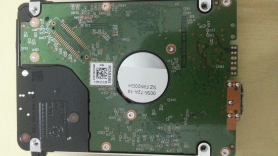

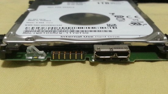

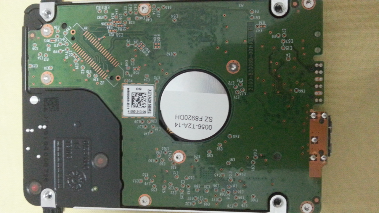

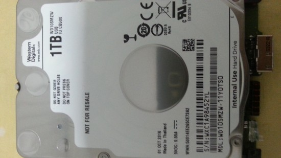

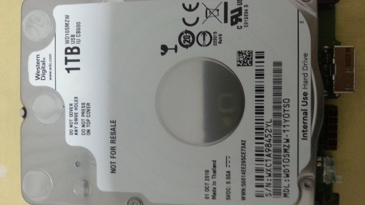

USB WD10SMZW 11Y0TS0
Usb PCB 2060 800069 001 Rev P1 No Com Connection pins
date: 01 Oct 2018

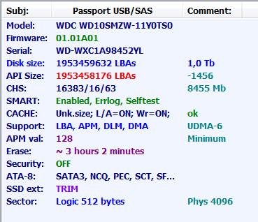

User saw erase Notice. Pressed ok, And Fast formatted drive. Total time under 2 min.
I Searched With RSturio, Only 17 file Total 300 Mb at Begginning part. Looked inside drive with hex editor. Fully 0 except that 300 MB. User told There was 80 GB data before .
How Could It Be Full 0 within that short time? . Is it about drive architecture so allow that very quickly? That is a new drive , more unknown things ://
And What is compatible SATA PCB, any ideas?

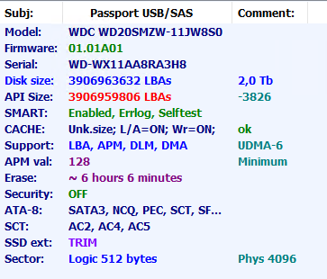

Try it on a new Palmer or Charger drive, you will get the same result.
Deleted is deleted. Also if you check these drives will report they support "TRIM"
File comment: Charger TRIM
I saw it in properties TRIM at Rstudio.
So No change to recover with known information about this drives ?

labtech wrote:
Yesterday, I purposely filled in a healthy external drive with this model. I purposely selected a different pattern other than 00s.
I used 99s.
After filling in, I disconnected the drive, reconnected it, initialize it and created one NTFS volume.
All empty space now reports with 00s (not 99s).
Interesting. I guess that proves the theory is correct. Thanks for sharing.

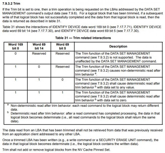

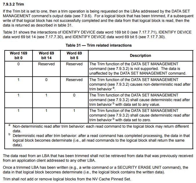

ISTM that one could determine a drive's TRIM support and subsequent read behaviour by examining Identify Device words 69 and 169.
IDENTIFY_DEVICE_DATA structure contains the data retrieved by an ATA identify device data command (0xEC):
https://docs.microsoft.com/en-us/windows-hardware/drivers/ddi/content/ata/ns-ata-_identify_device_data
USHORT ReadZeroAfterTrimSupported : 1;
USHORT DeterministicReadAfterTrimSupported : 1;
ATA/ATAPI Command Set - 2 (ACS-2):
http://www.t13.org/documents/UploadedDocuments/docs2011/d2015r7-ATAATAPI_Command_Set_-_2_ACS-2.pdf
The reasons for the desirability of deterministic read behaviour after TRIM are explained in the following article which raises several security concerns:
TRIM: Behavior of Subsequent READs:
http://www.t10.org/ftp/t10/document.08/08-347r1.pdf
